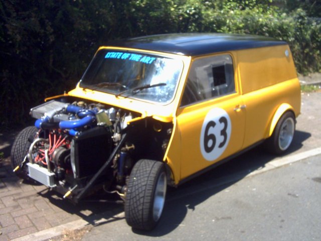

Escort RS turbo intercooler, i have a fibre glass removable clubman flip front. well handy to work on her like this
Edited by 1976 clubamn, 20 November 2006 - 04:20 AM.
Looks nice :-
What did u spray your rocker cover with. ?

Posted 20 November 2006 - 01:43 PM
sprayed the cover with tahiti blue 93 normal car spray paint, then a shed load of lacquer. started to crack now though

Posted 20 November 2006 - 06:51 PM
your rads moved hasnt it? and electronic fan? does look good tho does the outlet side of the intercooler go under the oilcooler and ever more cramped than usual!

Posted 20 November 2006 - 06:58 PM
yep, shifted the rad a couple of inches to the front so the fan cleared the water pump enough. and yeah the out from the IC goes under the oil cooler and back around to the plenim. even with the clubby flip its still well cramped in there. very difficult to get everything to fit nicely.

Posted 23 November 2006 - 07:38 PM
i noticed the rad was far away from the head and the 2 hoses cliped together!
you could lose a bend or two with a ally plenum that nic makes over on.

Posted 23 November 2006 - 11:06 PM
yeah,i need to sort out some ally pipes. samco was the easy option at the time of build

Posted 28 November 2006 - 08:38 PM
May be a silly question, but why did you stick with the side rad, rather than go for a front rad???
