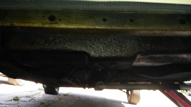

these pics were taken quickly in my lunch break on my phone
I know they aren't the best , but they give an indication whats involved in fitting a Imp tank
the tank is solidly mounted in the subframe with spacers at the front , lowering the tank's position to sit beneath the rear seat
the floor is removed where the battery & spare wheel sits , with about 1/4 of the rear section of the tyre well left
and is closed off from the underside and made into a tool tray
the back is heavily reinforced around the rear subframe mounts (3mm plate I had at the time & box / angle )
also the filler pipe has quite a lot of protection from a rear end crash
I used to make lorry's so went over the top with materials as I had them available
This conversion won't be for everyone's taste , but IMHO is safer than the normal position
the tank is no where near the road surface and is well clear of any speed bumps
a vent should be also fitted , both on the filler neck , and in the tank , it should go to a high point then vent to a low point -
to prevent any spillage in the event of a roll over
the above is only a demonstration of how I installed an Imp tank , in my classic mini convertible -
and is in no way guaranteed to work in a normal mini , and is not a quick plug & play fitAttached File  20220812_120702.jpg   100.71K   1 downloadsAttached File  20220812_120715.jpg   144.11K   0 downloadsAttached File  20220812_120723.jpg   31.03K   1 downloadsAttached File  20220812_120727.jpg   41.17K   3 downloadsAttached File  20220812_120852.jpg   35.95K   2 downloadsAttached File  20220812_120858.jpg   133.17K   3 downloadsAttached File  20220812_120957.jpg   135.52K   1 downloadsAttached File  20220812_121409.jpg   33.22K   1 downloadsAttached File  20220812_121413.jpg   36.21K   0 downloadsAttached File  20220812_121235.jpg   67.27K   0 downloadsAttached File  20220812_121124.jpg   33.21K   0 downloads

That answers many questions.
One question that I have: where did the exhaust go? (I only see one photo with the middle small box under the tunnel and then the exhaust pipe runnen underneath the subframe outer "leg". Non of the other photos show the exhaust system. Do you run a back box, and where/how did you locate it. Or did I miss this in the photos?)
Edited by Johnmar, 19 August 2022 - 06:23 AM.
#63 sledgehammer
sledgehammer
  • 3,109 posts
  • Location: I'm sittin here besides my self
Posted 19 August 2022 - 08:43 PM
it's side exit , in front of o/s/r wheel , approx a foot in front of the subframe
and at the moment , it's a bit loud , it's got a std single box , so now I'm figuring a way to fit a back box
going to have to be a shallow one for clearance
