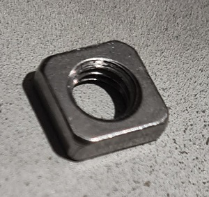

it'll need a skim of filler but I've left that one there for now as it needs a quick weld, one of the captive nuts for the window mech came out
as you can see I worked out the thread size, I didn't have that in imperial but I did have an M6 one
which tapped out quite easily to 1/4" and seems to thread onto the original bolt(screw?) nice and snugly, it also fits in that square hole perfectly, so I'll weld that in tomorrow
later I'll put a normal hex 1/4" nut on the back and tack that on as well I think, that way I have the right square look on the outside and a good strong fixing behind it
