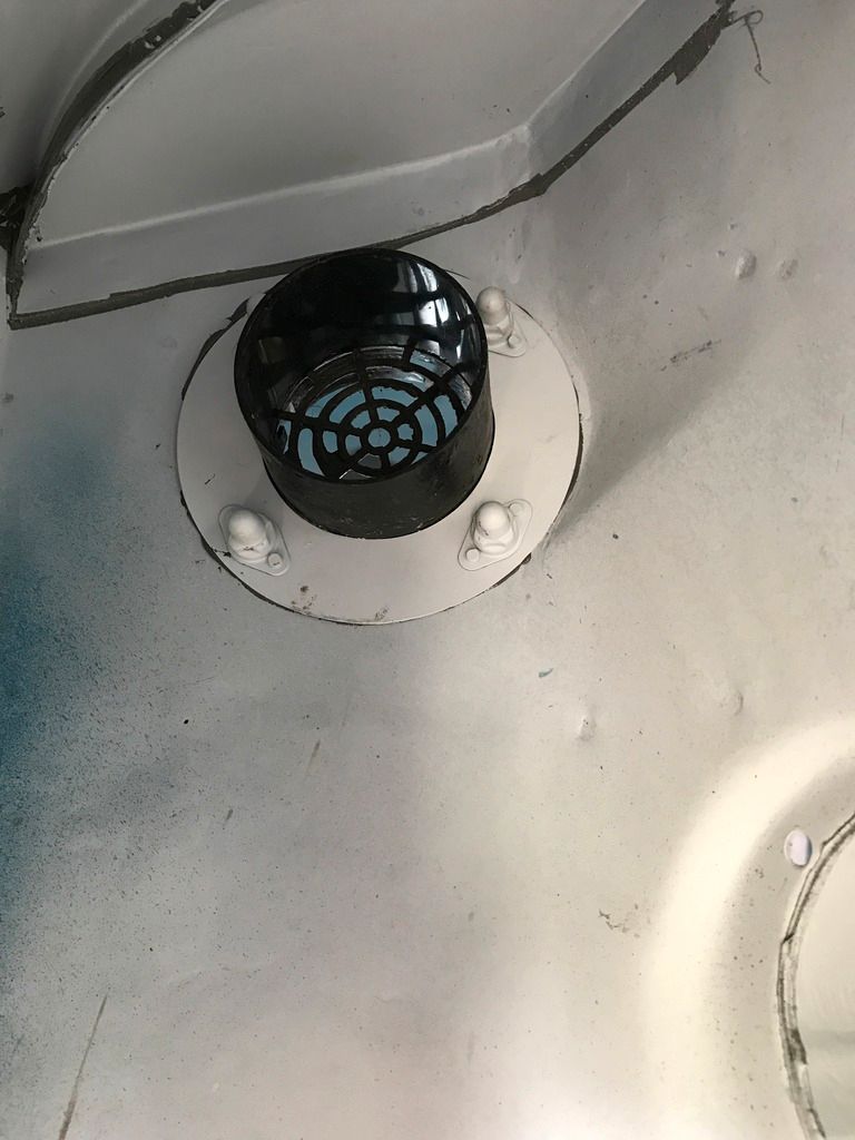

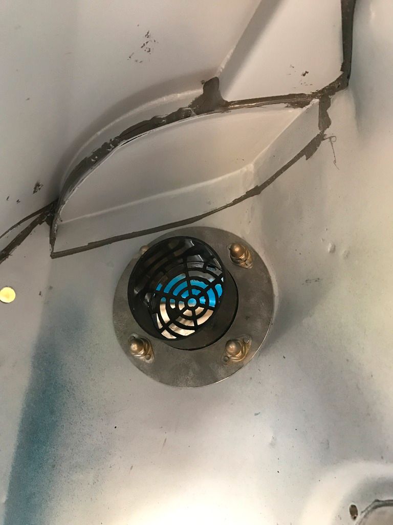

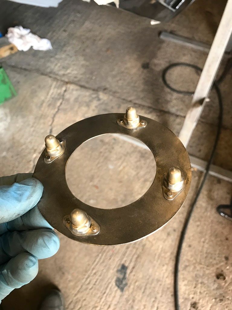

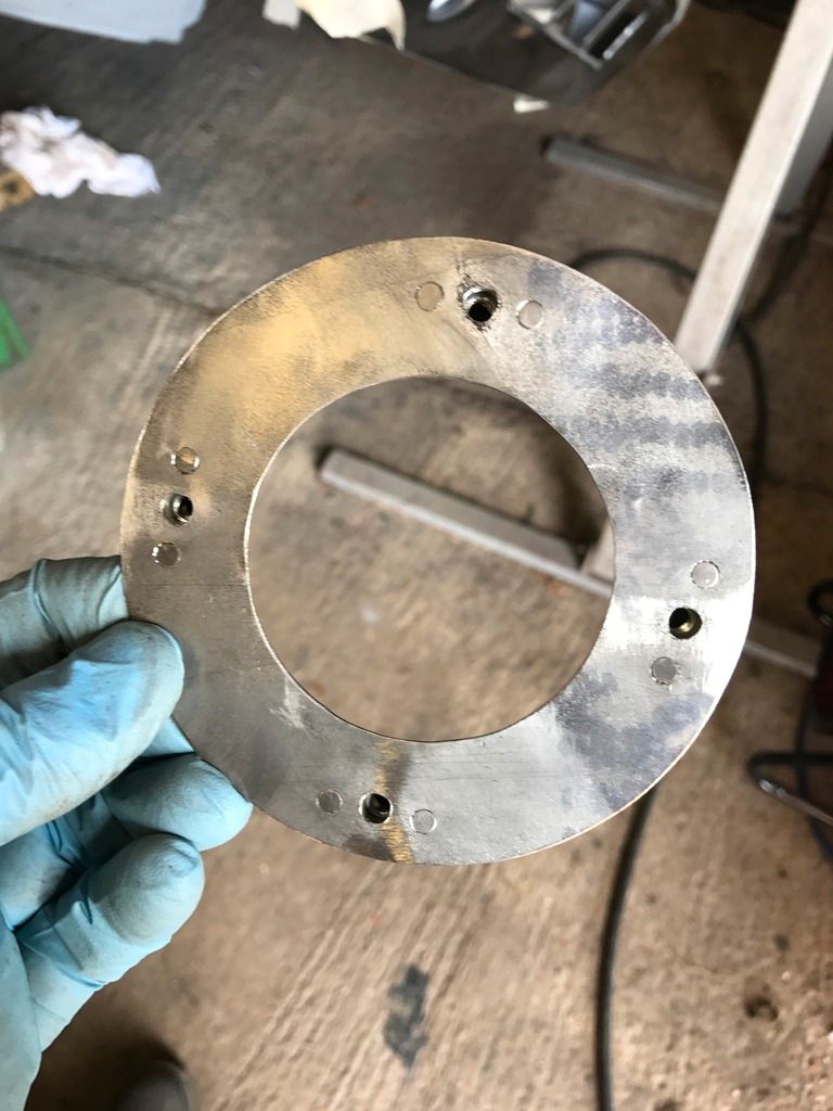

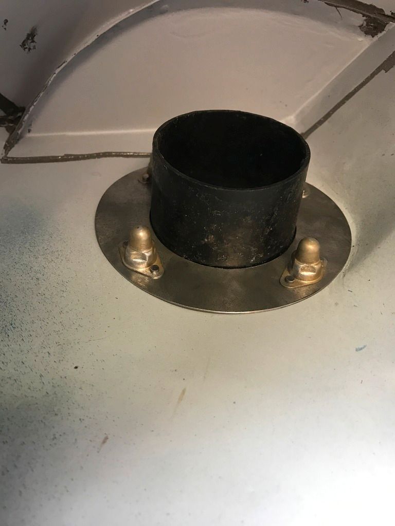

Me being me did something different for those especially after replacing most of the metal fro fresh.
I made a stainless steel ring with four sealed captive anchor nuts riveted on then the whole thing boded in place.
60a35e3045db4e680be49a2e6ddcd237ecfed106
329b26d3d2ef84287207ed1ba60949c7a6ce6bc5
df980ce5a081b84e0b461c4f209ef6c934b9d90b
37e625fef608ea25ae13ba9adea8d8af22d56905
Bonded in place
c785b31bb5c93ae58e08f357c24df3b6bfb30bc9
I made a stainless steel ring with four sealed captive anchor nuts riveted on then the whole thing bonded in place.
A great job.
Am I right in assuming that the large hole for the spigot is the same as original?
Also, I like you rivets, a proper job and essential to the design -  form being function, where function is top notch.
I suspect those captive anchor nuts are superior to rivnuts. And I like the way its all on one removable plate rather than the captive nuts direct onto the body. Perfect for any necessary future front end work,  even if its in thirty years time.
Did you do that because the pate is thicker than the bulkhead, so as to take the rivets? Or simply to make it a removable one piece plate, as being better by design?
I must steal the idea.   :goaway: Maybe I could  weld the captive nuts onto the plate, (Answer: in that case simply use ordinary nuts , gosh I'm so stupid at times).

The stainless steel sheet was some leftovers I had floating around. The countersinking did not knife edge the thickness of the stainless. The sealed anchor nuts were for a Aircraft fuel tank access panel, the Monel rivets are again something we use for stainless steel to prevent galvanic corrosion / dissimilar metal corrosion.
And yes ultimately I can remove the ring at a later date is required. It is sealed on but a decent thin scraper will easily remove it if require. I would be very hacked off if anything there started corroding again. A lot of prep work went into that area.
As for the anchor nuts being more superior to rivnuts?? A properly installed rivnut should be as good but because I have used a sealed anchor nut plus when I fit the bolts a little bit of lube will be used, there should be no chance of any muck getting in there.
The internal diameter aperture is the same as the original
