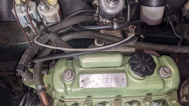

Thanks Spider, that’s interesting. I thought it was a bit of a mishmash having the rocker cover and crankcase breather, and also having the vented oil filler cap.
Current setup:
Current setup:
It does look like that rocker cover was specifically made for that setup, having an oil trap set into it.  Still not sure I would mess with it, though I can see spider's point about drawing air through as much of the engine as possible.
Current setup:
Yeah, that's not really going to work too well !
Fresh air in via the filler cap and then routed off via the rocker cover.
The Rocker Cover is off a Mini K.

Posted 23 August 2022 - 09:43 AM
So in the aim of looking clean and neat, I’m thinking I should change out the rocker cover for one that takes the vented cap, but no breather?
All stock Rocker Covers will take the Vented or Sealed Caps.
For a neat install, yes, I'd suggest a 'blank' rocker cover, which was in fact what these engines had from the factory.
