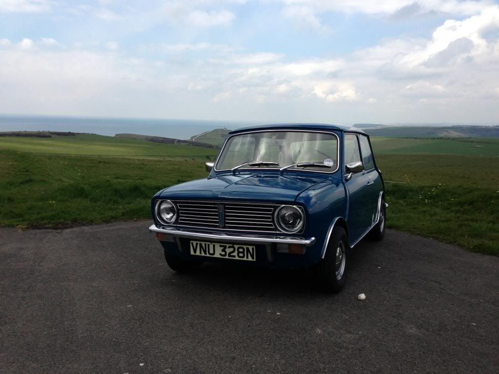

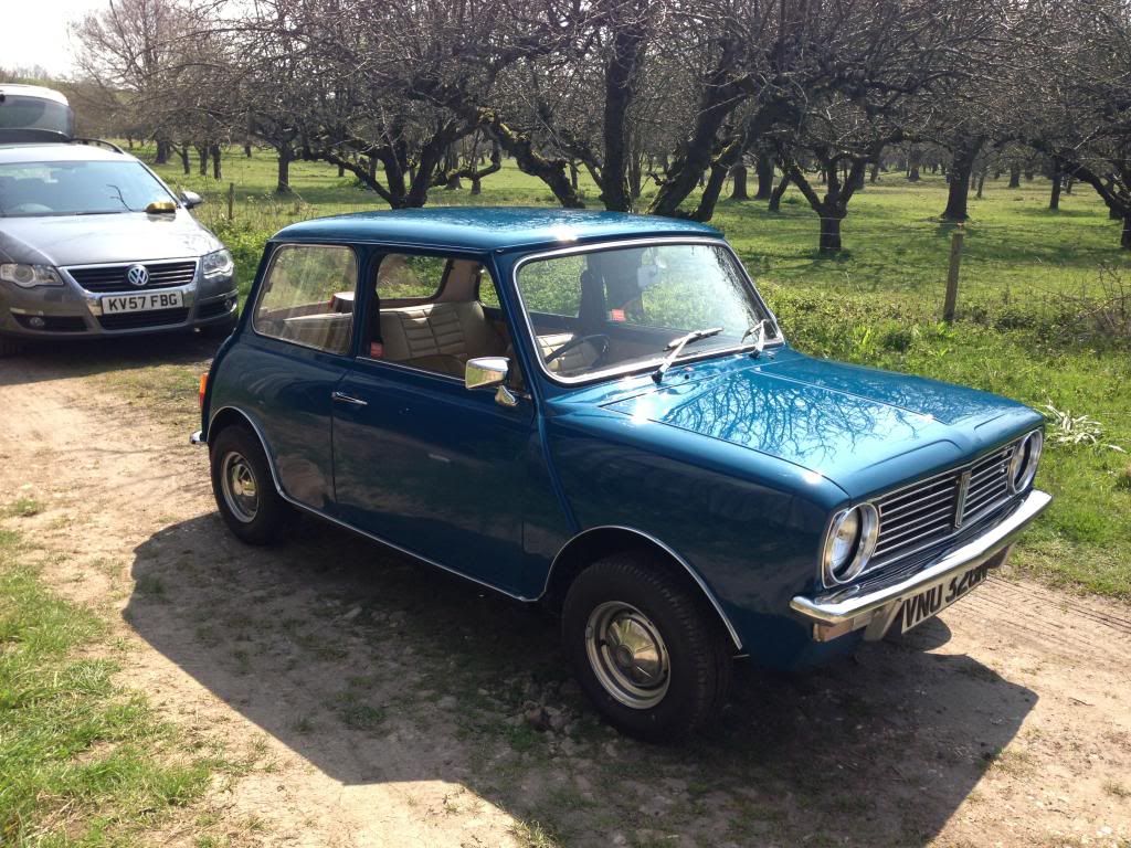

Paddy just after i fitted the 7.5" Cooper S disc conversion plus new cones and shocks
42cda38c141d95112265f152495c93fb5657c769
380bfe1dc858a5a2379d074df5d6201394f738ed
And the suspension a little more settled
703fc5674651ff4fd840e93e286b92bf6effcaef
So 4.5" Cooper S rims with 165 Yoko's.
Now the only issue is the rears. Now this was before i fitted spacered drums so in these pictures i fitted additional spacers to the non spacered drums. At the height in the picture no issues at all but once it settled and hard cornering the rears would rub slightly on the quarters. Normal cornering no problem at all. A quick tweak on the hi lo's would easily sort that out.
I’m guessing if it was fitted with 145s they wouldn’t have rubbed without having to raise the ride height?
