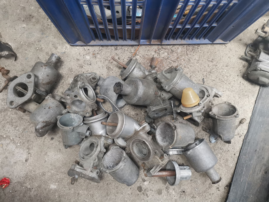

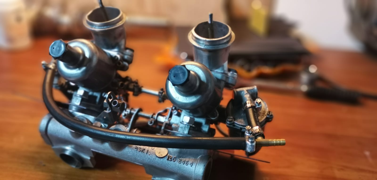

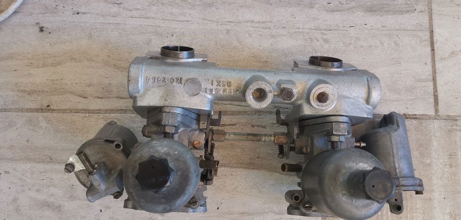

The original plan was to use a downdraft 36dcd weber because I had one and compared to the HS4 and HS6 that I also have, the Weber seemed the better option.
But since the GTS engine I bought came with the original standard twin HS2 inlet manifold, I decided it keep it standard and found most of the remaining parts needed for the twins. It needed some linkages and a rebuild kit so I assembled it as far as I could with what I had and then sent to the guys who know best when it comes to mini engines, carbs and everything else mechanical. They rebuilt it with a new jets, butterflies, shafts and gaskets, ready to bolt on for final tuning.
This is what I managed to dig out my spares buckets:
Pile of carbs:
This was how far I was able to assemble it:
And this is what I got back:
I haven't quite decided on what air filter to use but I do have the standard twin SU airbox. I'd be keen to hear what others have gone with.

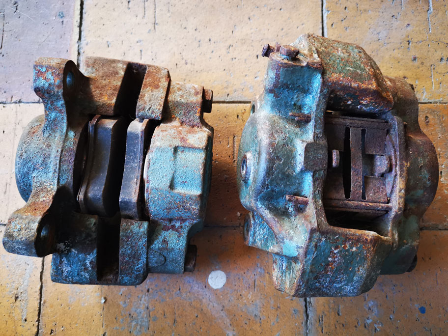

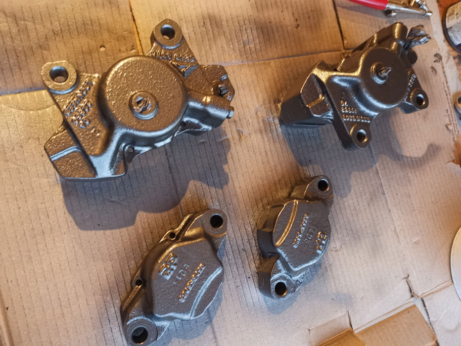

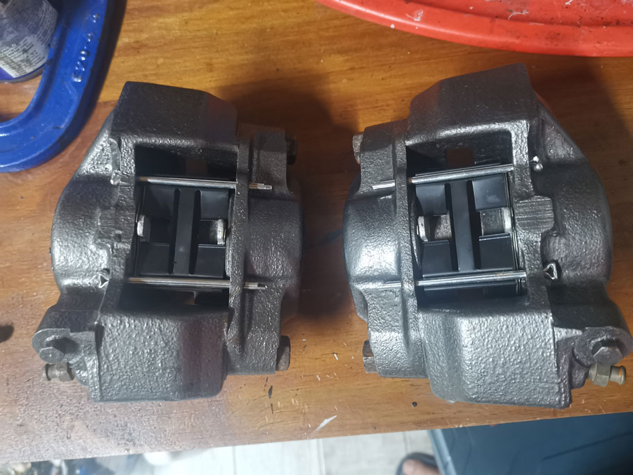

This being a later model GTS, it came standard with the 12inch wheels and 8.4inch disk brake setup in front and the spacered drums in the rear. I did a refurb of the calipers, had the disks and rear drums skimmed and cleaned it all up.
Brake calipers before:
Brake Calipers after:
I mixed this colour using black and silver hammerite

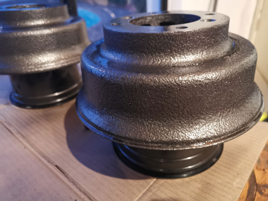

And the drums:

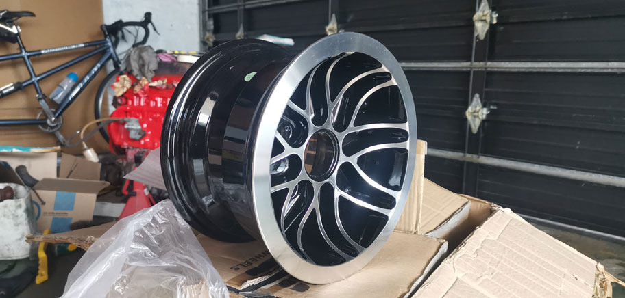

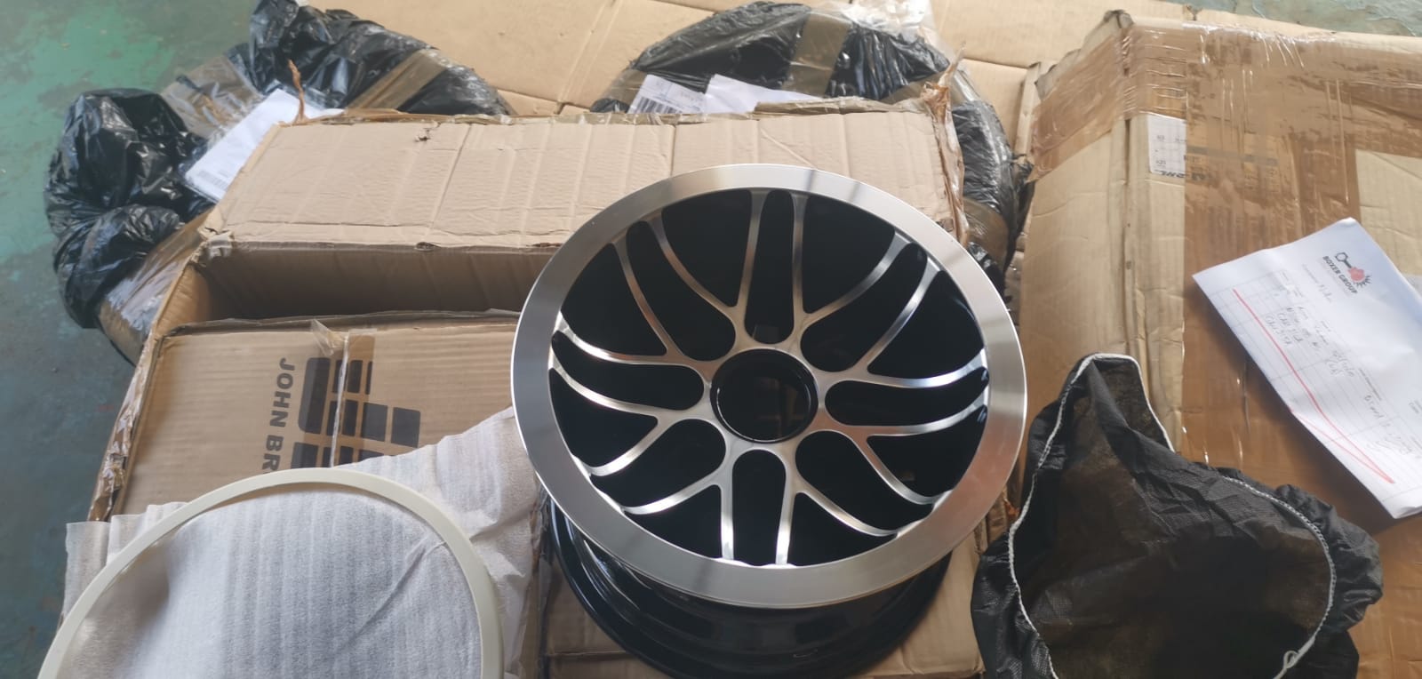

After all this work, I decided that I'll rather get 10inch wheels because the tyres are easier to find than 12inch and I really like the look of 10s. So I ordered the minispares brake conversion kit and a set of Cosmic 10 inch wheels with some yoko A008 tyres.
I really like these rims:
Edited by miniGTS, 22 December 2025 - 10:52 AM.

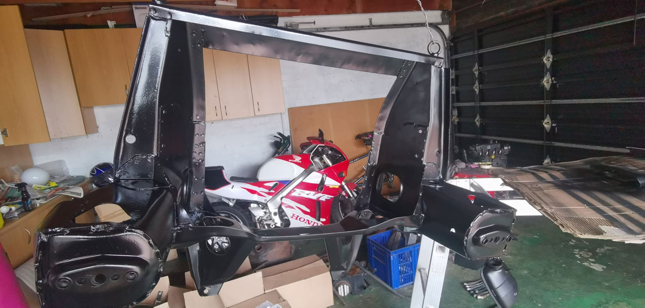

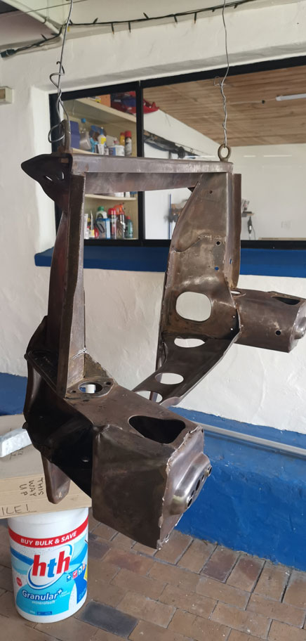

I did some spraying over the weekend. I plan on rebuilding the front suspension soon so I cleaned it up and sprayed it with black hammerite:
Front subframe before:
After:
I'll rebuild this with new poly bushes in the steady bars, evo rubber cones, HiLos and new rubber bushes for the lower arms, the adjustable tie bar rods heavy duty kit, new bumpstops and knuckle joints.
Edited by miniGTS, 22 December 2025 - 10:54 AM.
#15 DeadSquare
DeadSquare
  • 3,382 posts
  • Location: Herefordshire
  • Local Club: Unipower GT Owners Club
Posted 01 May 2023 - 03:46 PM
In the 60s, the competition department at Abingdon had some Nylon bushes made for the "steady bars".
Although the works and other drivers tried them, to the best of my knowledge, none of them ever used hard nylon bushes in competitions.
