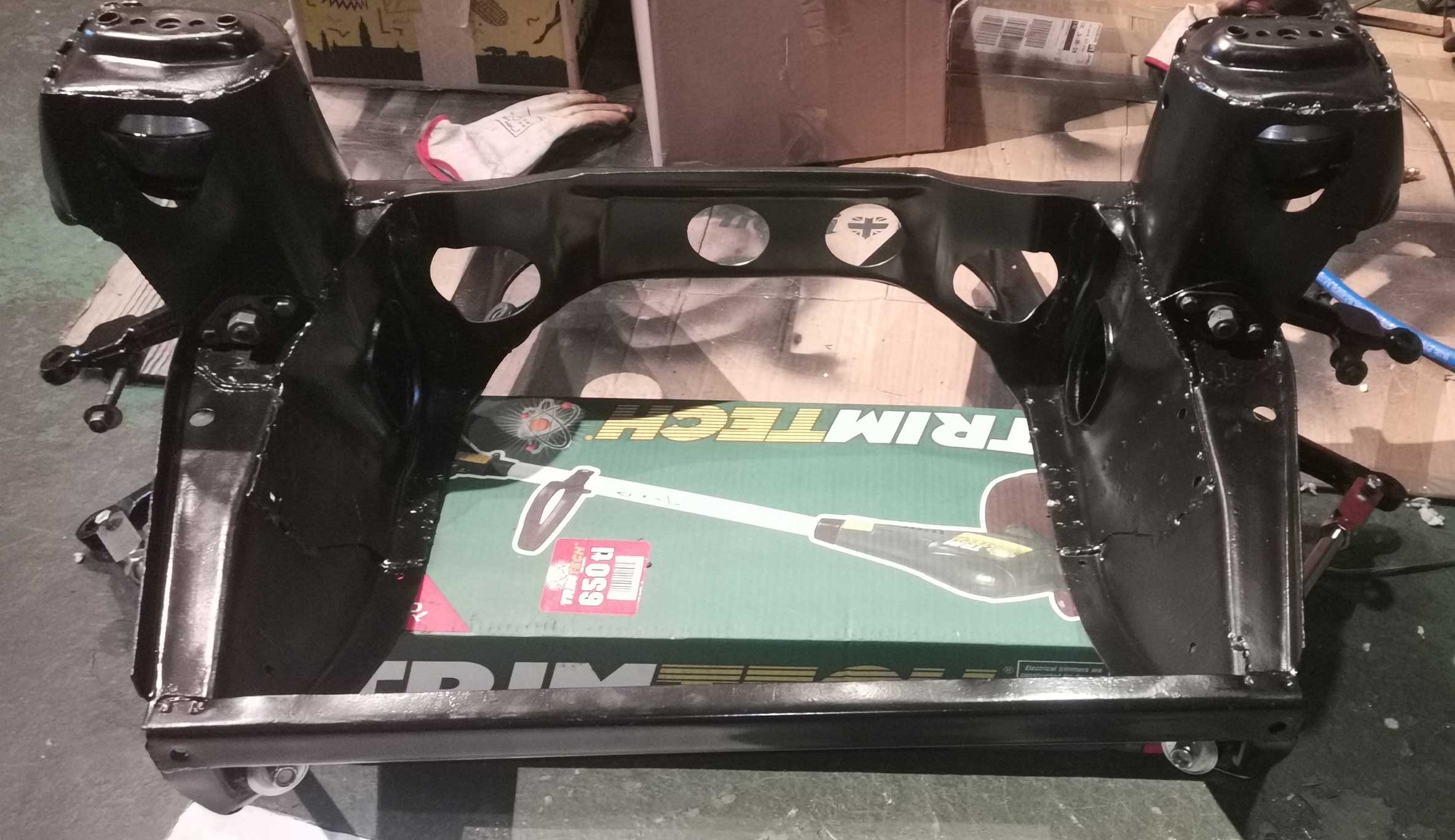

It's been a while since I posted about the progress... it's been slow but getting there.

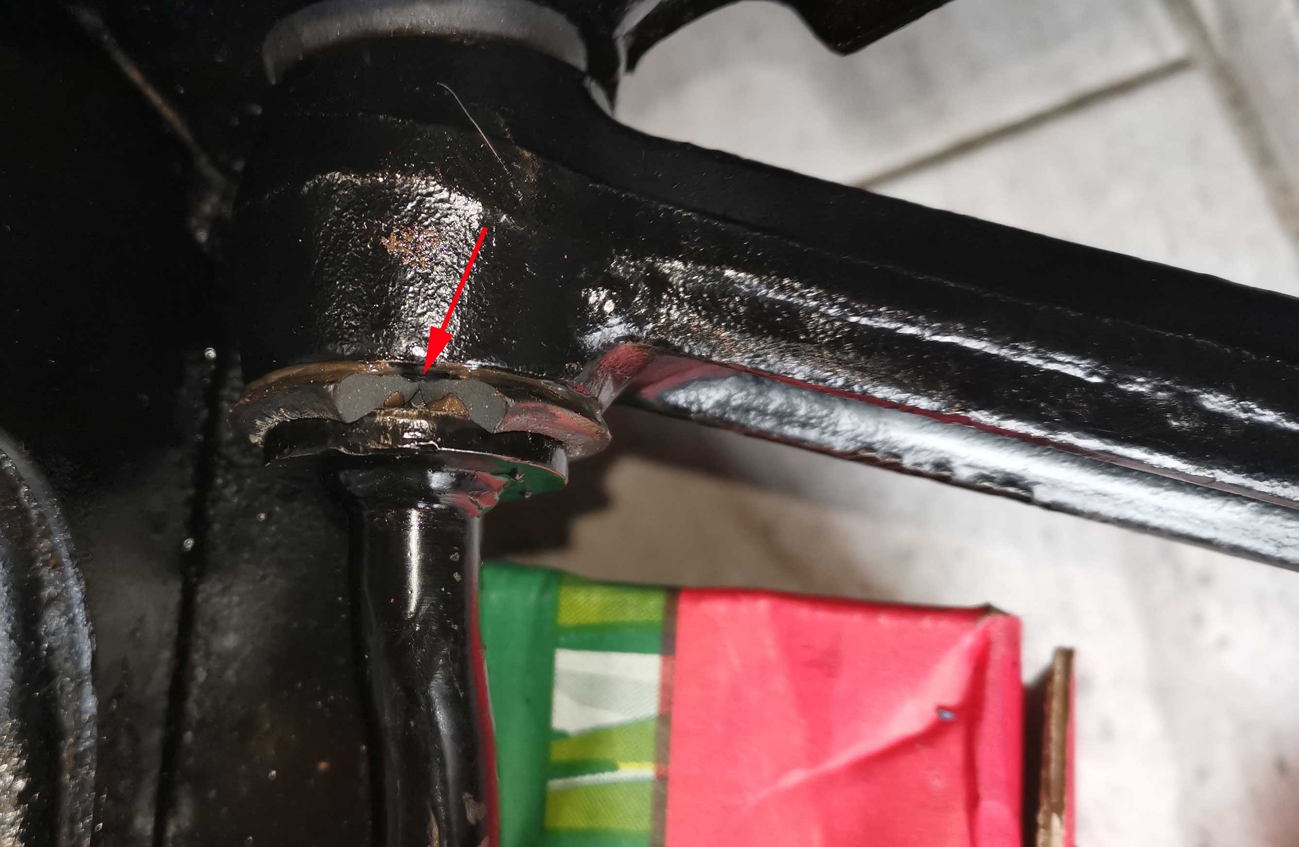

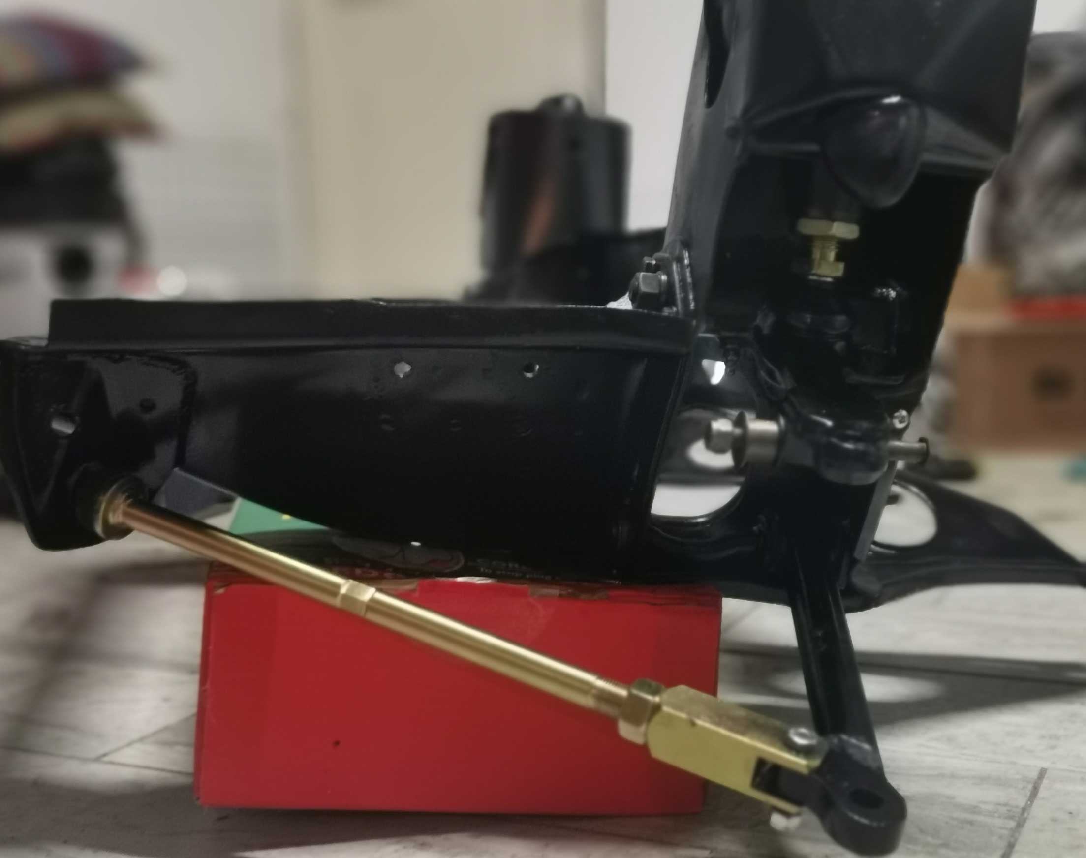

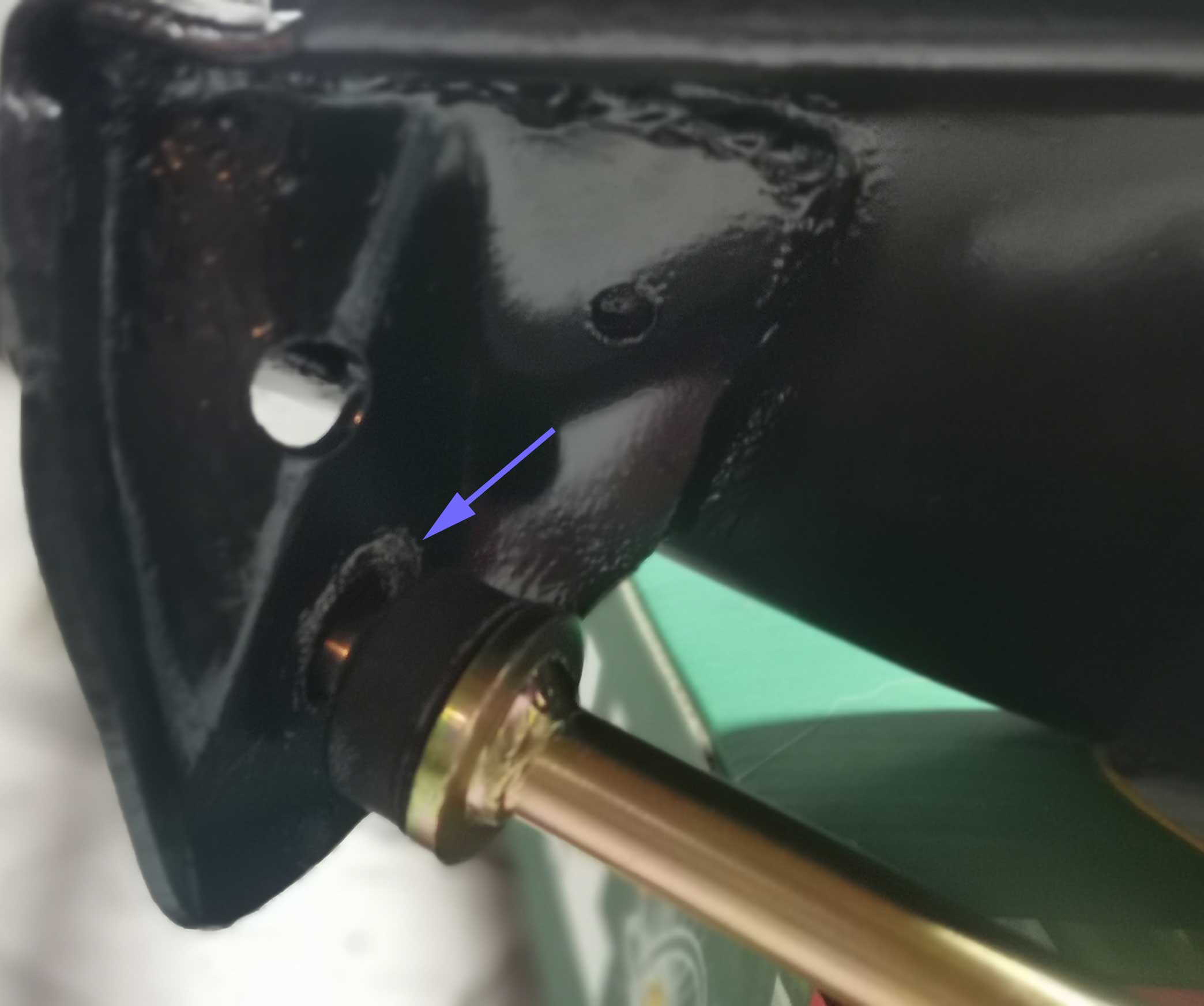

I started with the front subframe rebuild. I sprayed the subframe and upper and lower arms with black hammerite and fitted new MS Evo rubber cones, Hi-Lo trumpets, new knuckle joints, rebuilt the upper arms, replaced the lower arm bushes (which split when I tightened it up - very disappointing), heavy duty adjustable tie bar rods and new bushes.
Some pics of progress:
Before fitting I adjusted the tie rod bars to the same length as the standard ones and ended up with that space before tightening it up. Is that normal?
The split/cracked lower arm bushes:

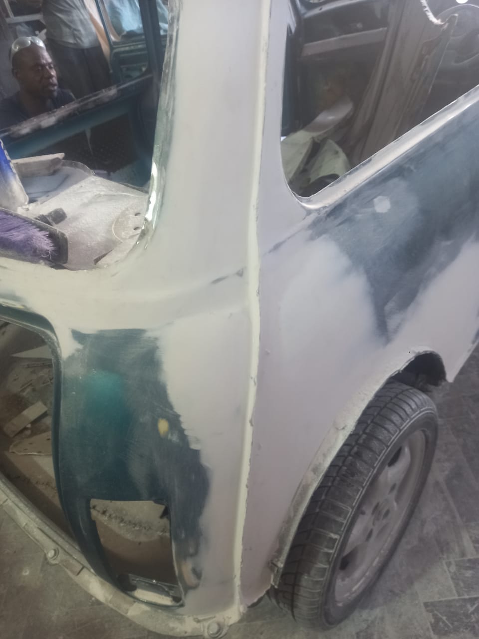

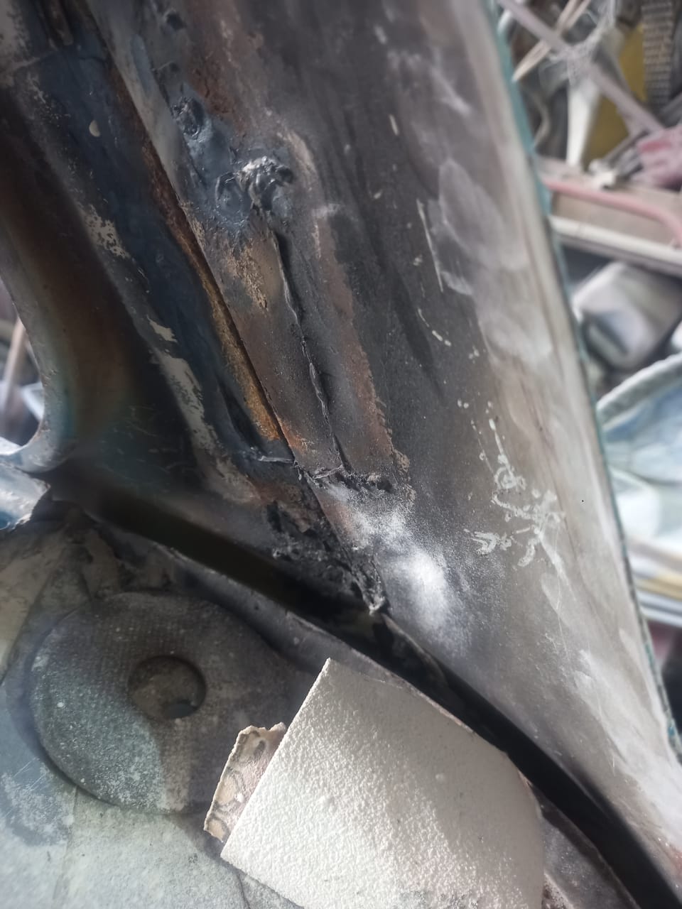

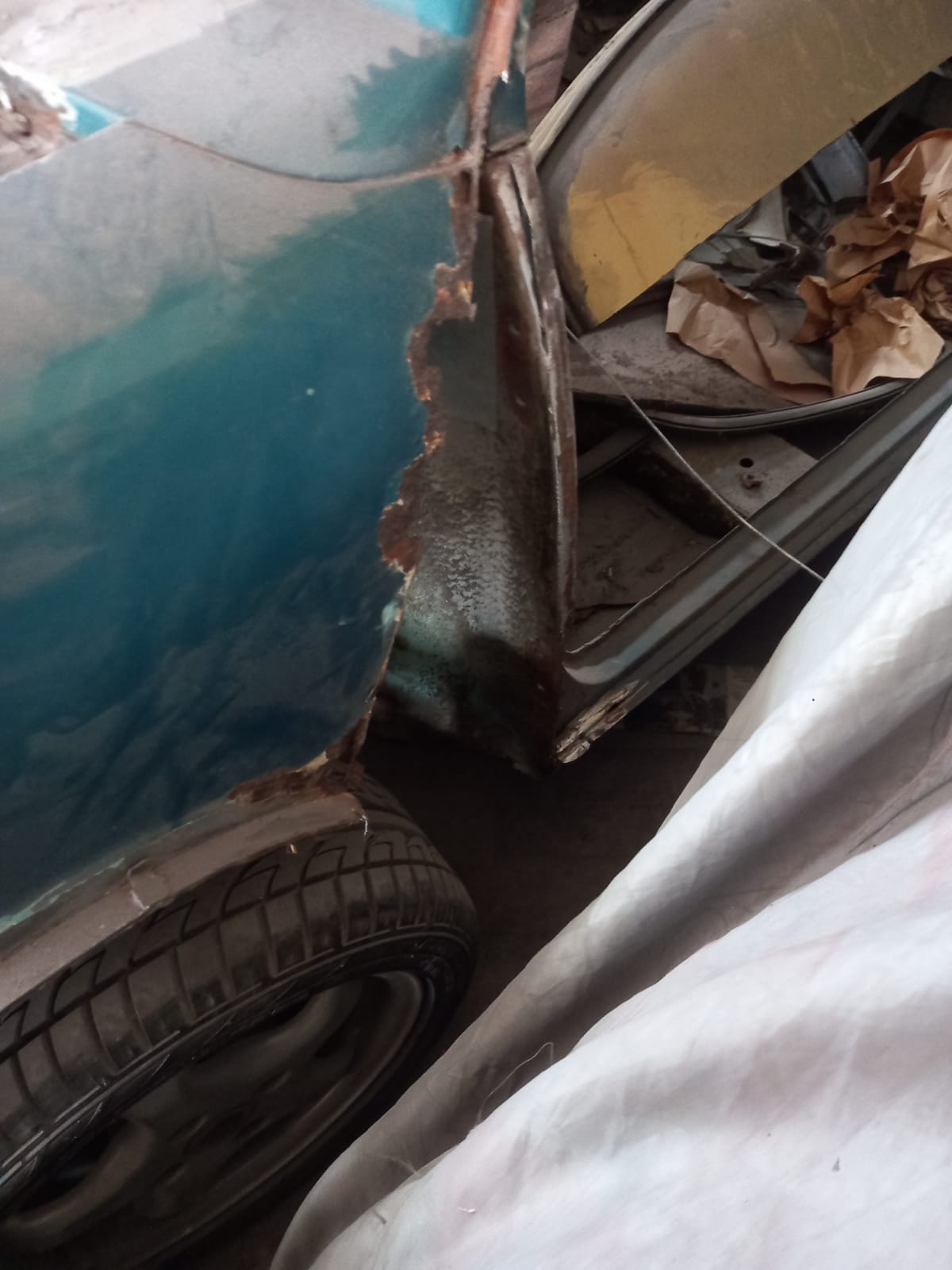

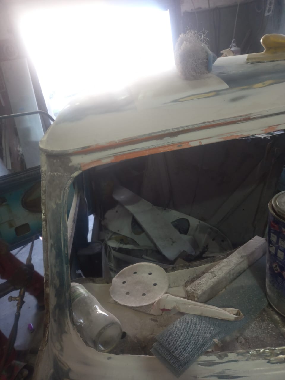

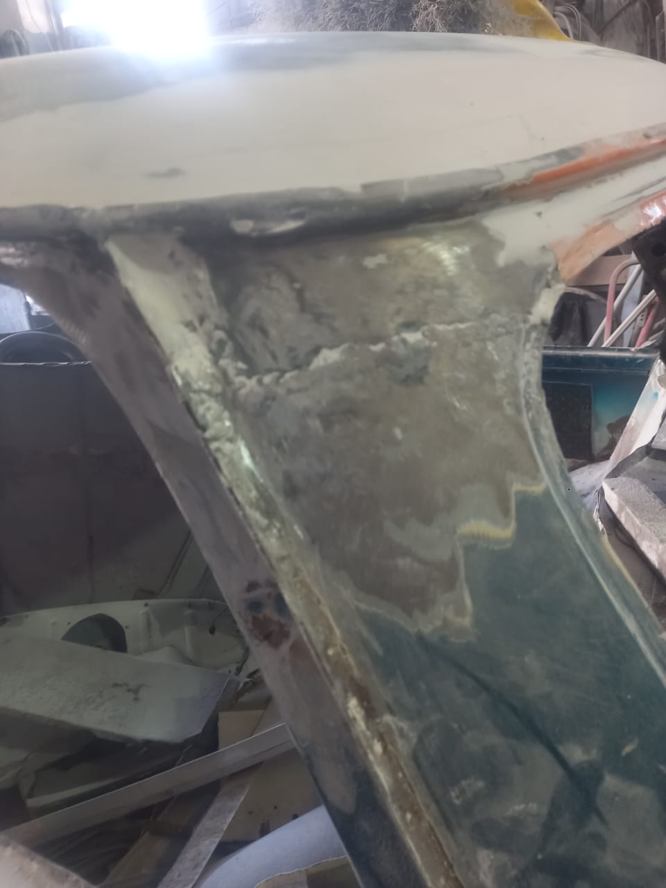

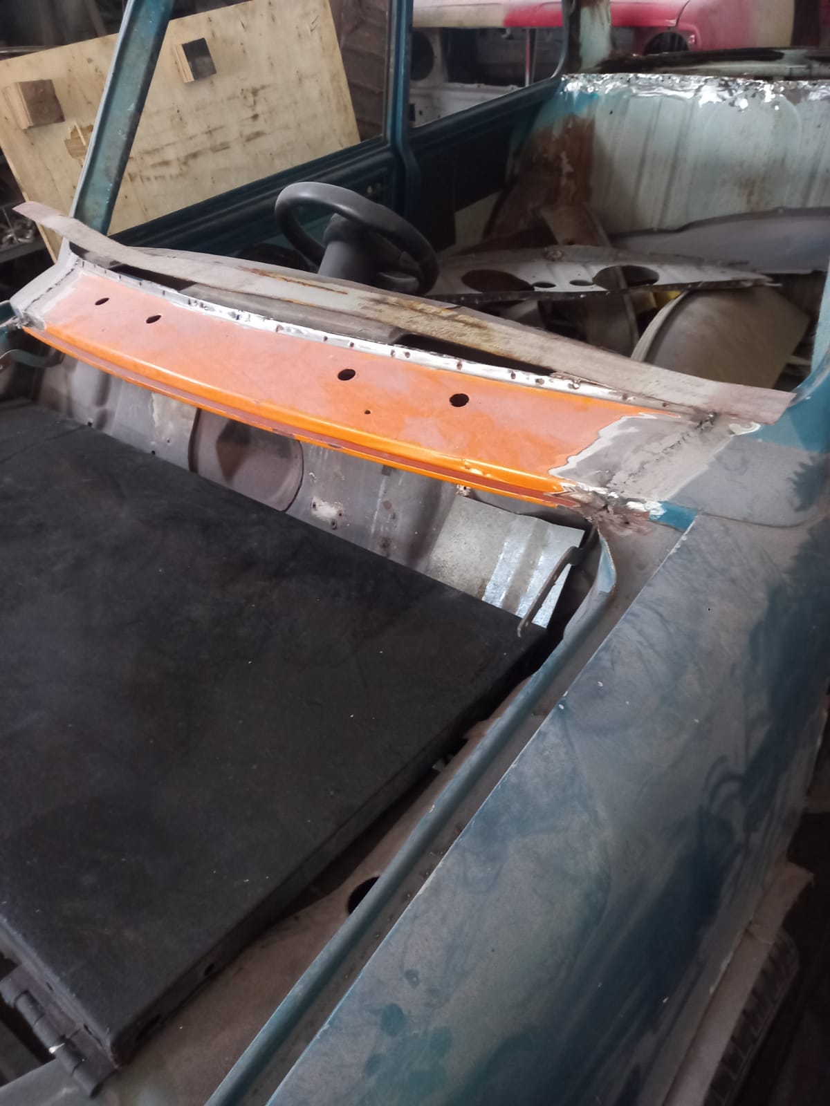

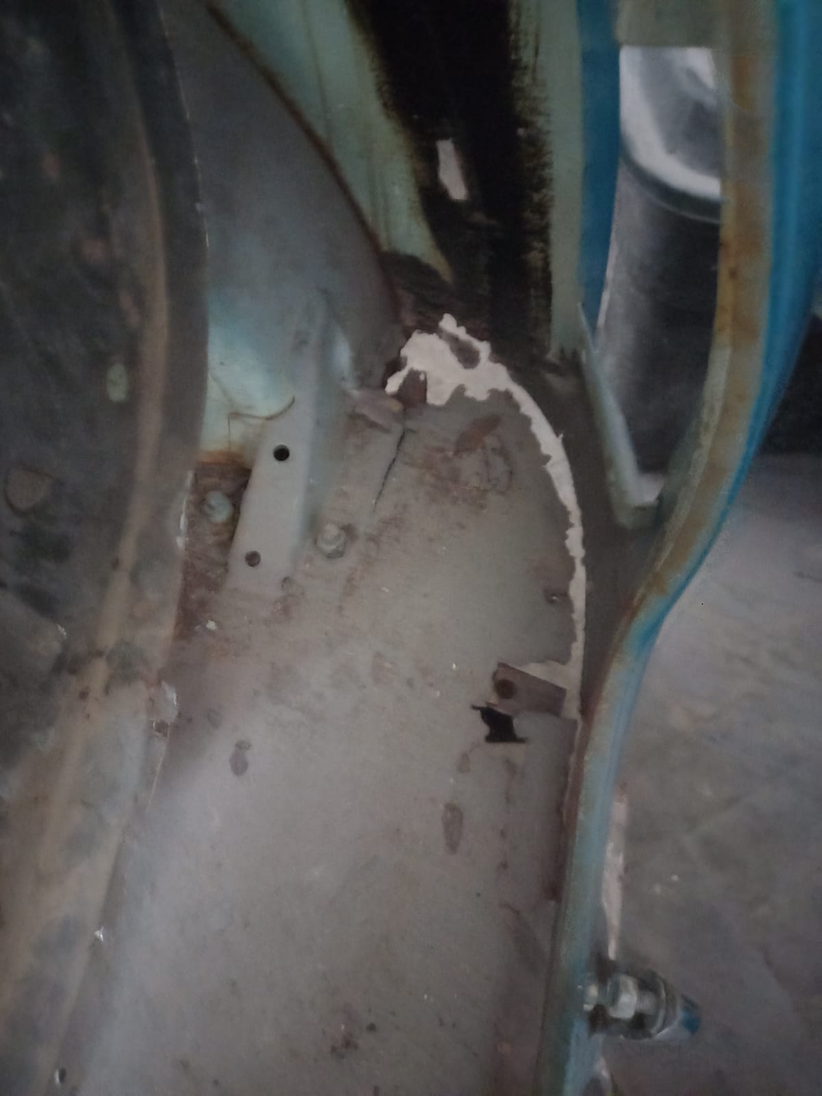

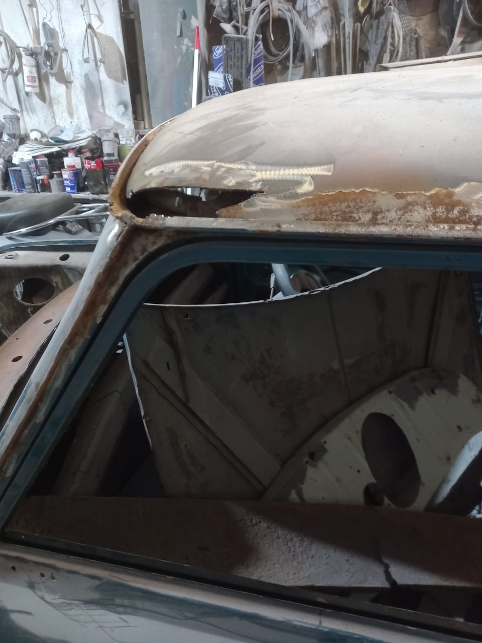

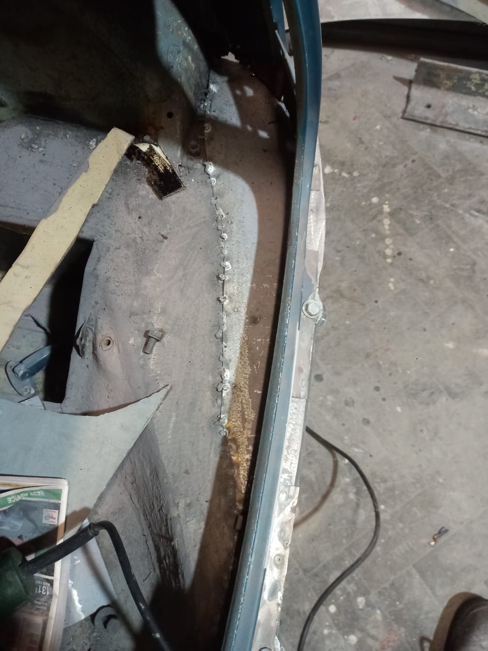

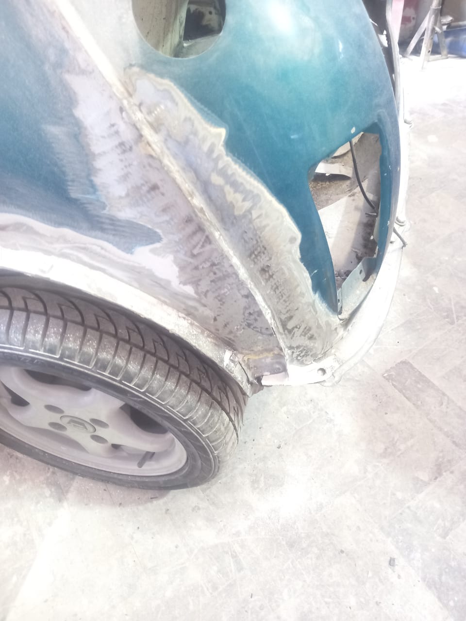

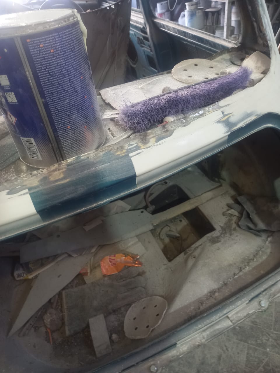

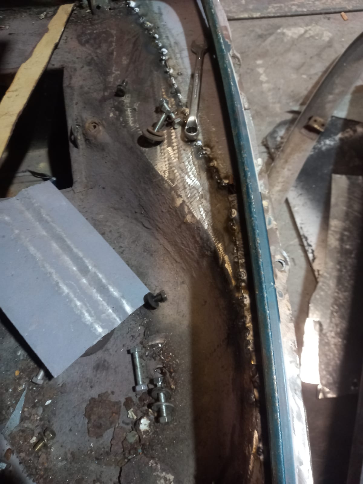

The bodywork is coming along slowly as well. I visited the workshop a while ago for an update and they recently sent some pics of progress.
Rusted wiper panel removed:
replacement fitted:
Old parcel shelf was removed and a replacement is ready to be fitted:
One side A-panel removed:

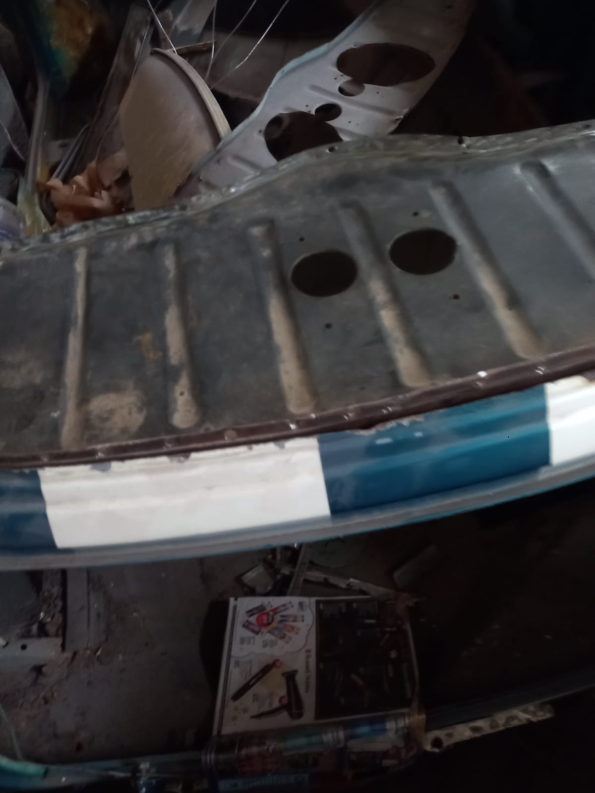

Boot floor is looking pretty bad as well:
There is still a long way to go...

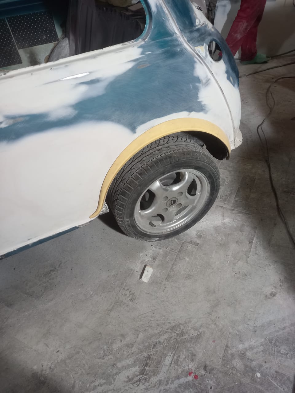

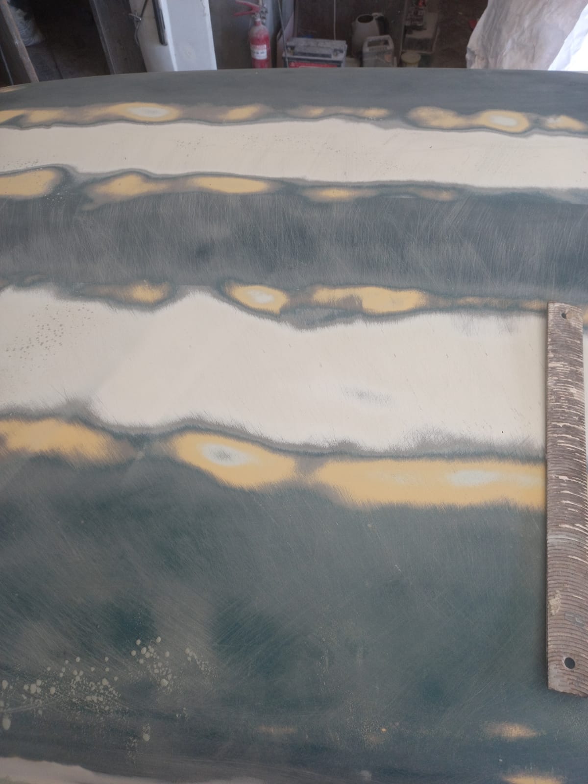

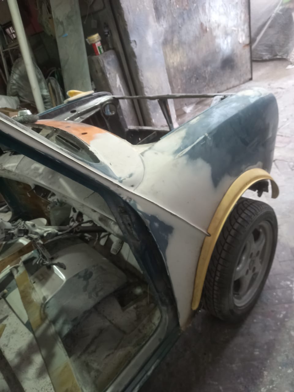

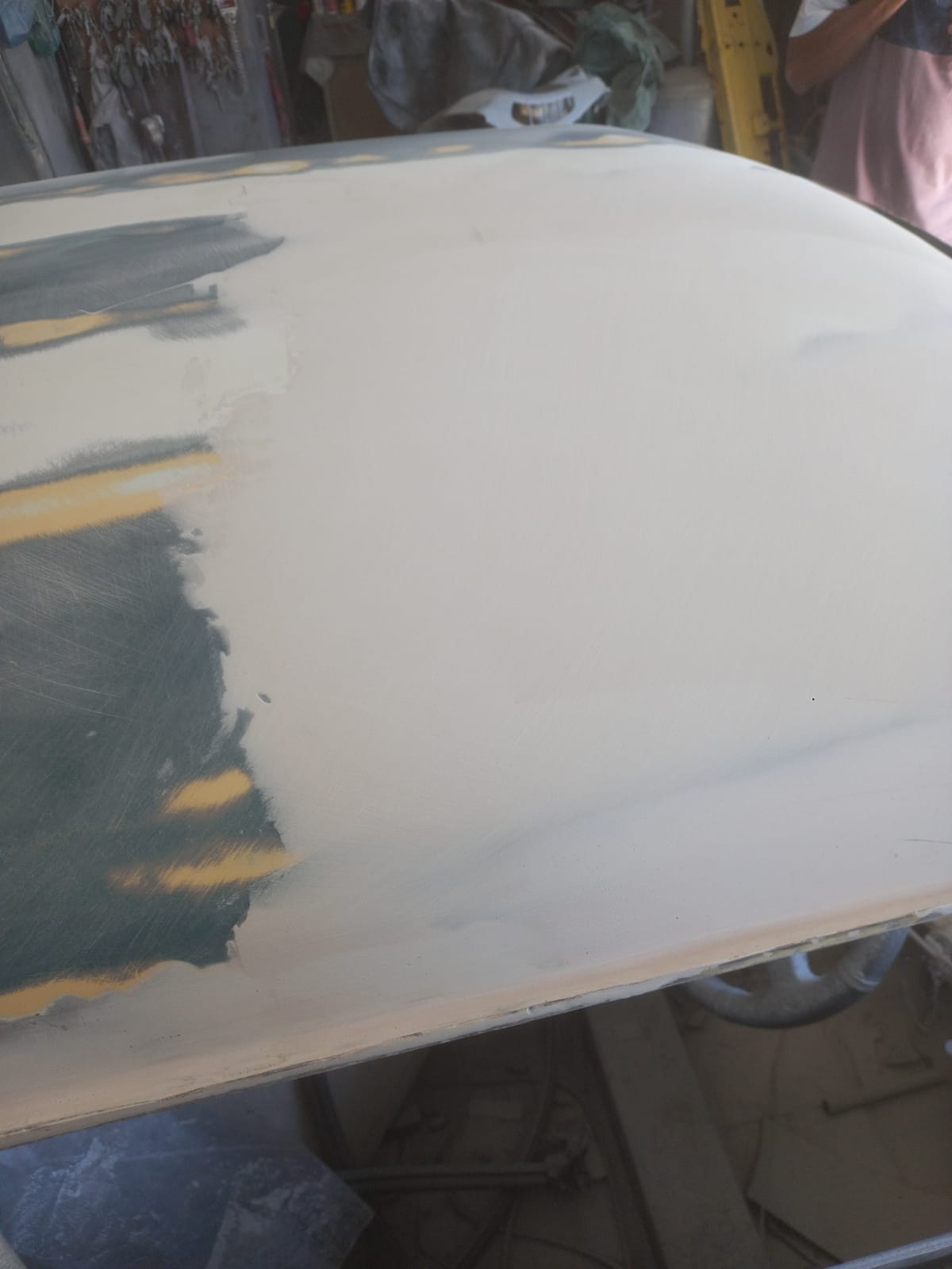

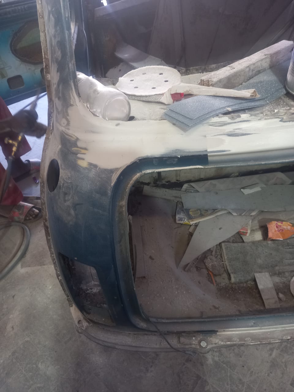

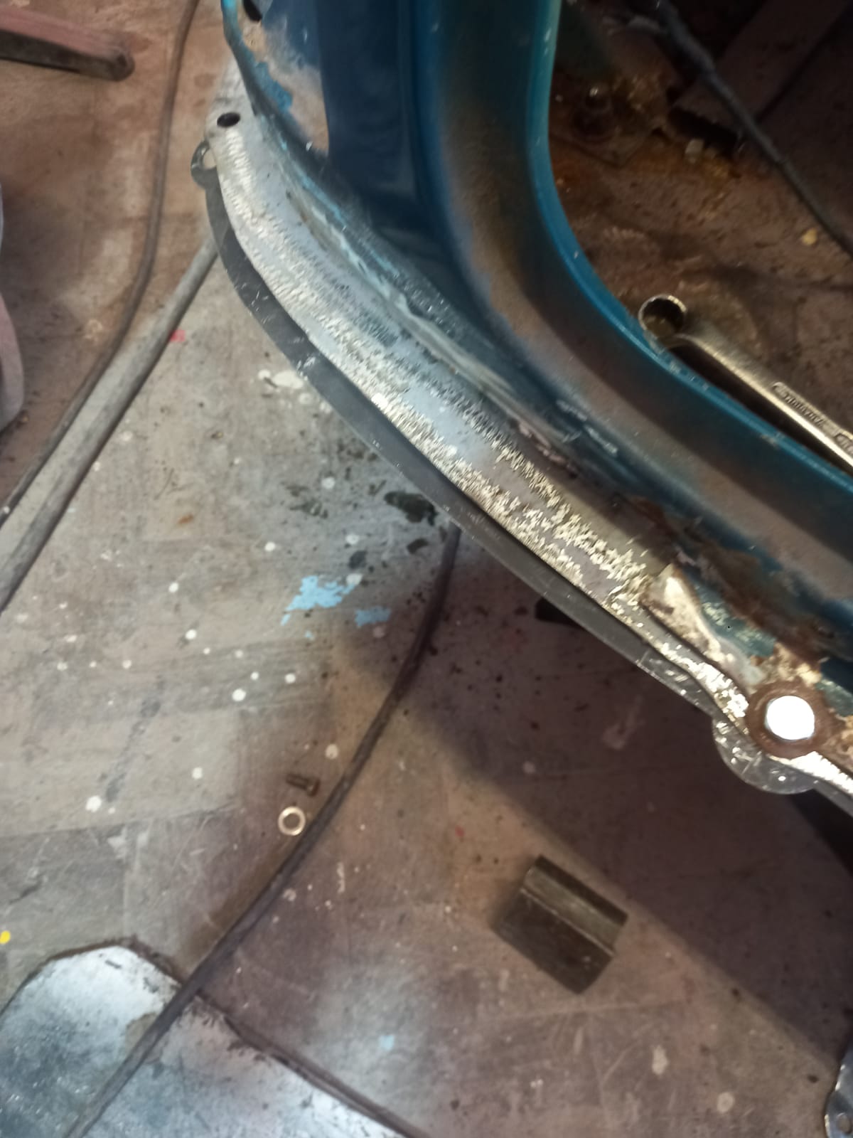

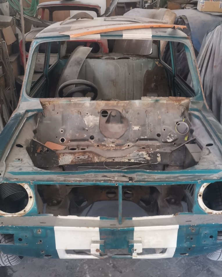

It's been a while since I updated with the progress. I haven't had much time to work on suspension and other bits so not much progress there but the bodywork is getting on and nearing colour stage.
These are some pics I got from the guy doing the bodywork:
Edited by miniGTS, 22 December 2025 - 10:59 AM.

Posted 06 November 2023 - 08:00 PM

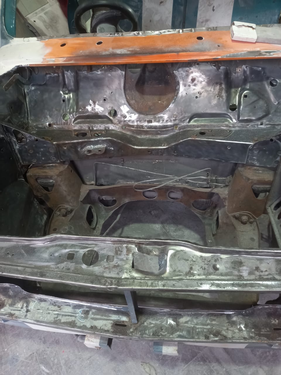

Some more pics:
You definitely don't want that gap! Also have you used the recommended combination of standard rubber bushes on the inside and poly on the outside of the bracket?
Edited by johnR, 07 November 2023 - 09:37 AM.

were the lower arm bushes the correct offset type and fitted the right way around, that would affect the angle the bottom arm sits at (i.e. pulling away from the tie rod towards the rear of the car instead of angled slightly towards the front)
It looks like you did get the front bushes right to me.. the black one is the normal rubber (inside) and the poly outer is purple (or at least it is in the kit I bought)
Yes, I have the rubber on the inside and poly on the outside. The gap was before tightening anything up. So after tightening the nut a bit it pulled things together and closed the gap.
As far as I know, the lower arm bushes were the correct ones and fitted correctly but they split after tightening it up. I decided to change them with the poly ones from MS and those fitted and tightened up without any issues so those have also been sorted now.

I got some updates from the bodyshop. They've sorted out the standard arches for the GTS. These are the same as the Australian GT. Then they have also given it a 1st coat of MS primer and will hopefully be doing colour soon.
Some updated pics:
