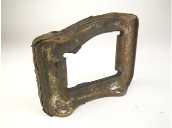

I assume this is the sandwich plate you are referring to? This I imagine will be the biggest issue if I want to reuse the gearbox - although I initially was only looking for an engine and was going to get a remanufactured gearbox, I imagine this would solve it.

Yes, that’s plate. The Austin America bolts go through the plate & diff horizontally. The mini bolts go up vertically from the bottom
