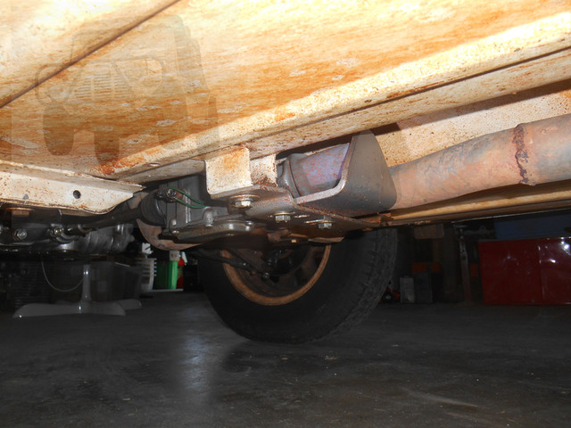

Sorry this is a less than ideal photo, but it's all I presently have to hand;-
It's basically a slide mount. It allows the shifter body to move back and forth with the engine, but not rotate. There is still some rubber in the system - the bush on the back of the diff cap and the bushes on the back of the Shifter Housing. I've made a few of these now, my own I've done around 20 000 km with now and still love it.
