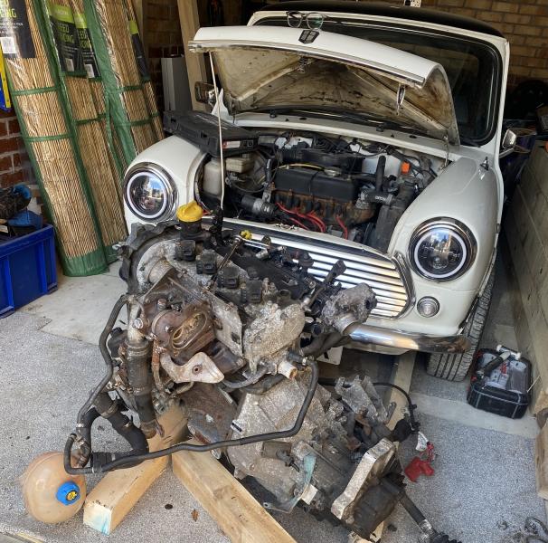

Posted 13 March 2024 - 07:28 PM
Plenty has been happening since last time.
Engine and subframe has been sent down to RCL Frames. Suprised to find out that the engine fits with no modifications required with regards to suspension/ geometry.
Standard tie rods etc all fit with no issues! Turbo needs relocating though...
Also bought a new steering rack, the old one is old and i like new shiny parts :D
Some adjustable suspension components also bought for when i get the subframe back, to fit.
Currently still on with sorting the front panels out on the car as i seem to find more and more rust the deeper i look (but its not too bad).
That is quite a big engine, But I don't think you'll ever fit a Mini into it.
We've already proved it fits, just needs the turbo relocating and a few other bits :)
