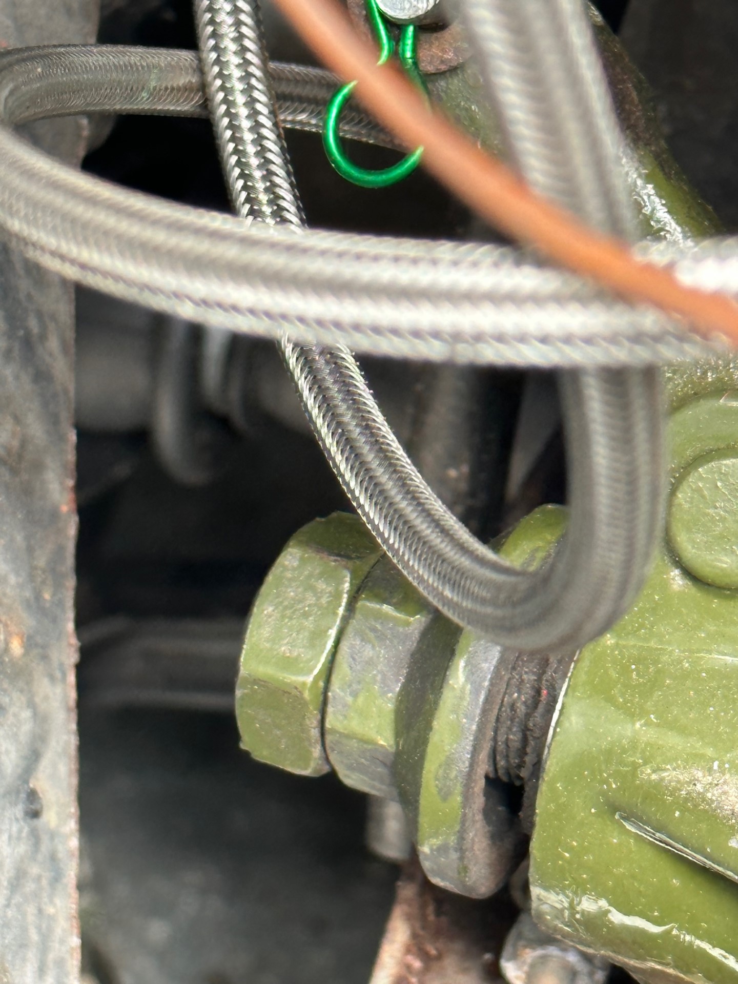

Old engine clutch lever seized but Id pressed pretty hard on the pedal before realising.
Have I bent it?
New engine in, mot passed, changing down to second its crunching, very gently crunch going up to third.
Tried double clutching, tried slowing down.
Any advice woud be greatly appreciated.
Thanks Mike.

It has been known for the ball to break off. The ball also wears. Pull the arm out and look.
Yes clutch pedal is normally lower.
