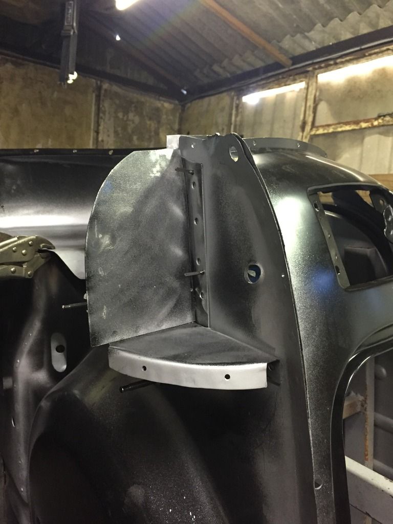

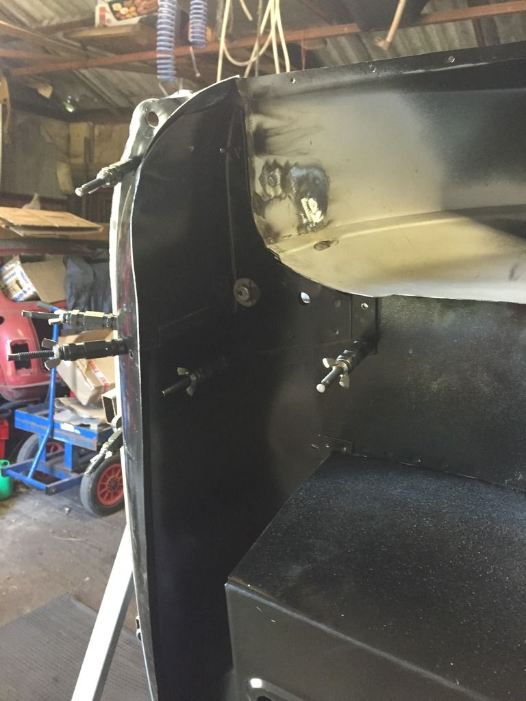

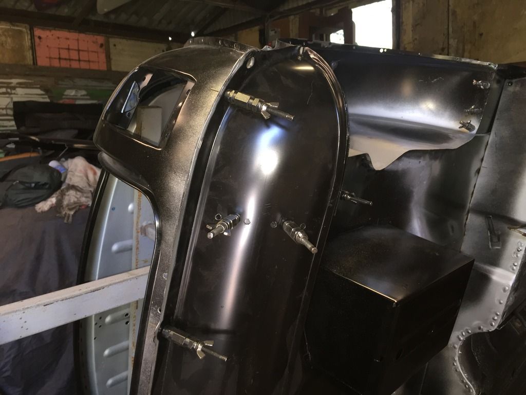

You need 1/4" holes for plug welding and do it from underneath if you can.
