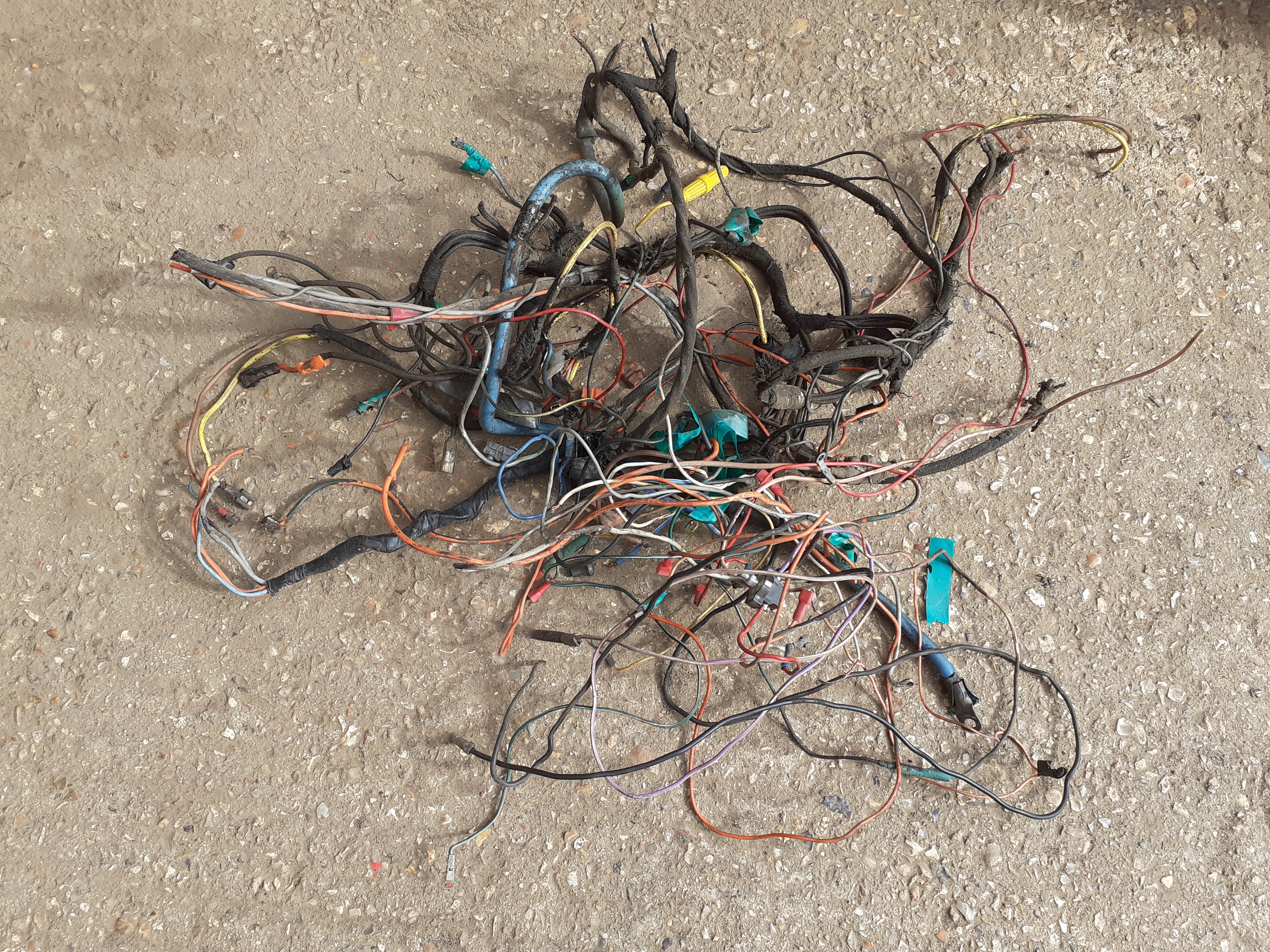

Posted 01 May 2026 - 10:44 AM
This was what it looked like when I got it
Then I removed this:
Now it's 99% done - just need to connect the dipswitch and earth the fan, then on to wiring the instrument panel
