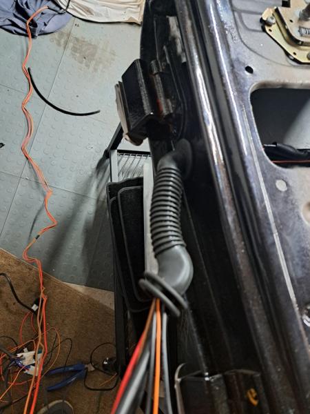

All wired via the existing door switch? I do like this idea.
Yes - all grounded through the door pin switch but also a dash switch to turn off in case I want to leave the door open for sometime without isolating the battery.
Wiring was a bugger!
Attached File  post-136647-0-00890700-1710098411.jpg   44.02K   5 downloads
Attached File  post-136647-0-89005500-1710098427.jpg   52.82K   4 downloads
Looks a neat job though

What's the boot/grommet you're using there?
They were the smallest I could find 25mm - eventually bought them from Aliexpress (Pack of 5).
5 pz 25x25mm cablaggio auto tubo porta tubo antipolvere filettatura tubo di protezione tubo di gomma nera resistente alla corrosione (aliexpress.com)
Sorry - it's in Italian as that's where I am at the moment!
