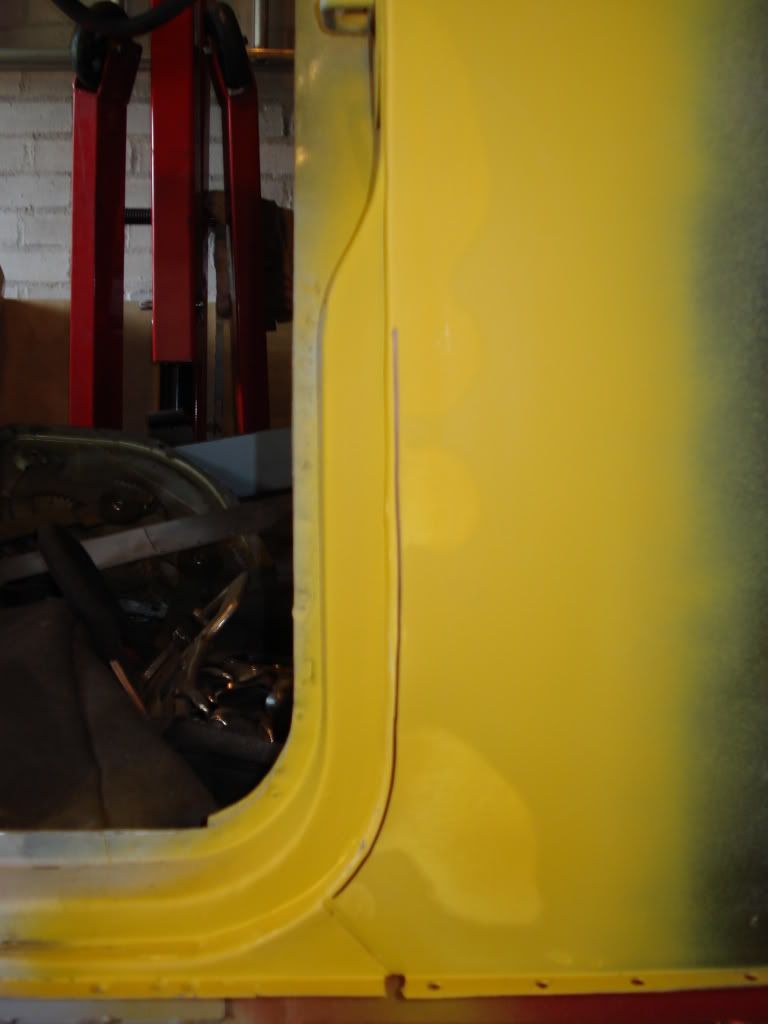

So this is my lads car which fought me every which way you could think off. I should have seriously cut my losses with this one but we carried on. So the same side as yours with a very similar issue although my A panel had not been fitted. I also made the rookie error of fitting my panels in the wrong sequence but certainly learnt my lesson from this car.
879ae07ed3bce2c3b6468b009aac1ce20c4d8b8b
So gapping issues like yours certainly at the rear of the door.

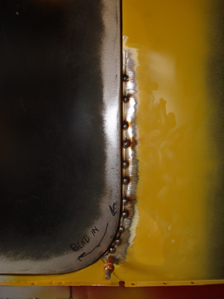

Marked out where i needed to section.
e2aff5c668eab8ca1b1d5f64062564a1079b2fe3

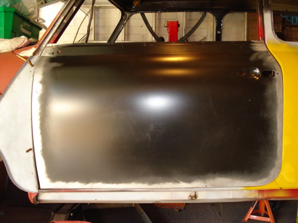

Sectioned and dressed back the affected area then tacked.
7edbb7edfe5be8a24574890a1aef52ee8b909375

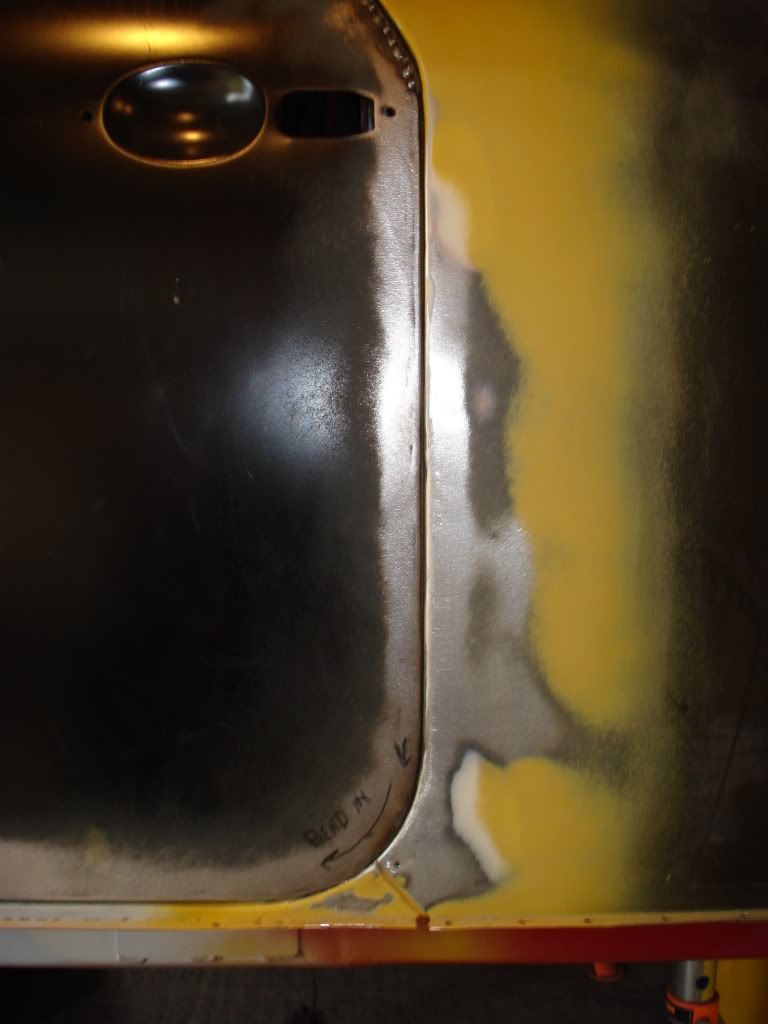

And the final result
c5d0763438358ac2e165527af19f809fe08a3695
This was a lot of work plus a lot more to do as well but it fitted so much better. Wahtever you do if you go down this route try a get £1 gaps as a minimum, DO NOT go tighter.
