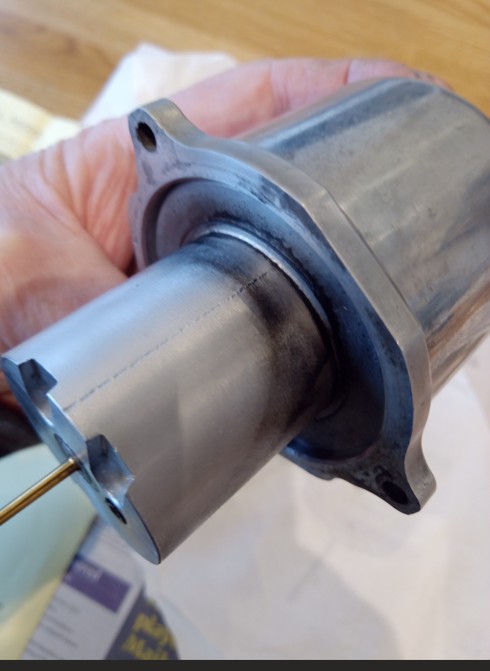

Retarded it and it would then start OK but not run with any power and was continually blowing back through the inlet side (no airbox on it).
See Carbon footprint on the carburettor piston.

Firing/detonating on the intake side suggests:
  • its too advanced?
  • Knackered sticking inlet valve?
  • I'm a complete putz (don't answer that). ;-)

Your engine has had so much work ("Under the bonnet is a nicely modified 1275cc engine, everything was replaced when it was built. Has a stage 2 head with 21cc cambers etc that has literally just been re done. A nice lumpy cam with upgraded pistons and paired with an AC Dodd HIFF 44 carb, 3 branch LCB and full side exit Playmini exhaust system which of course sounds epic. The gear box has just been totally rebuilt meaning that this Mini wants for nothing. A full rolling road set up, resulting in a great 83.2bhp & 83.5 ibft, she will now be more like 90 bhp with the head just being redone.") that what it started out as becomes almost irrelevant.
Interesting that it's been on a rolling road - even though it's had work since. Might be worth finding out where that was and whether they remember it or have records. And if you can get the power/torque curve it'll give some clue whether it has a mad race cam that you'll never want to use as a daily driver or something that can actually be made driveable.
