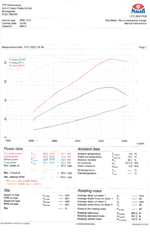

In amongst all the receipts and assorted "stuff" is this rolling road report from 19th Jan 2023.
Whether it refers to THIS ENGINE in this car or not.... who knows.
The previous owner was indeed called Alan.  Alan, had another mini (a van called "Alfy") did he swap the engines over?  Again, who knows.  :-)
He has told me that my car has had to have a new head because the previous one cracked.
With the "Mobiletron" dizzy on it, I could not get it to run.  With the new Powerspark 65DM4 it at least does run.   Now Mobiletron is the only marking on it, and Mobiletron just refers to the inductive pickup manufacturer.  These parts can be fitted to many distributors I think, and there is no vacuum-advance unit on that distributor.
Assuming it is this engine, would this torque/power suggest a racer or just a "fast road mini".  I have no idea.
Edited by DClarke1954, 19 February 2025 - 03:50 PM.
With the "Mobiletron" dizzy on it, I could not get it to run.  With the new Powerspark 65DM4 it at least does run.   Now Mobiletron is the only marking on it, and Mobiletron just refers to the inductive pickup manufacturer.  These parts can be fitted to many distributors I think.
I'd call it fast road for a 1275
