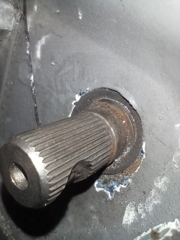

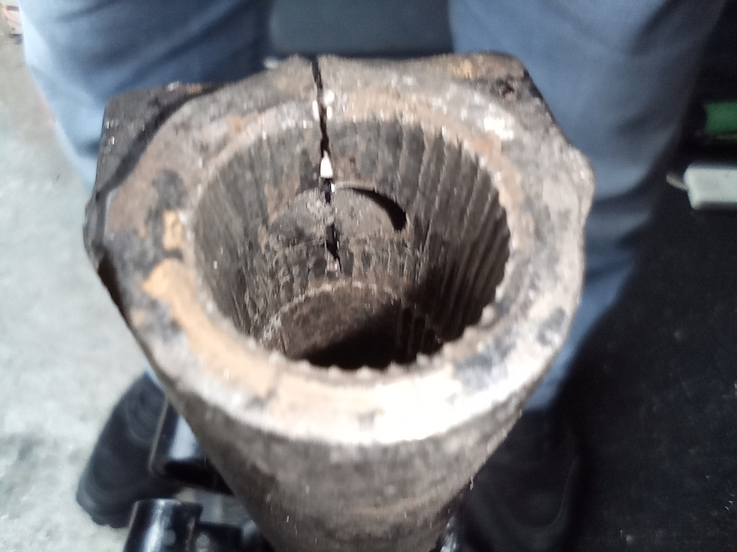

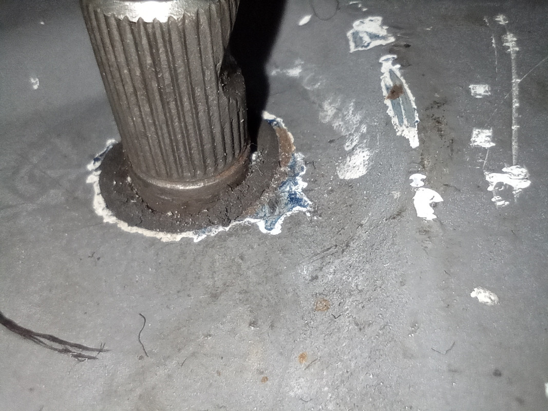

Well, thank you so much you forum folks!
I took the column out and it does look like hte failure is in the column socket insofar as the splines are either missing or worn down to next to nothing.
Compared to  the steering rack pinion splines which are all whole, sharp and in good nick.
Pictures are below (I hope).
The Column's socket, all heavily worn and almost "gone" in some places.
The splined pinion:
and the other side:

Posted 27 February 2025 - 12:52 PM
Hi,
To me looking at the spindle some of the splines appear to be worn down more on the outer end than the inner. Could this be an indication that the column was not push far enough on to the spindle
and the clamping bolt did not go through the grove.
Paddy
Edited by Designer, 27 February 2025 - 03:32 PM.

Posted 27 February 2025 - 07:25 PM
That can happen when a steering column drop bracket is fitted without loosening the u bolts on the rack and letting it rotate to the new position. H
Hopefully you can find a good condition replacement column

Posted 27 February 2025 - 11:00 PM
It does look like the column was pushed on all the way as the splines are worn past the bolt hole. The rack should be loosened during installation. I do up the pinch bolt and then rotate the column while tightening the rack.
Repair pieces are available over here but a used column will be much cheaper.

Posted 20 March 2025 - 10:46 AM
The repair was effected with a 2nd-hand column inner.   All good now.  Thanks all. :-)
Car went on to get an MOT pass.

Posted 20 March 2025 - 01:01 PM
common issue especially with incorrect fitting of a drop bracket, and been behind a mini which ended up on it's roof after this failure, the old columns the bolt would only go through the pinch if it was lined up but on newer racks the slot goes around the rack spline so easier to get the bolt in but if the spline fails then so does the steering at least on the other racks the bolt prevents the steering going altogether. the racks on my cars now have the older style spling after seeing the above accident.
