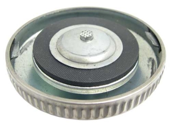

I'm curious about the filler cap comment though....what effect would that have on the fueling?  Since this is a canadian model car, it has a different cap than most of the other models.  It looks like this

I would have to see the exact setup but if that is the correct oil filler cap, the failure mode would be running lean due to it leaking. There is probably an inlet somewhere else such as a hose going to the air filter. If that is blocked then it will run rich. Any of the associated hoses could be leaking or blocked and cause the same result. The breather system can also cause it to run rich if the engine oil is somehow contaminated with petrol.
