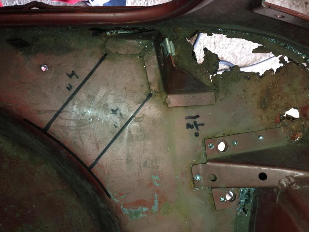

#5 sonikk4
sonikk4
    Twisted Paint Polisher!!!
  • 16,170 posts
  • Name: Neil
  • Location: Cotwolds.
Posted 05 July 2025 - 09:10 AM
If yours is missing then this picture will help you position it correctly
7925ecbba778868b55d1fbded3a911b5257c7678
