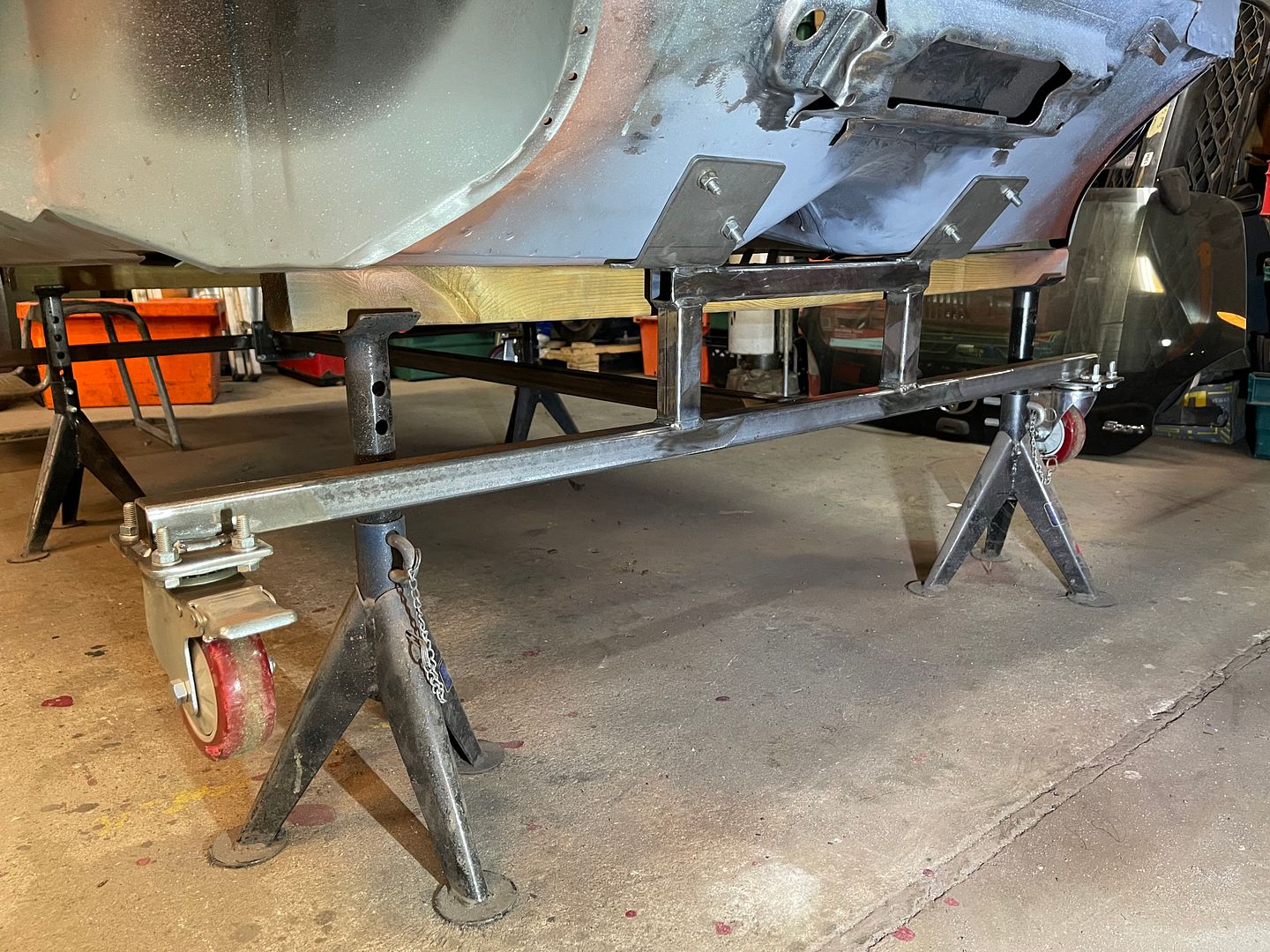

This was a shell trolley I made recently so not totally related but similar mounting method.
2acb39fe-e367-491c-b424-9f82986fb493.jpe
If you make a spreader plate as above that also picks up the horizontal plane you could bolt a traditional solid mount on over the top or you could fabricate an ear to weld on and bolt directly to the subframe.
