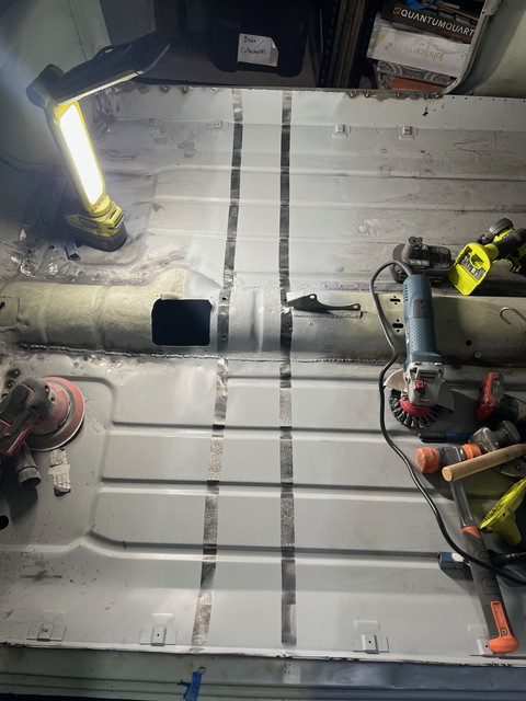

Been a while since I have posted an update but the work did not stop.
I've now got all floor panels in and the seat crossmember.
IMG-6257.jpg[/url]
There is still more stitch welding to do on the heel board to the floor for additional reinforcement, but otherwise its starting to take shape.
I've also started adding in the companion bins
Next big milestone now that the floors are 90% done is the boot.
Original plan was to juse use a spare wheel section replacement and some small rust repairs, but it turned out the floor was too far gone, it was completely rusted apart from the tail section and rear valence.
So now I have the fun job of cutting the whole boot out and drilling all the spot welds so I can put my replacement boot panel in.
