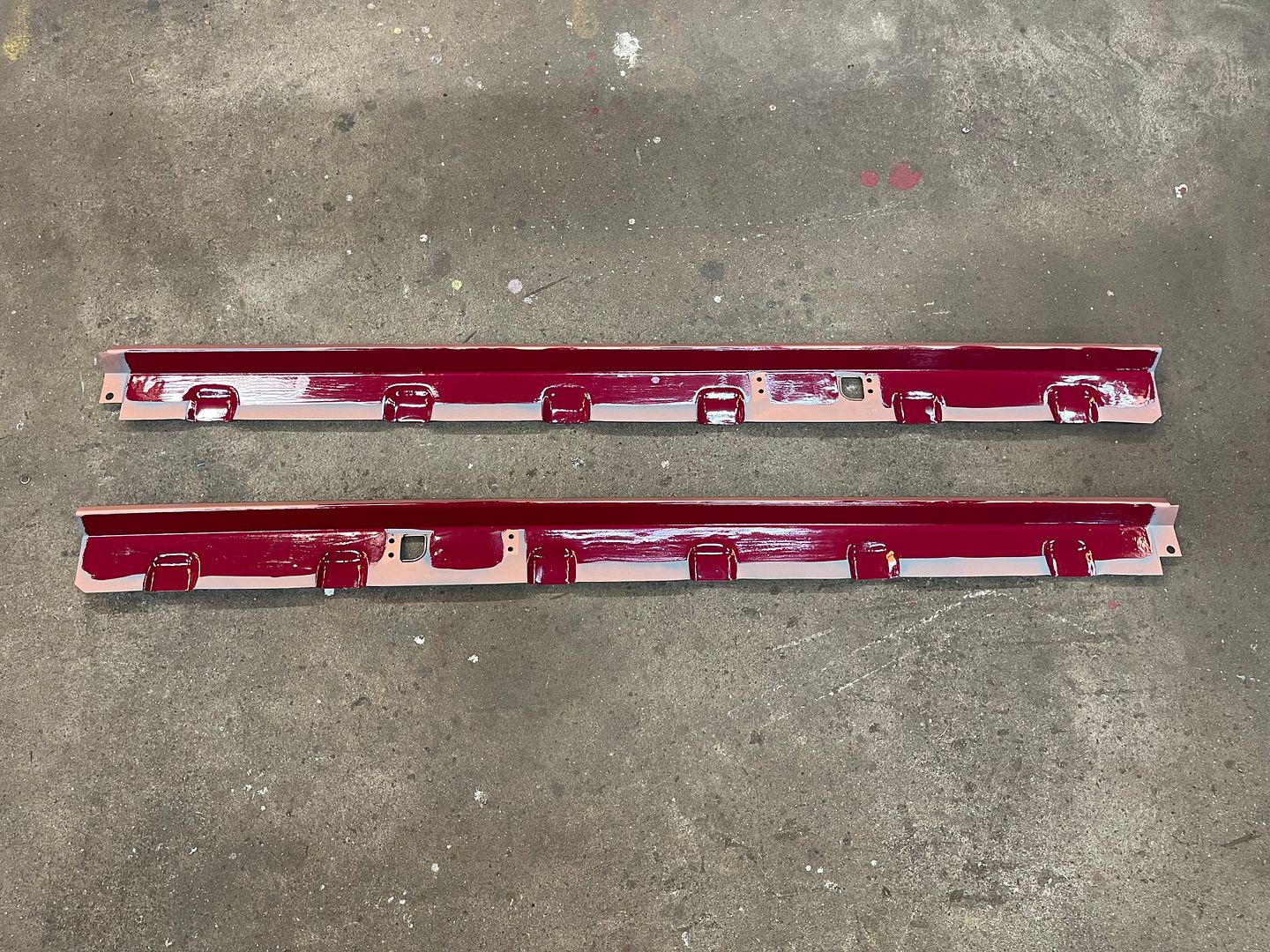

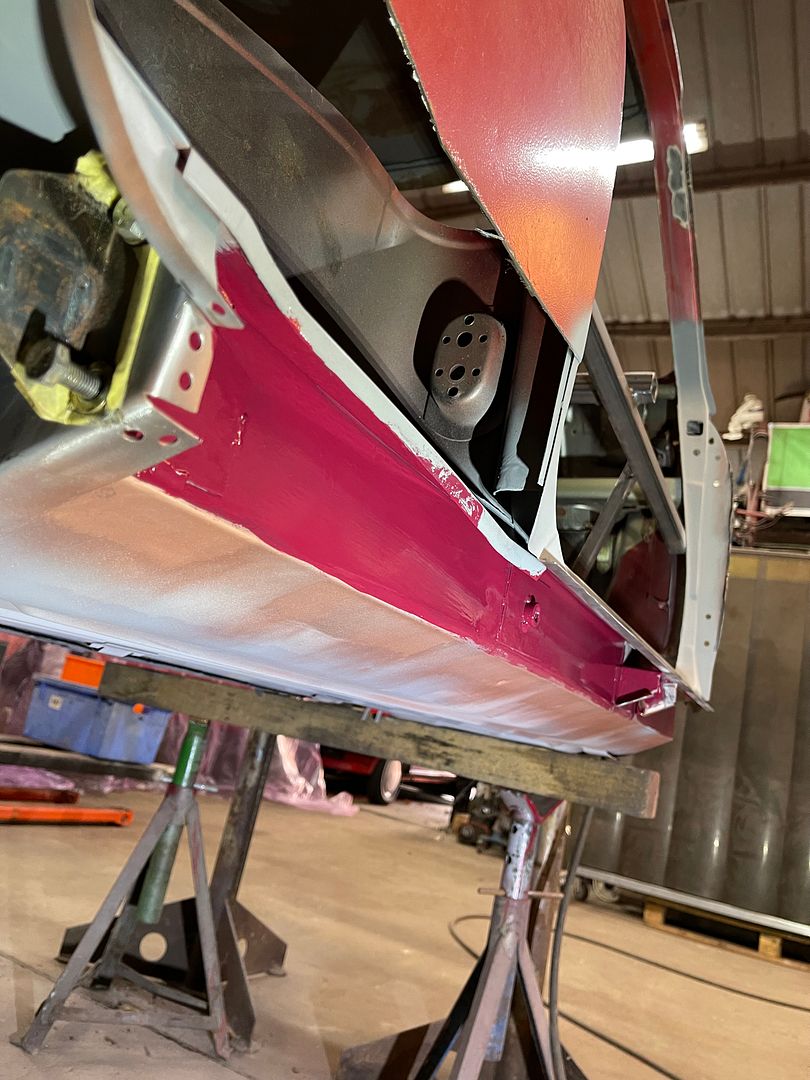

I walkway paint the sill cavity with a zinc primer and 2K top coat and the welded areas with weld through primer. You might not bother if you’re patching up a ‘08 Focus but it’s definitely worth doing on a classic.

100% with Tupers on this, i always prime and topcoat. If you are using a Magnum sill i would strip off the primer coat they use. In the past it was bloody awful and even the later stuff is debatable.
And just to throw a curveball into the mix, i do the same with Heritage panels as well. I have had over the years numeorus panels with spider tracks of rust hiding under the 'E Coat'. No point in my eyes changing a panel and not sorting it correctly to start with.

Forgot to say... Re TUPERS post with pics of sill with paint....
Thansk v much for pics. I was struggling to work out where the "void" was once outer sill welded in place. Especially confused re why the "drainage flutes" didn't seem to be at the lowest point... had vsiions of water accumulating below the flute level. Your cpis of the inner sill make it so much eassier to visualise where the end of the flexible spray nozzle went, adn more espeiclly, wheich direction to aim for.
I had never heard of "weld through" paint before: what a good idea. I shall bear it in mind for next bit that rusts off!
