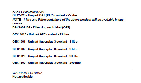

The story seems to be that they moved to OAT coolant during production due to corrosion issues with the alloy radiator.
I would guess few people are using the older types of coolant in an MPI now.
