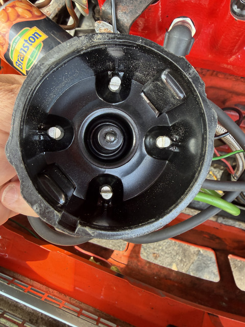

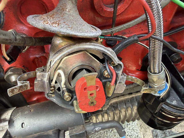

 The distributor cap looks ok, as does the rotor arm. There is a little play in/out on the distributor shaft, at a guess just under 1mm and there is a little side to side play, not huge but noticeable.
 Is the strobe at fault, or do I have another issue? Would a new distributor fix things? I'm happy to pay for a decent one but don't want to do that if the current one is ok. I guess it would need changing/adapting anyway due to the mods?
