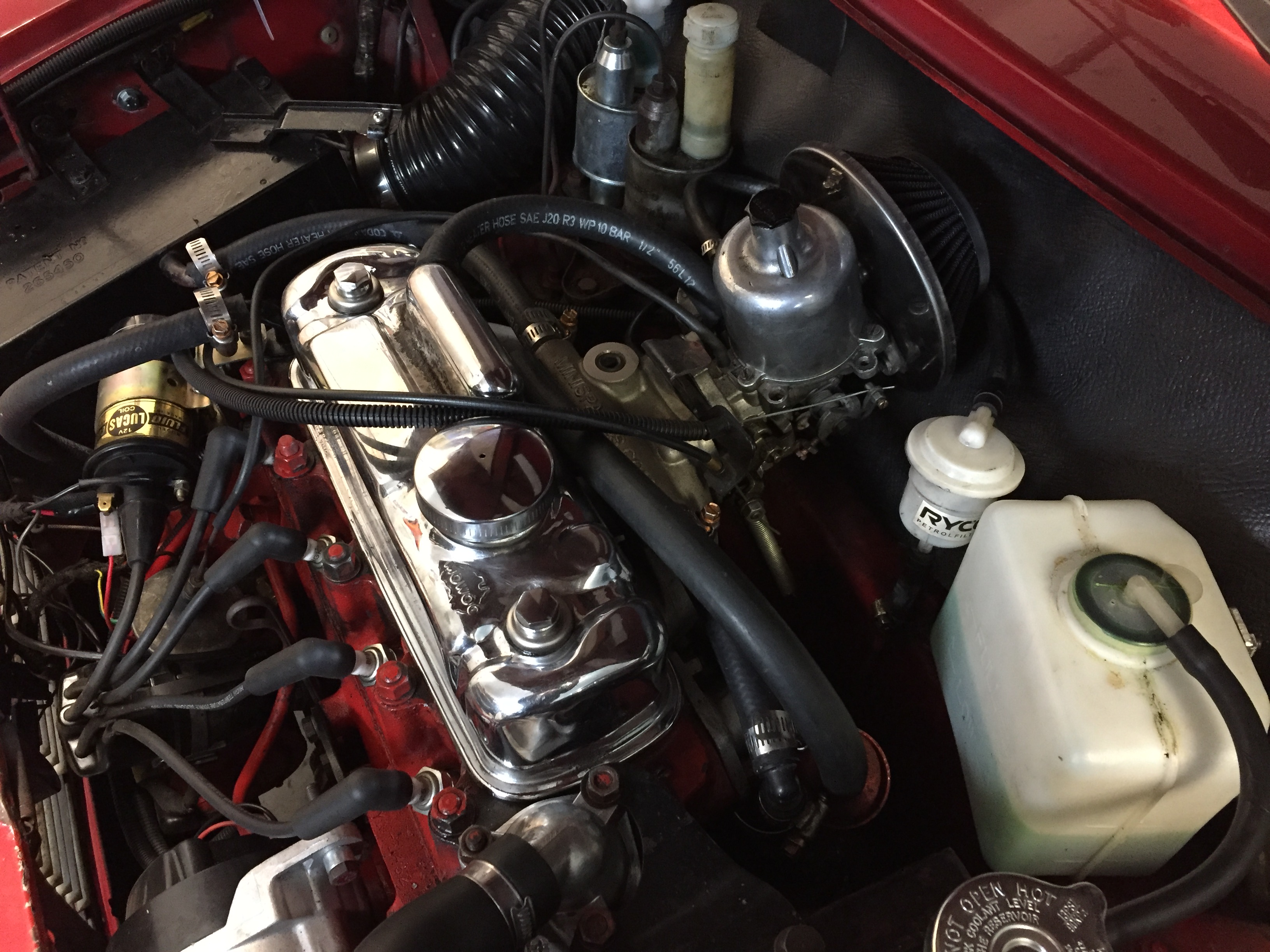

I had the following parts on my 1964 Mk1 with a 998 and there was plenty of room:
Minispares stage 1 kit
HS4 carb
KN offset cone filter
Have you got the correct cone filter with the holes offset like this?
https://minisport.co...cone-genuine-kn Go to the full post
HS4 carb
