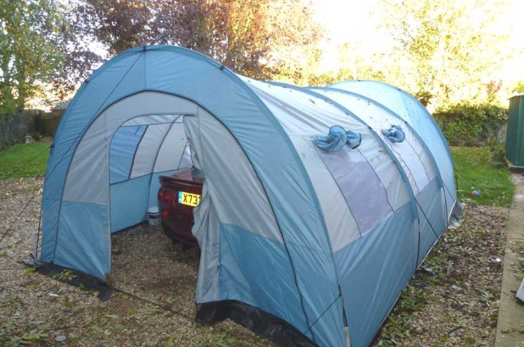

the moment I bought my Elise in 2010 I wanted to keep her in a garage, but our garage was  already full, full of junk that had nowhere else to go, so as a temporary measure I bought a 5Mx2.5M tent and used it over the first couple of winters

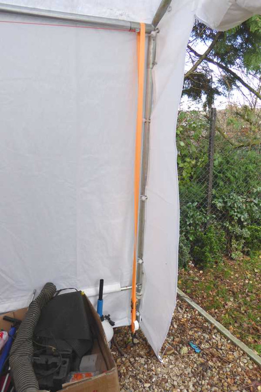

my goodness, every gust of wind looked like the tent was going to fly, then come winter the condensation would be dripping on the car, well on the third winter I bought a 6Mx3M marque it kept the rain off and the wind didn't move it, not after the long pegs I attached the frame to
 pegs and straps to be sure the wind wasn't going to be moving it

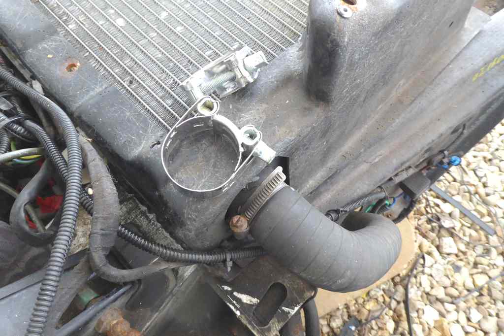

or when I decided to replace the original rad that had plastic end caps with an aluminium rad well the front clan had to come off for that job
lucky I was able to do most of the work on the car in the marque
the old rad
I alos swapped over the flimsy looking jubilee clips

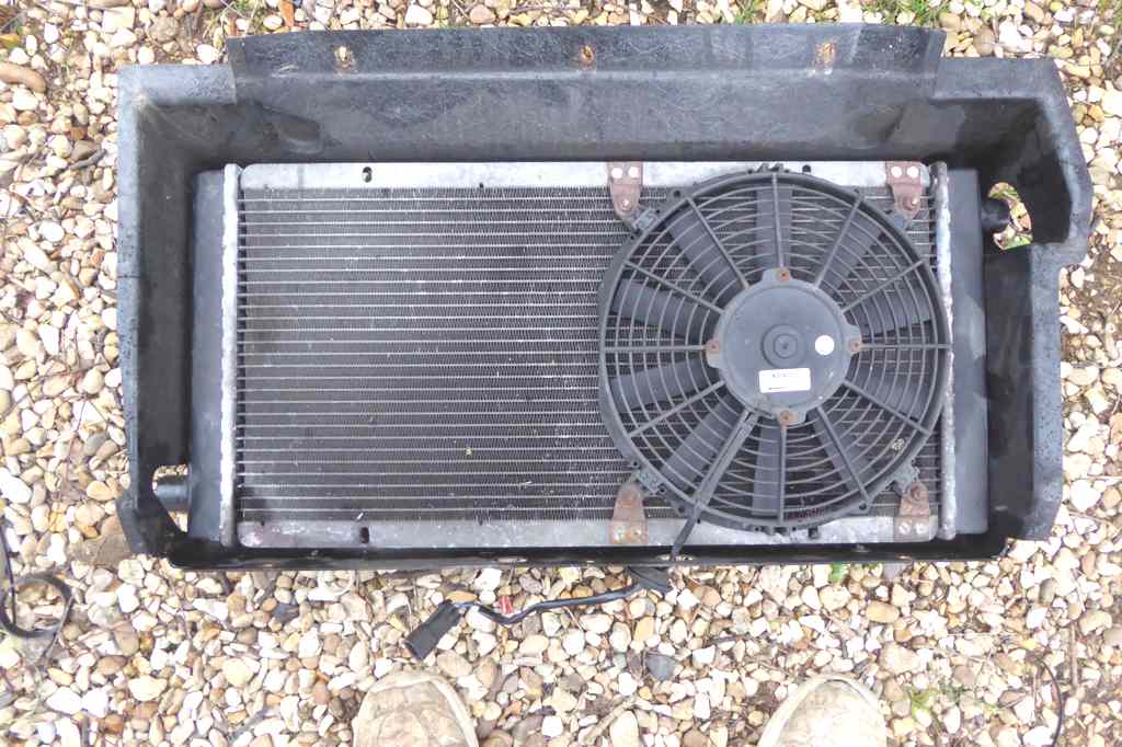

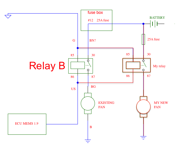

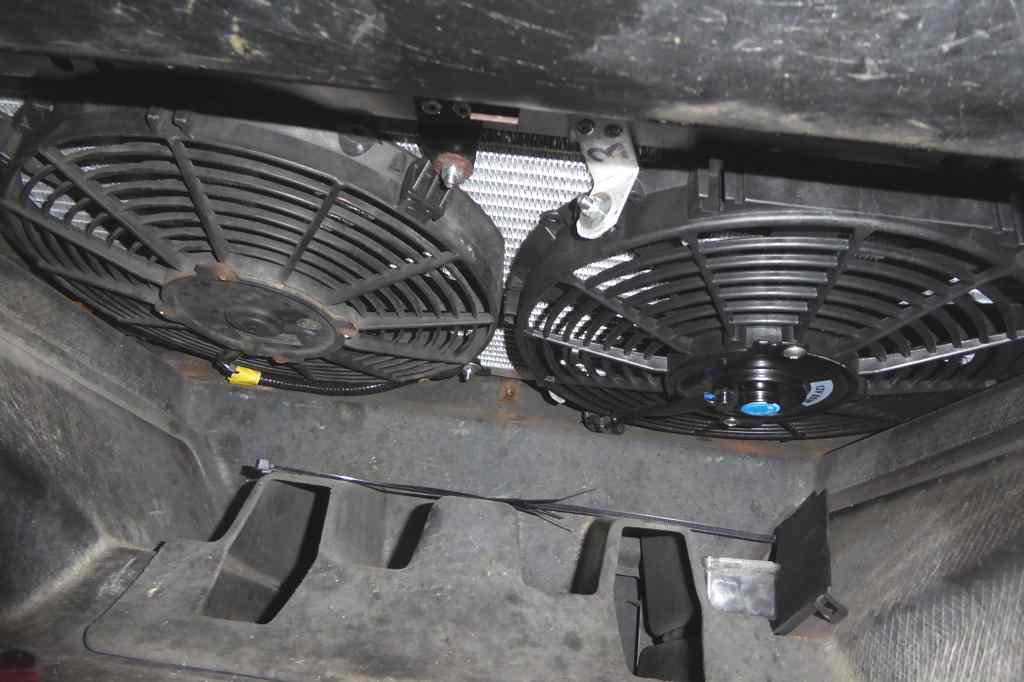

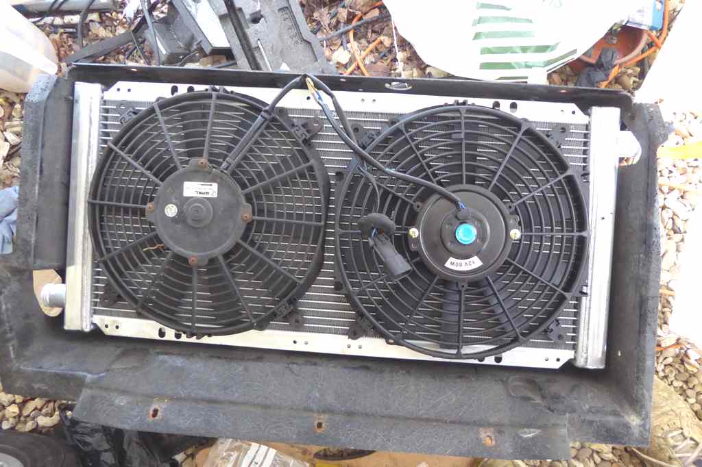

the rad had only one fan , on the new aluminium rad I fitted a second fan, for my drives down to Italy and the many slow moving traffic in the local villages

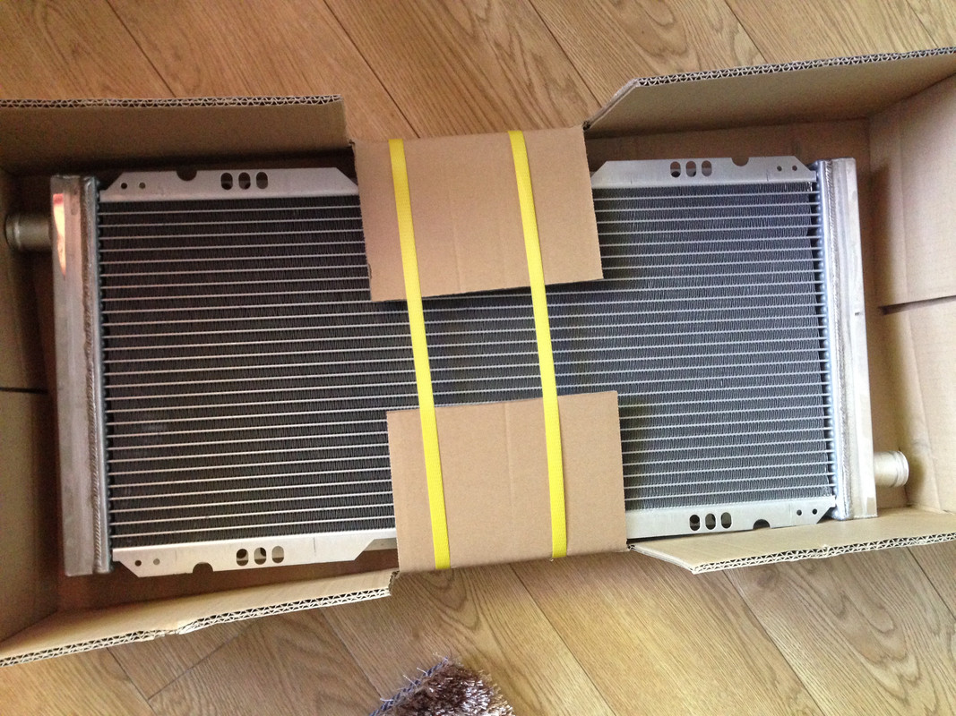

The ali rad, no intention of buying one but I was at the Stoneleigh kit car show as I had been going since starting my first (and only) kit car build, I used to get there on a Friday night and camp till late Sunday night, on this particular year, on the last day (Sunday afternoon) I thought I'd take a final walk round and came across a stand by coolexperts who make ali rads, I knew the going price for the ali rad made for the Elise and as it was the last day and they had on with them they offered it at a too good a price not to buy one
fitted the second fan on the ali rad
splicing in new fan connection

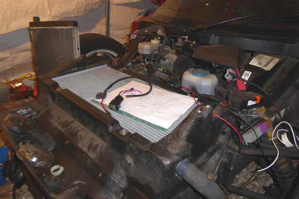

my wiring for the new fan

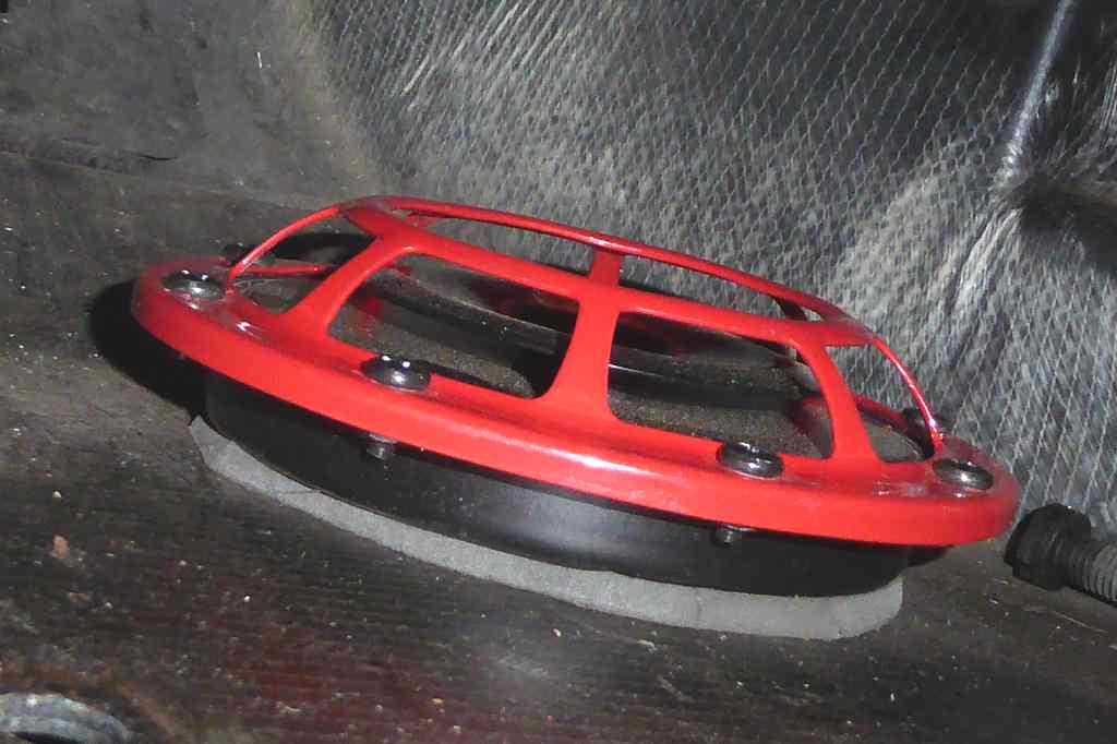

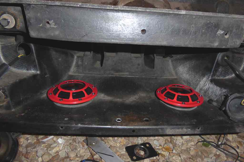

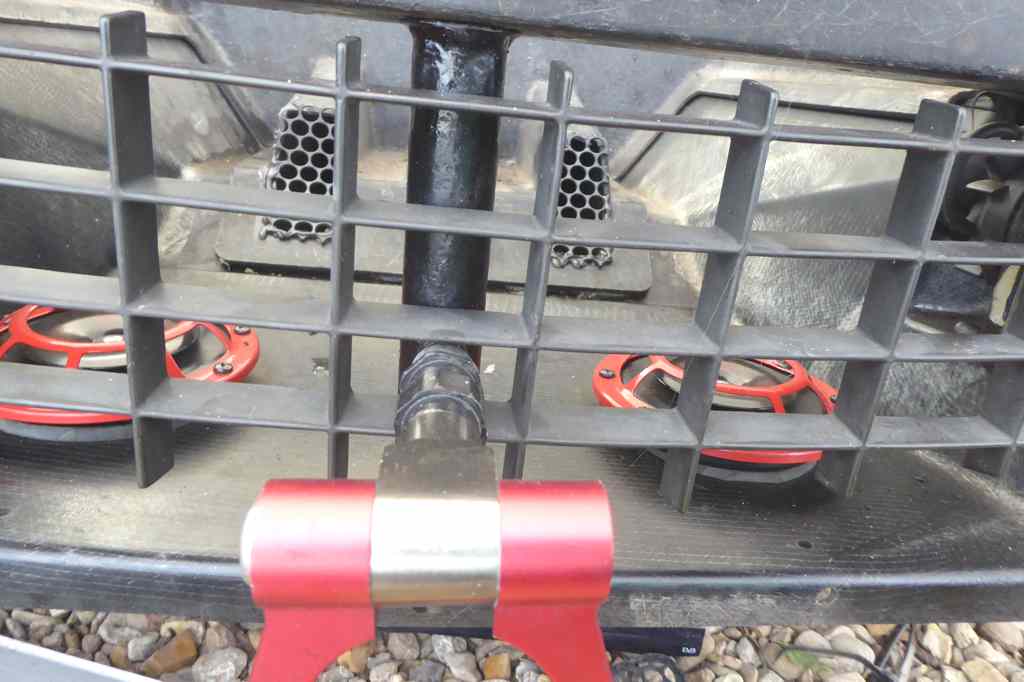

one thing I noticed, the Elise has a very weak horn and driving in Italy you can never have a too loud a horn, lucky on the Elise there are two holes in the crash box made for cars with oil coolers, well I used these two holes for two tone Hella horns, very useful  in Italy

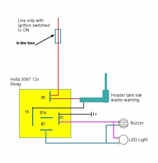

while I had the clam off I also fitted the wiring for the low coolant alarm
the testing

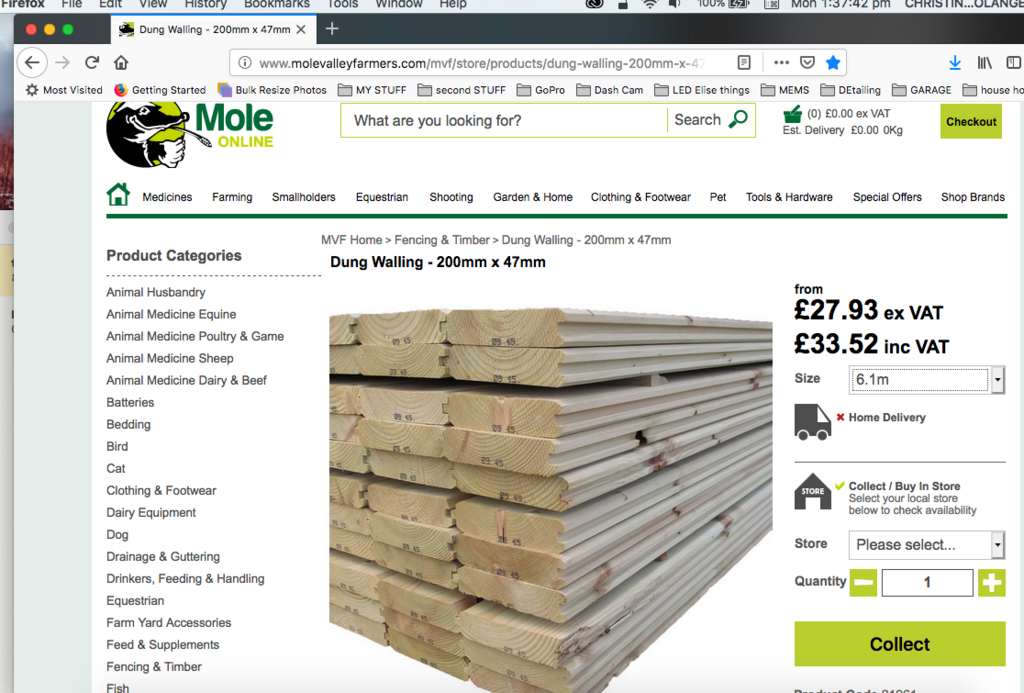

I found the timber called  Dung walling/boards
so I settled for this Dung walling, on their website they were selling them at £33.52 per 6.1M I chatted to them (while in Italy) and asking all kinds of questions about the product, the sad part was I live in north Cambridgeshire and their nearest branch that stocked this timber was in Bridgewater Somerset, so I put a hold on it till I got back to the UK

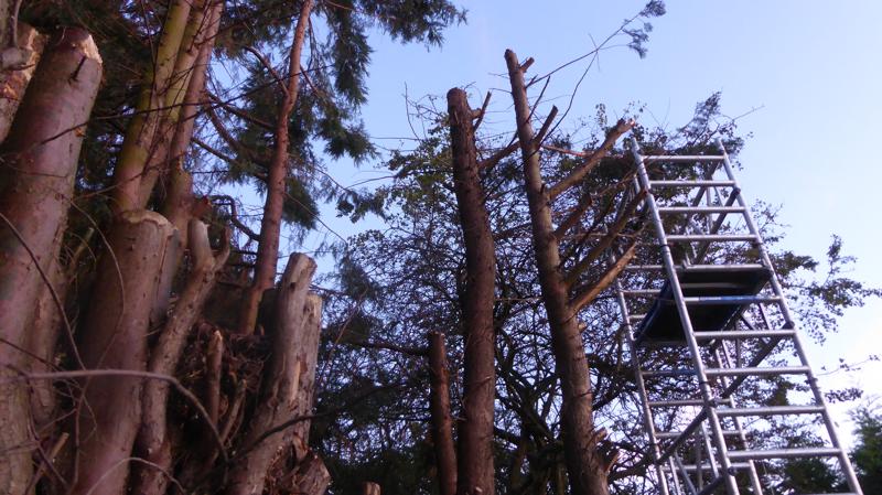

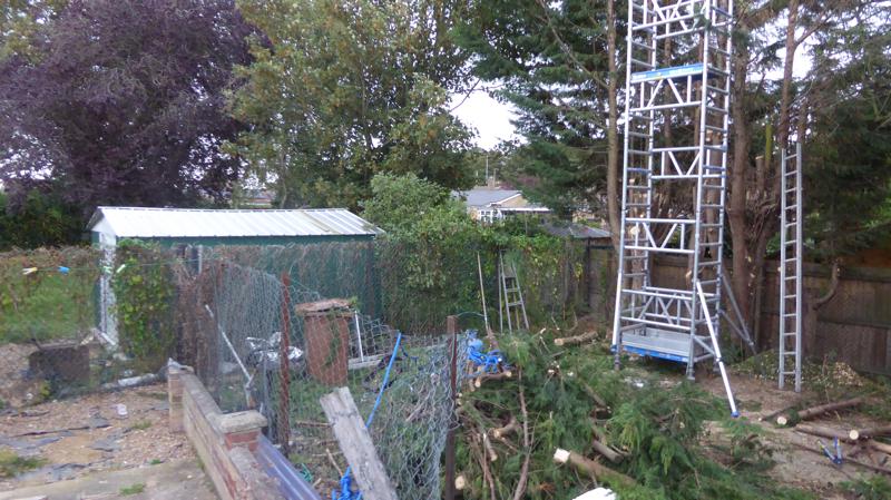

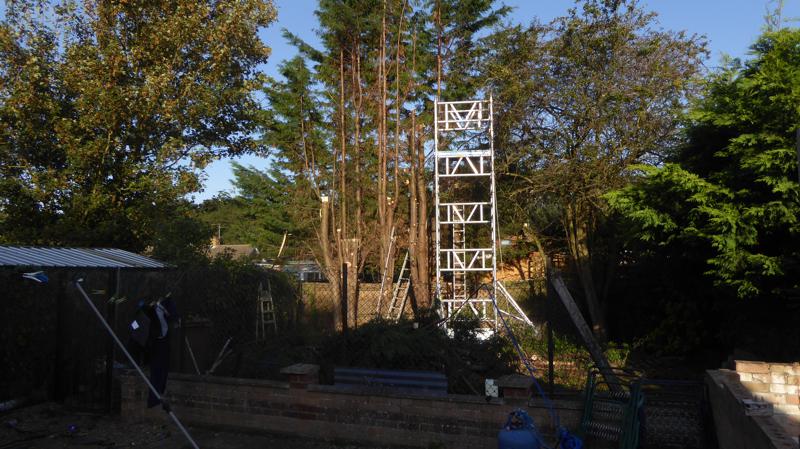

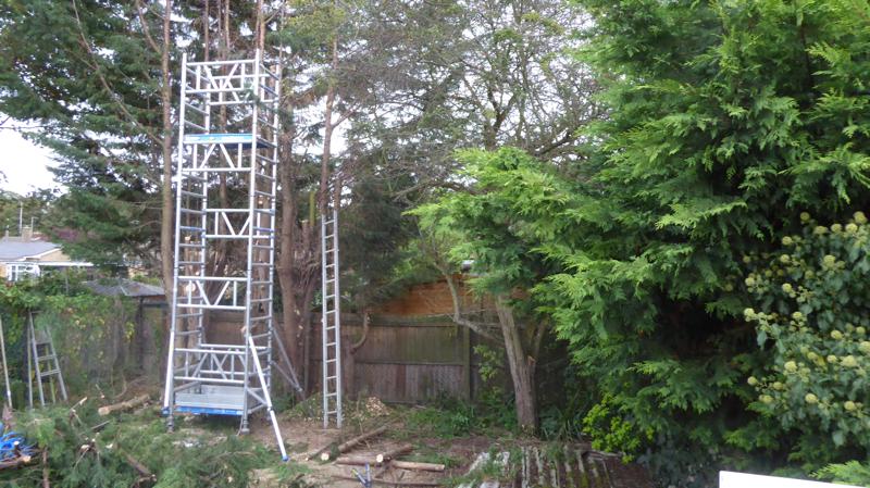

a couple of issues  our conifer trees at the side of our garden were rather large and encroaching on to the concrete pad so I hired a scaffold and up I went to trim them down
I got in some guys to take the cut timber away
till they couldn't get anymore on their pickup

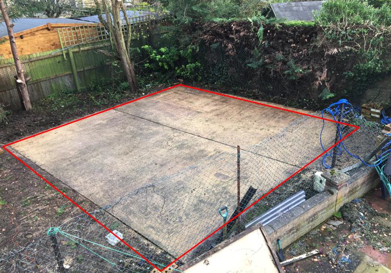

now the job of clearing up the pad

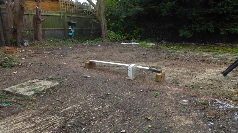

the issue I had with the pad was when I had it laid, I had it with a slope not to have standing water on it for the dogs,
how I thought I was going to over come the issue

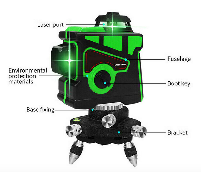

I bought myself one of those laser levels
I cleaned up the area the garage was going to cover
red line marks the area
