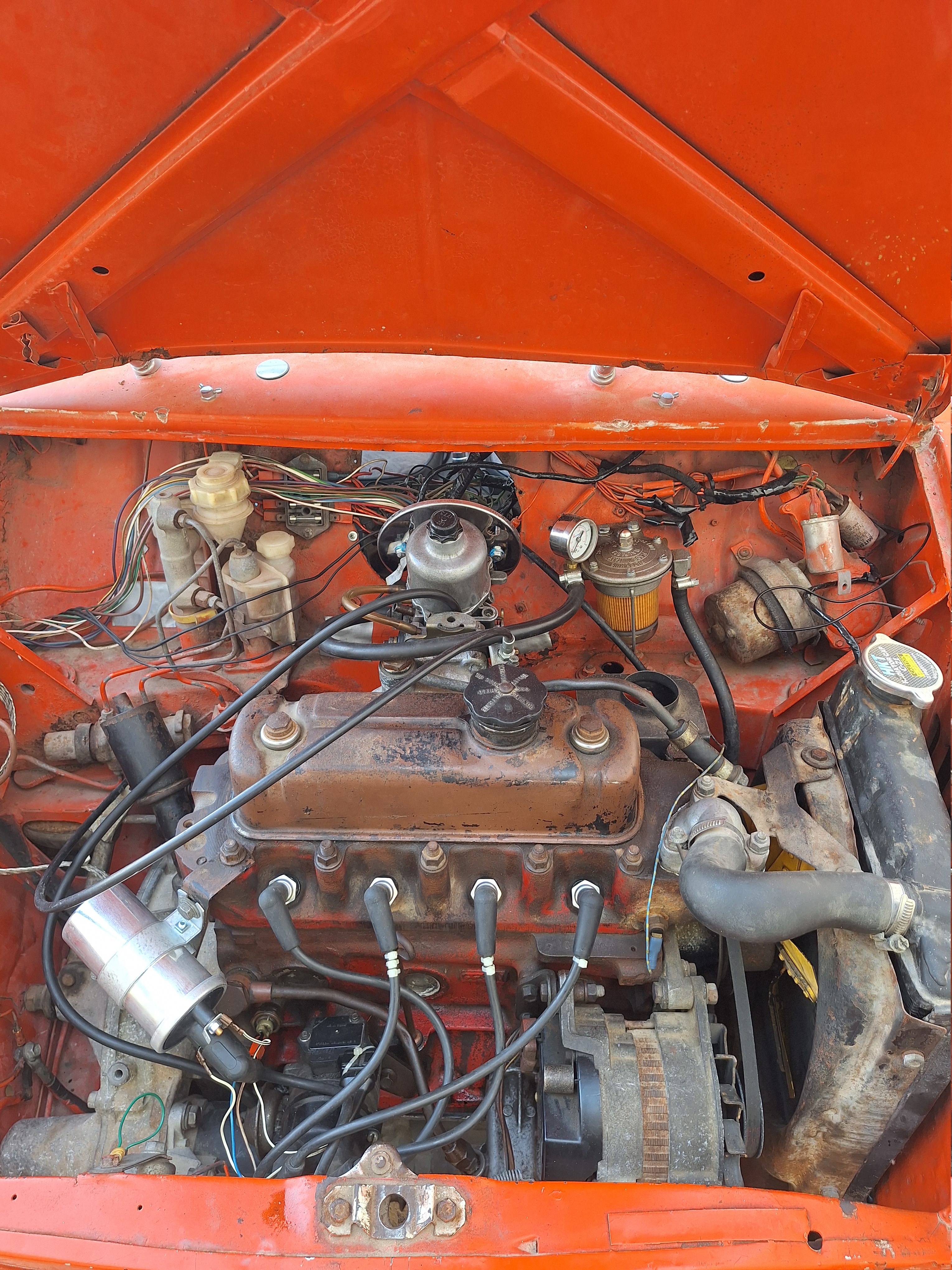

Model: Classic Mini saloon, 1275 (believed A+, engine number plate missing)
Year: Pre-1982 (pre-Verto clutch)
Photo of the engine bay attached, apologies for the state of the wiring, tidying it is on the list.
Spec as far as I can establish: SU HIF38 (plate reads FZX1414), Lucas 65DM4 electronic distributor (42664 / AUU1536) with 84896A amplifier module, negative earth, alternator, no ballast. Two open breathers, one each side. Standard cast exhaust manifold as far as I can tell. I can't confirm engine capacity, no engine number, no plate, and I haven't found casting numbers yet. Don't know what needle is in the carb either.

#2 Quinlan minor
Quinlan minor
  • 1,379 posts
  • Location: London
Posted Today, 08:35 PM
Compression tester time.
#3 colinf1
colinf1
  • 1,085 posts
  • Location: Dundalk
Posted Today, 08:56 PM
It sounds the same as my previous problem, head gasket gone between two cylinders, so no compression.
As there's already a weep present, might be time to take head off and inspect....
#4 lsto
lsto
  • 722 posts
  • Location: Essex
Posted Today, 09:27 PM
Generally if it has 2 crankcase breathers fitted it's a 1275. This photo looks like an a+ to me. Check if it has tappet chest covers. If it does it's a small bore, if not it's a 1275.
It's hard to tell but it looks like the breather port on your carb is open, if so block it off as it will be causing a massive air leak which may be your problem.
Edited by lsto, Today, 09:42 PM.
#5 lsto
lsto
  • 722 posts
  • Location: Essex
Posted Today, 09:33 PM
I think this is your breather port, block it off and try again. Ideally it should be piped up to your crankcase breathers.
Good luck
#6 Earwax
Earwax
  • 605 posts
  • Location: Brisbane
Posted Today, 09:59 PM
Hi
Just a couple of checks you may as well try   as well as compression test
Re Hif38 hoses   .... have you got your float overflow connecting to the crankcase breather return?   (possible overfuelling)
 I would 'start' with float overflow tubed down to the ground ( just to avoid petrol hitting hot engine) and I would cap the Crankcase breather   See Calver ST as example  here
I would also verify at the carb inlet that fuel is pumping ( pop it off for a second whilst someone turns fuel pump on / cranks) ... I do like the Malpassi filter king but I have seen weird sorts of float bowl full to float bowl empty type behaviours which have stopped after temporarily bypassing the filter.
I would also leave the fuel cap off to see if it makes a difference ( venting not working and builds pressure against the pump)
I would throw a different set of plugs at it after you are sure no overfueling is occurring.
On another To Do list ( you may or may not get around to ) It appears as if the engine has been strap lifted - dents in front hard oil pipe and rear carb warming tube - just FYI really
