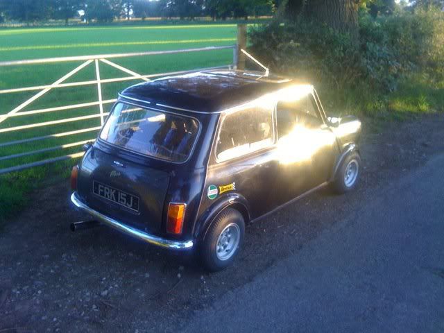

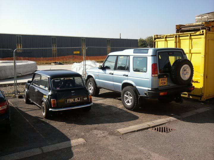

But, here she is from the last time I took piccies of her:
She no longer has the chrome gutter trim, as that came off at about 90 one day, oops. But other than that she's OK, just a bit tatty in the body work (but she is over 40 now).

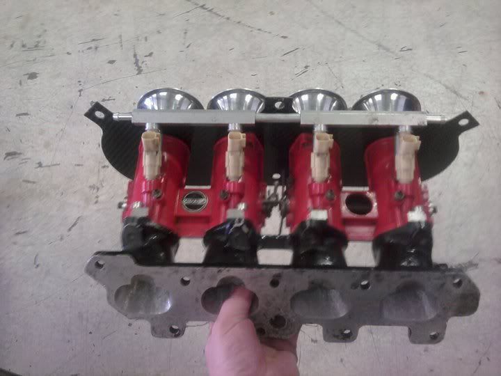

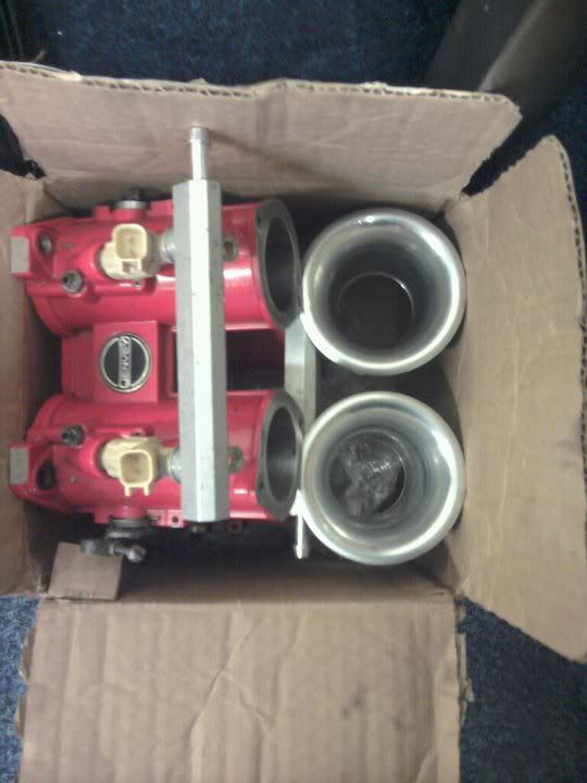

More details:
I put these on it:
BWAAAAAAAAAARPPPPP!

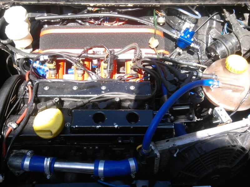

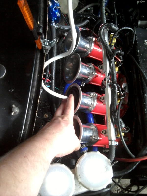

Oh, then I balanced the TBs using an old Gunsons Carbalance dealy.
I've put a Canems ECU in it anorl, which I actually think is grrrrrrrrrrrrreat, got loads of option. I also put a wideband lambda sensor in it and a Techedge 2J2 controller for schtuff and giggles.
Theeeeeeeeen, I started mapping it.

And mapping it, balancing it, mapping it, balancing it, mapping it.......
Something not right, not at all.... compression test carried out on freshly built engine.........
Oooopsies
Cylinder 1 was 16 bar
Cylinder 2 was about 13 bar
Cylinder 3 was about 10 bar
Cylinder 4 was just under 8 bar.
Ooopsies, the engine workshop (that is now no longer trading) had a bit of an incident with skimming the block, so out came the rebuilt C16XE, and in went a 55k mile X16XE bottom end.....
And then:
Bit better sounding, so more balancing and mapping and stuff required.........tedious! :lol:

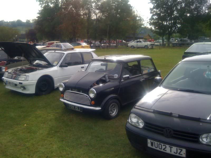

Posted 04 September 2011 - 09:13 PM
Love the 10" GB's :wub:
Uhh, kinda got a picture at rrg :crazy:
Spent a lot of time watching the track action and rushed looking at the show cars a bit, and I seem to subconsciously skip over minis at mixed show as I see so many everywhere else :shy:
Mine was right at the bottom of the field with the 12" Gb/Cosmic combo :P
DSC_8474 by DanBewsey, on Flickr
