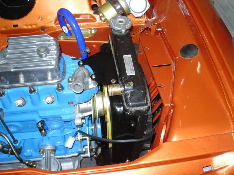

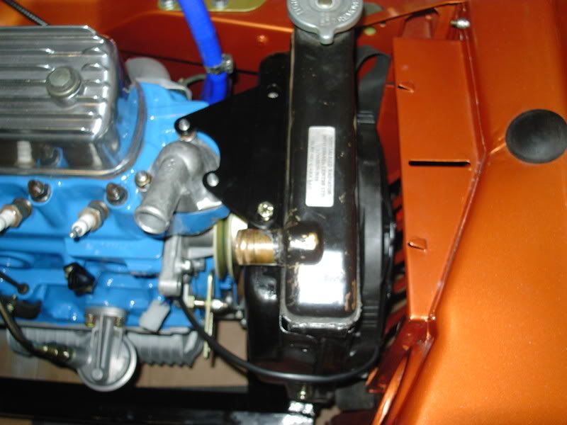

Posted 17 December 2006 - 11:26 PM
He we go afew pics.

Posted 17 December 2006 - 11:48 PM
hey fitment wise that looks about the same as the turbo clubby that we had in our place, jsut got to make yourself an extended bit of shrouding so the hot air actually gets sent out the wing and not sucked back in!!

Posted 18 December 2006 - 08:26 AM
In one of the photos you can just see the rubber surrond that goes around the fan housing ,the fan is only tempery In at the mo. I am just getting the idea how it all goes together.
