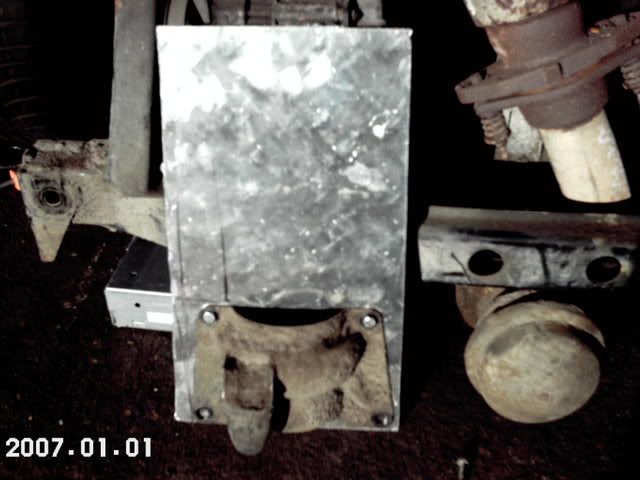

Does anybody have the dimensions for the Watson plate for bolting the Metro frame to a mini
Cheers
Paul

Posted 04 January 2007 - 10:36 AM
Cheers
Paul
'tis pretty easy to work out paul and make your own :w00t: if you have a subframe and a bit of sheet metal, you can measure and mark out the bolt holes for the subframe and likewise for the 4 bolts in the shell. make a template with cardboard, use thin metal to practice on if need be....... heres how i went about it. finished now tho so was a tydied up when i was happy with it
