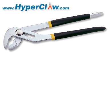

http://www.hyperclaw...er_pump_4_L.jpg
If you're rebuilding them anyway, I agree, wrench them out. If there's any chance the pistons are still good, use C-clamps to limit the piston motion and "blow" them out a little bit at a time as mentioned above. Another method I've knows people to use is to adapt a grease (Zirk) fitting to fit the bleed nipple hole. Then you use a grease gun to pump the calipers full of grease until you blow the pistons out. Very powerful, very messy.
