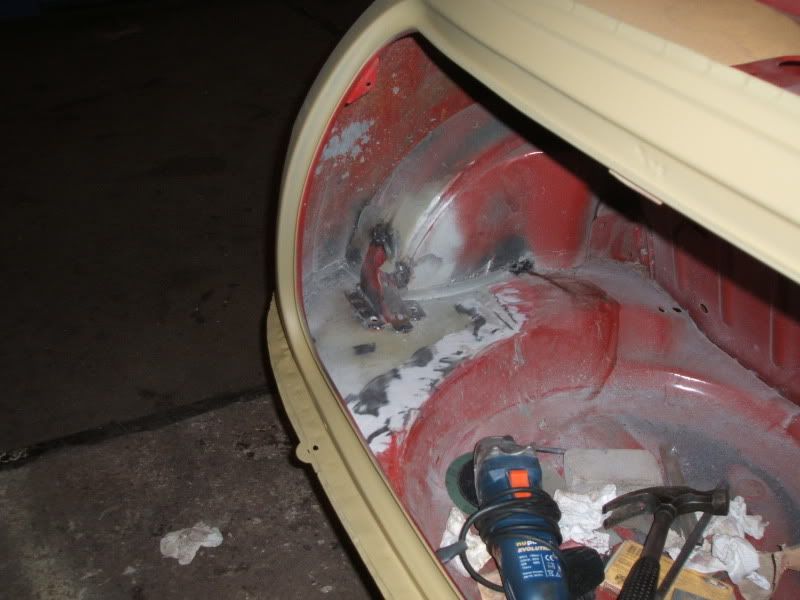

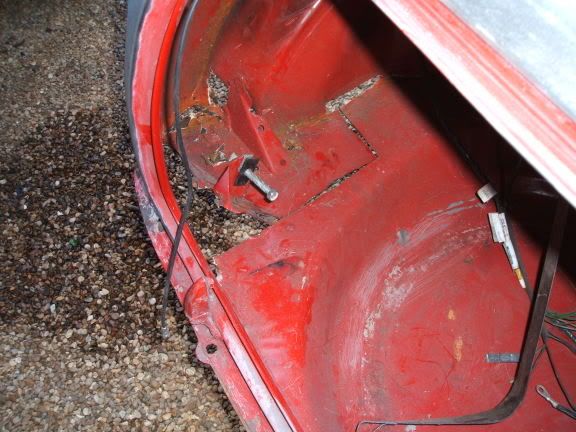

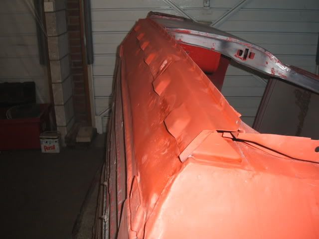

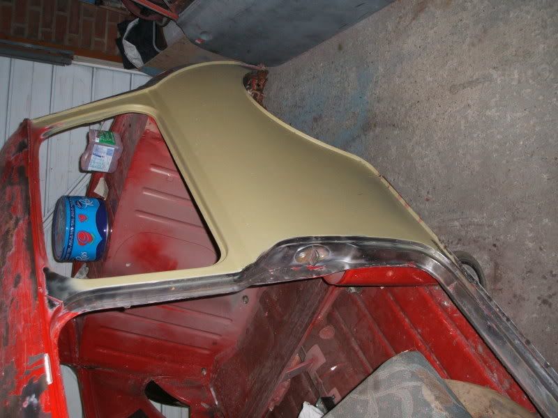

Starting the repair work

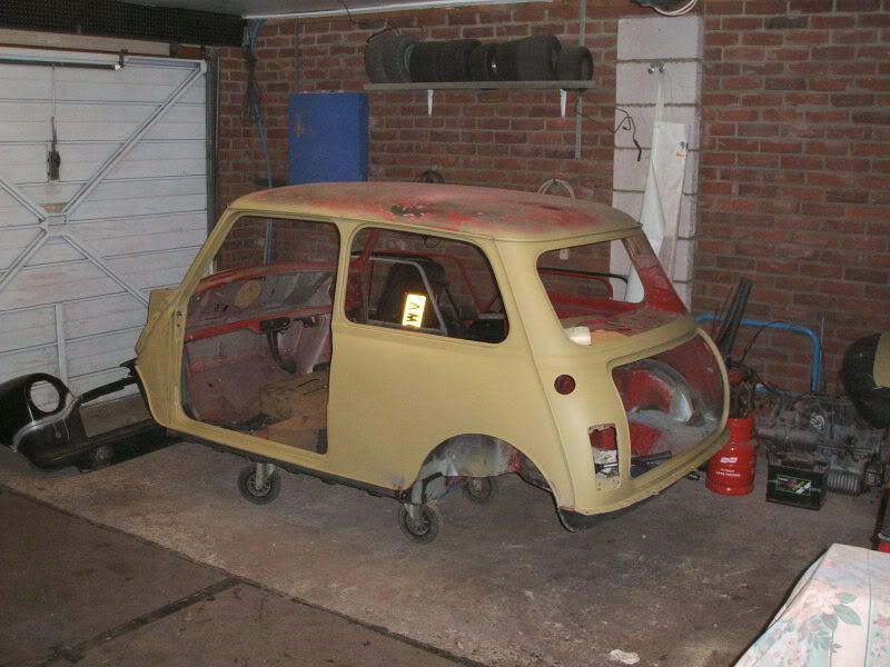

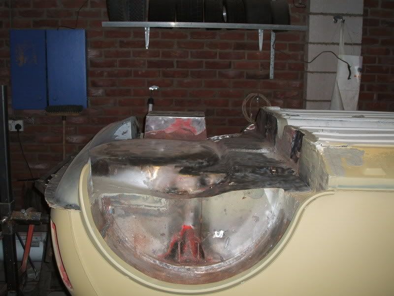

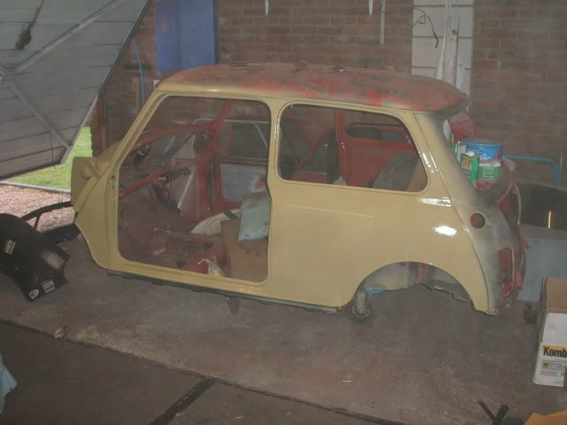

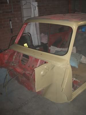

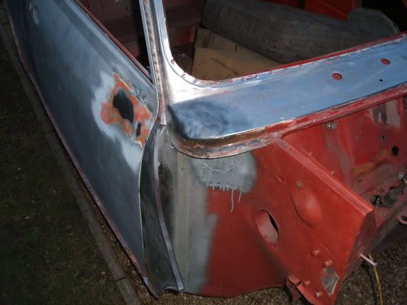

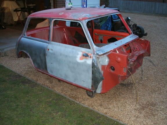

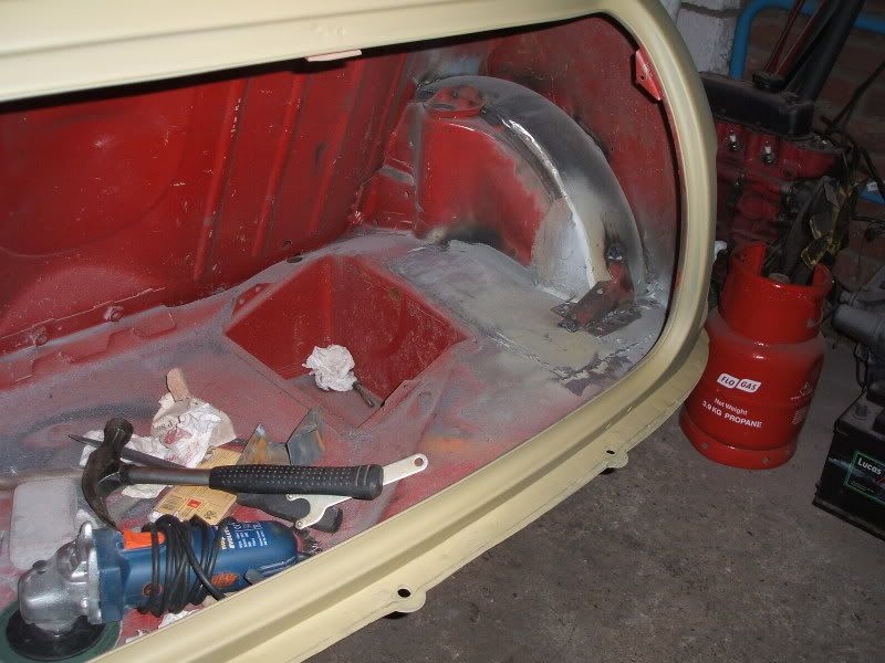

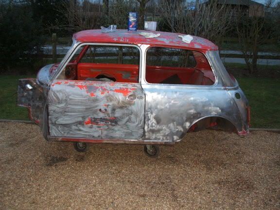

Stripping to bare metal

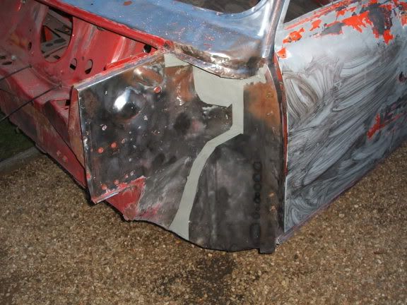

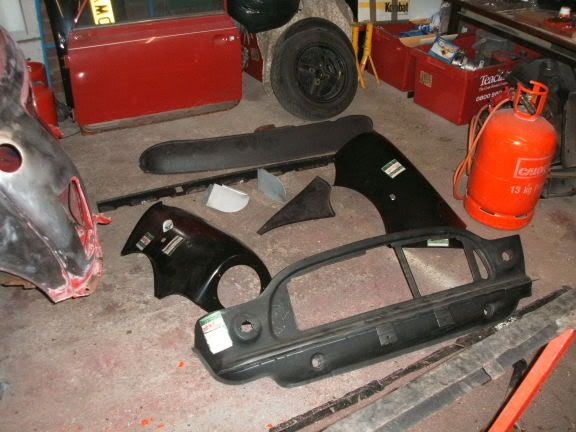

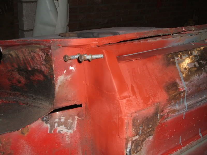

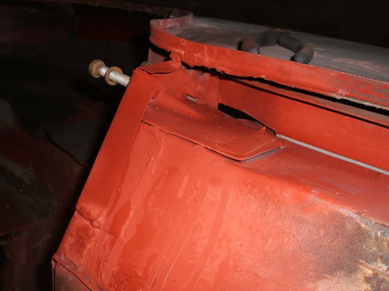

The new panels for the removeable front
Another section to be replaced
Front end tacked up

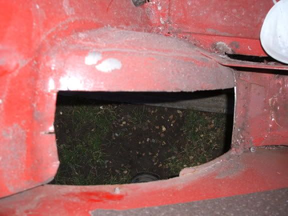

Another hole

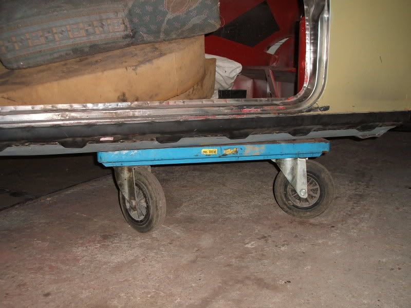

New sill
New flitch/inner wing

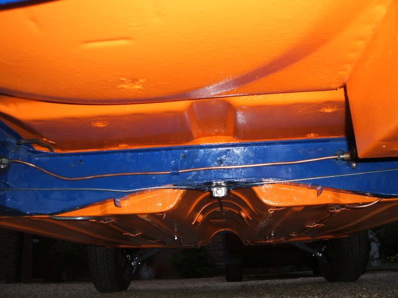

Posted 05 March 2007 - 10:39 AM

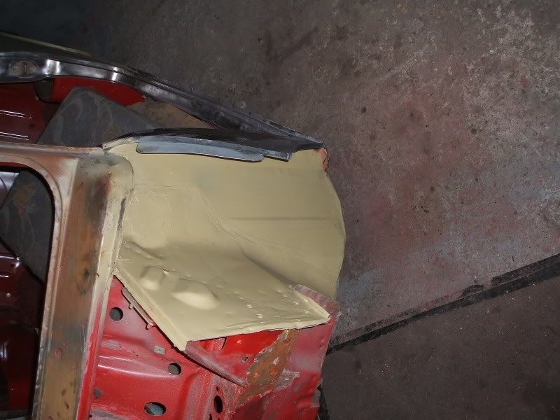

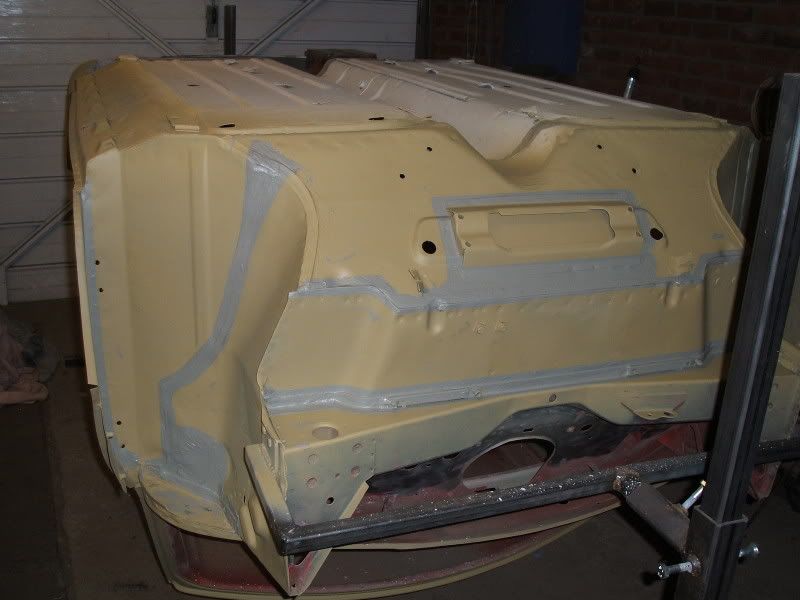

Bare metaled and then etched primered
Boot corners replaced

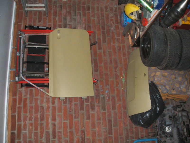

Door and bootlid bare metaled and etch primered

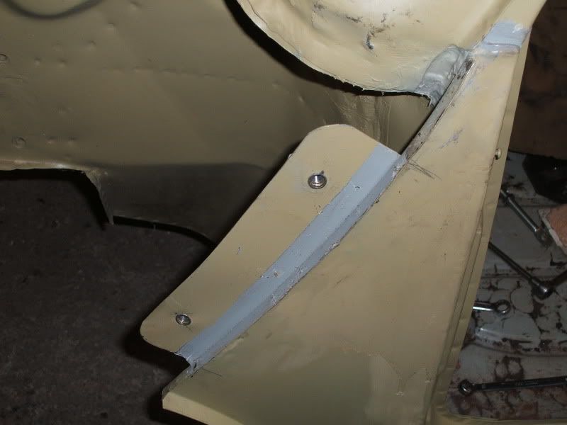

Removable front fixing point, with rivnuts

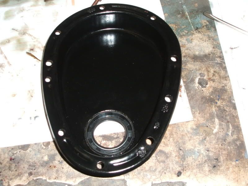

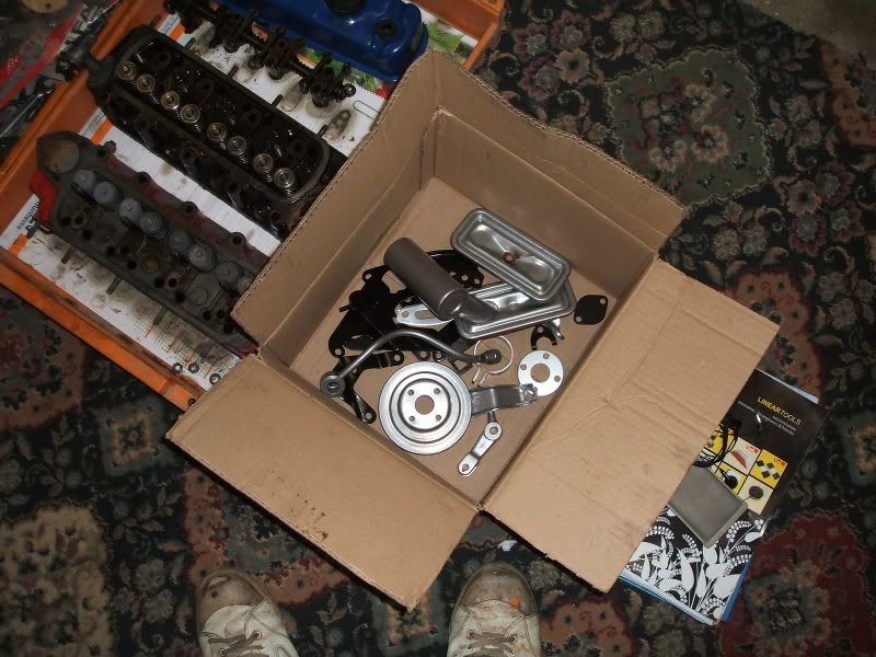

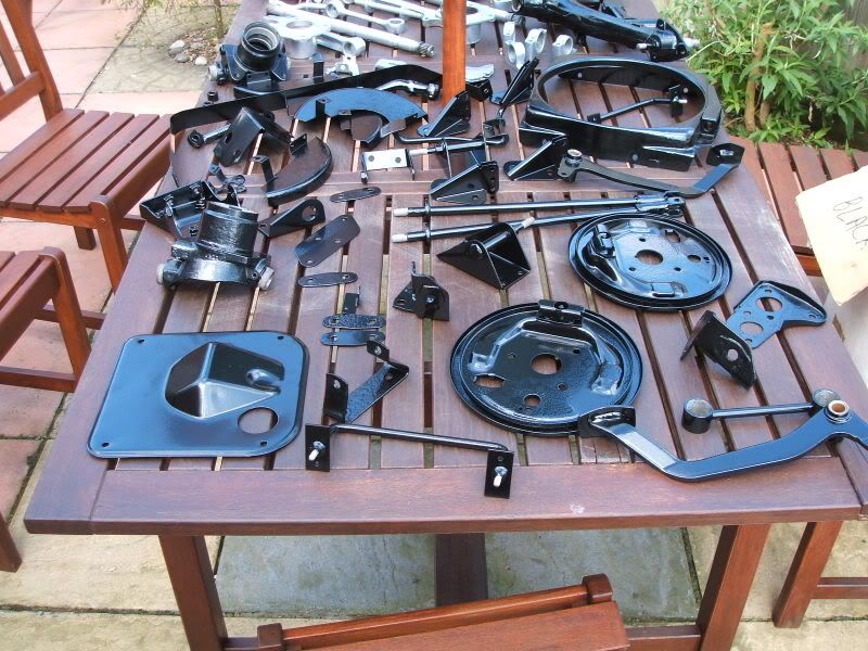

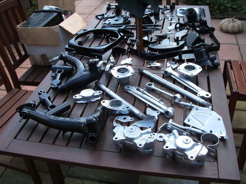

Lots and lots of bits that i had powdercoated

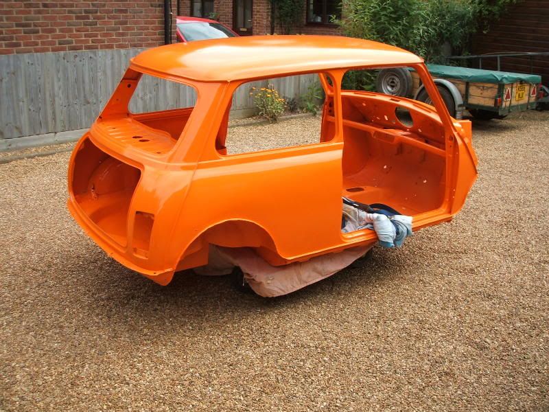

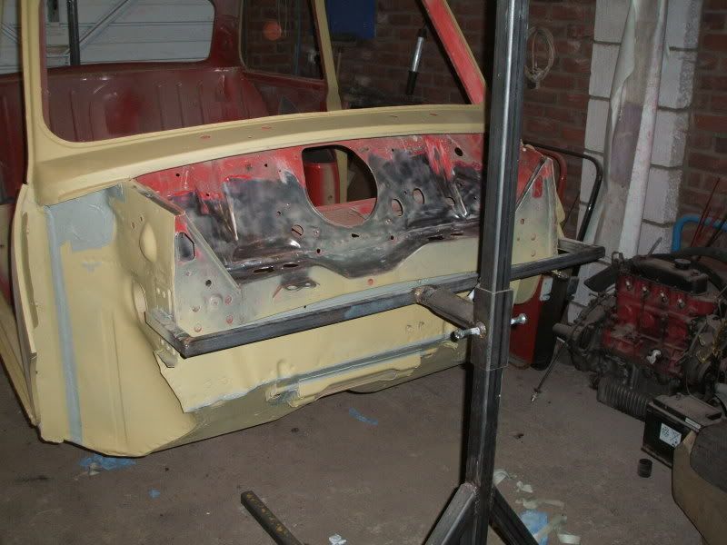

On the shell twirler i made

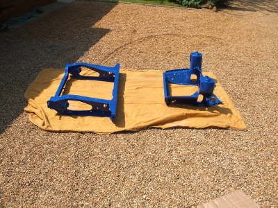

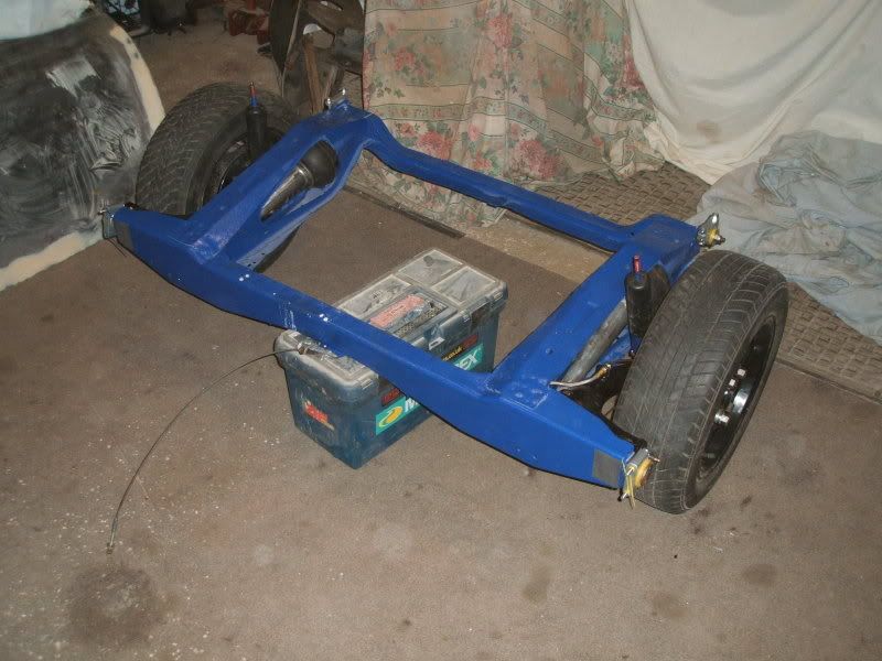

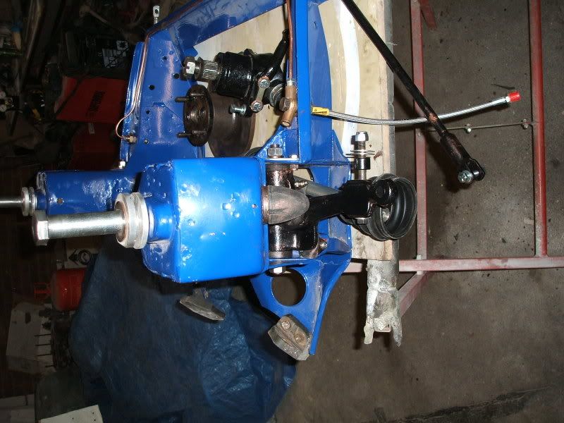

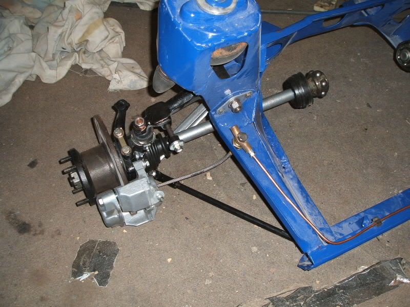

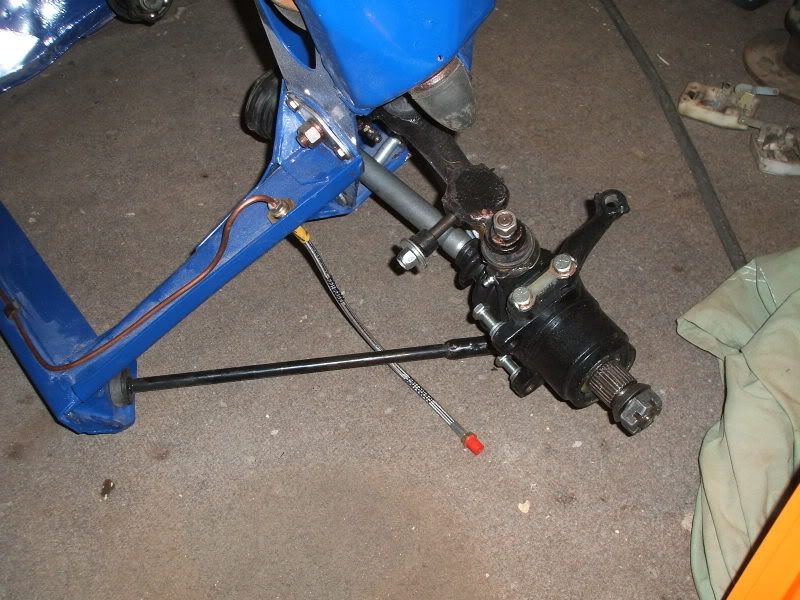

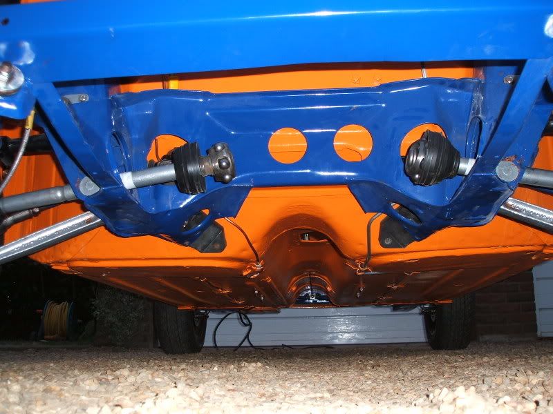

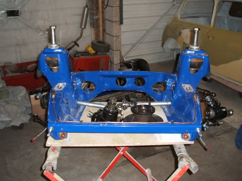

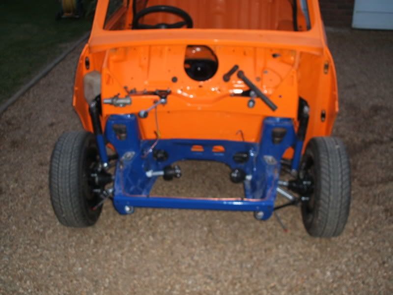

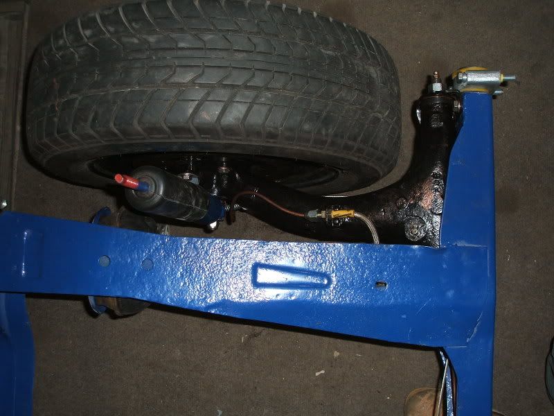

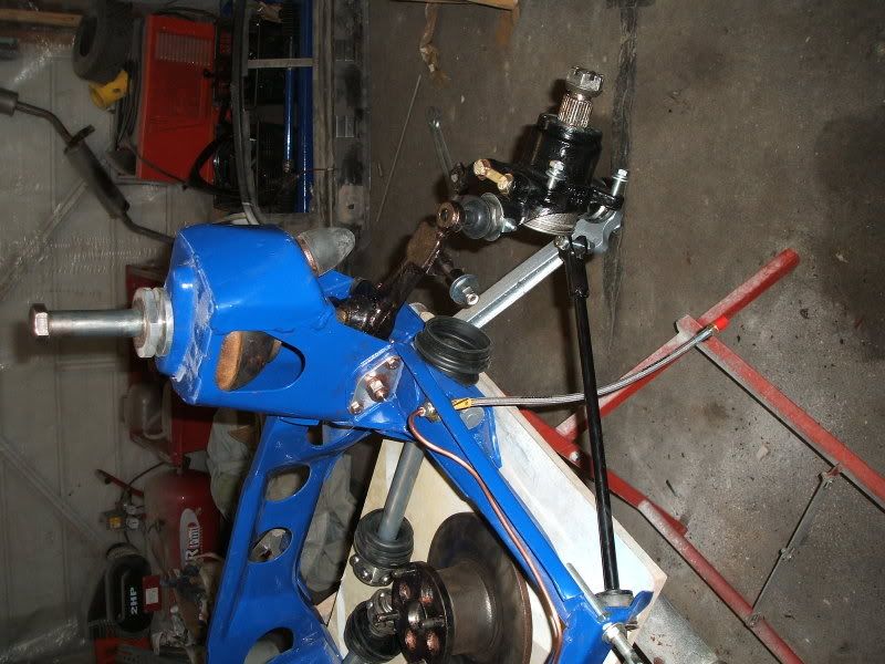

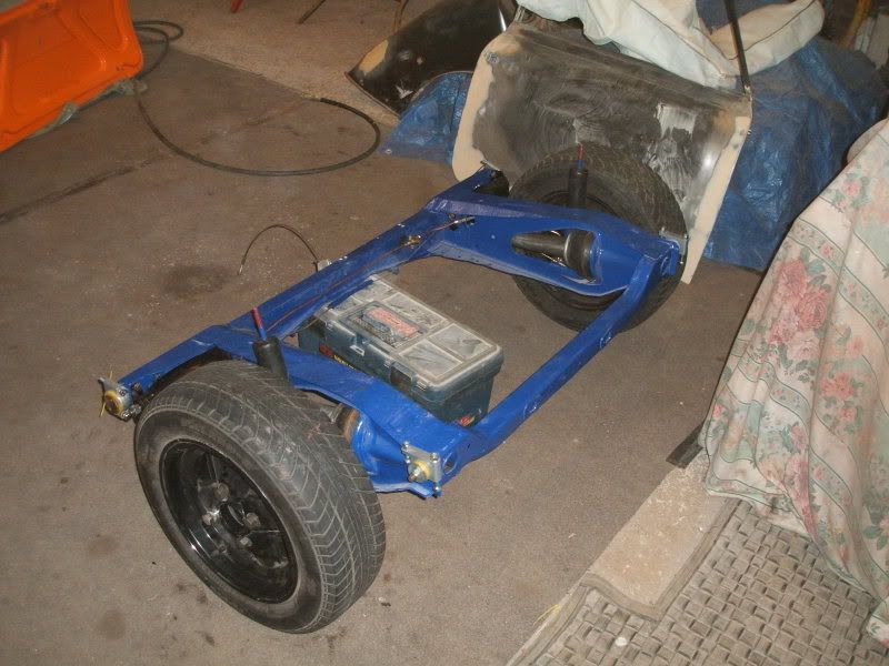

Rebuilding subframes

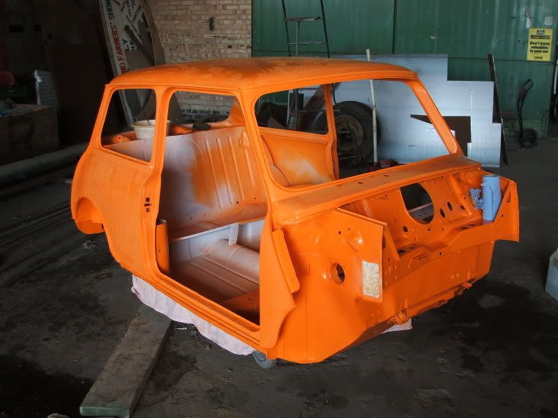

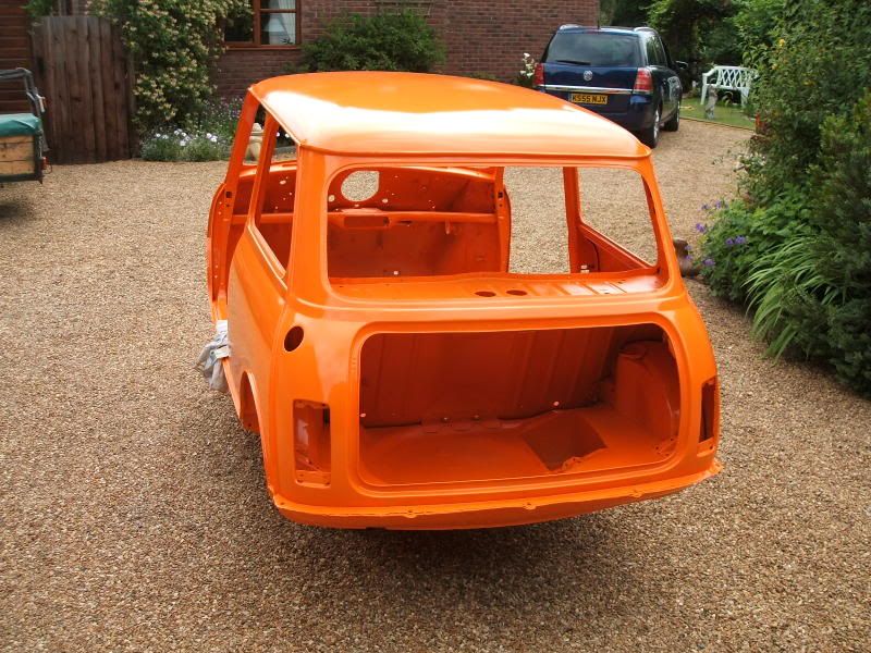

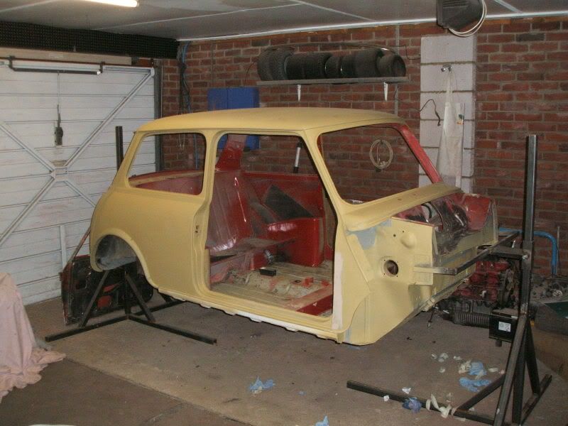

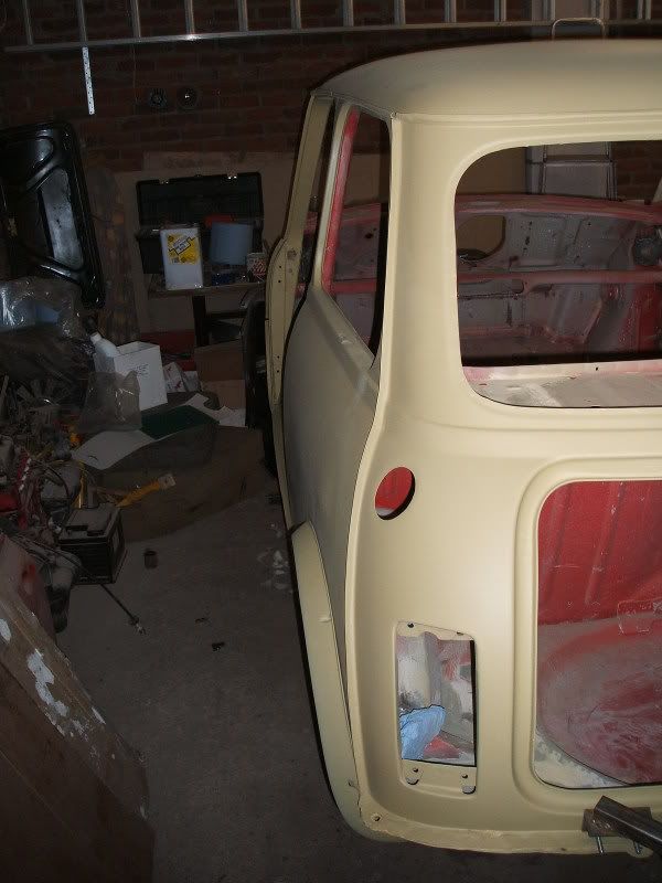

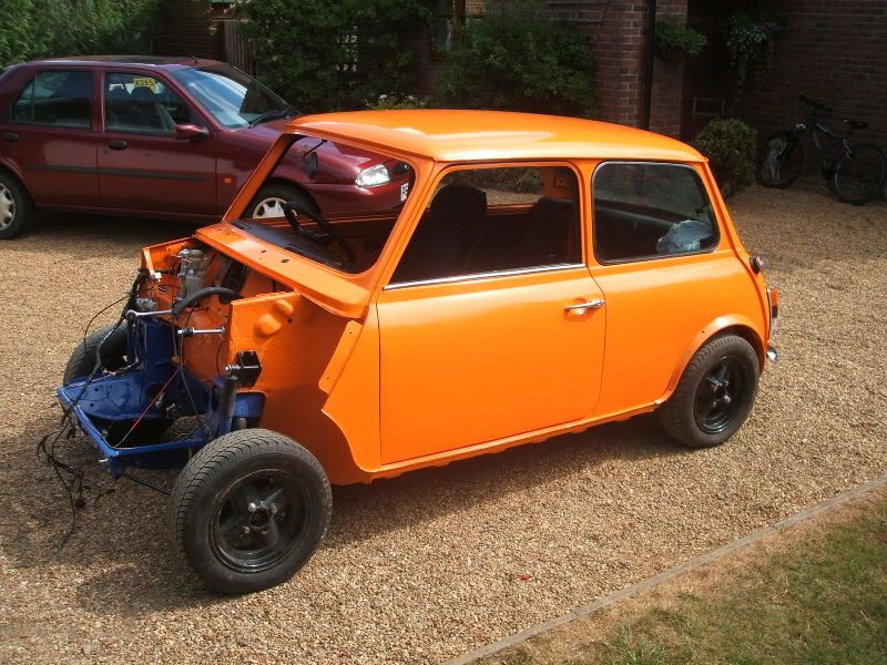

Let the painting commence
Painted

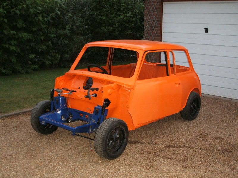

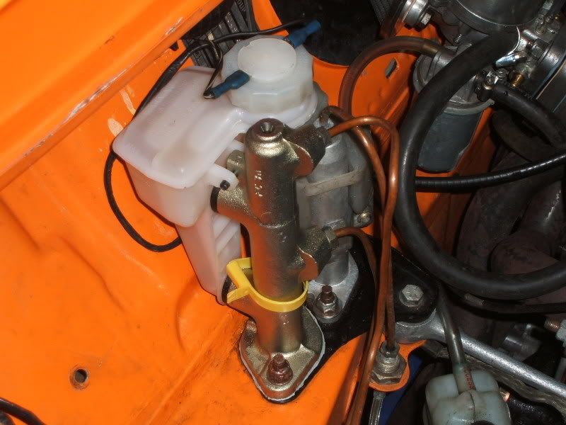

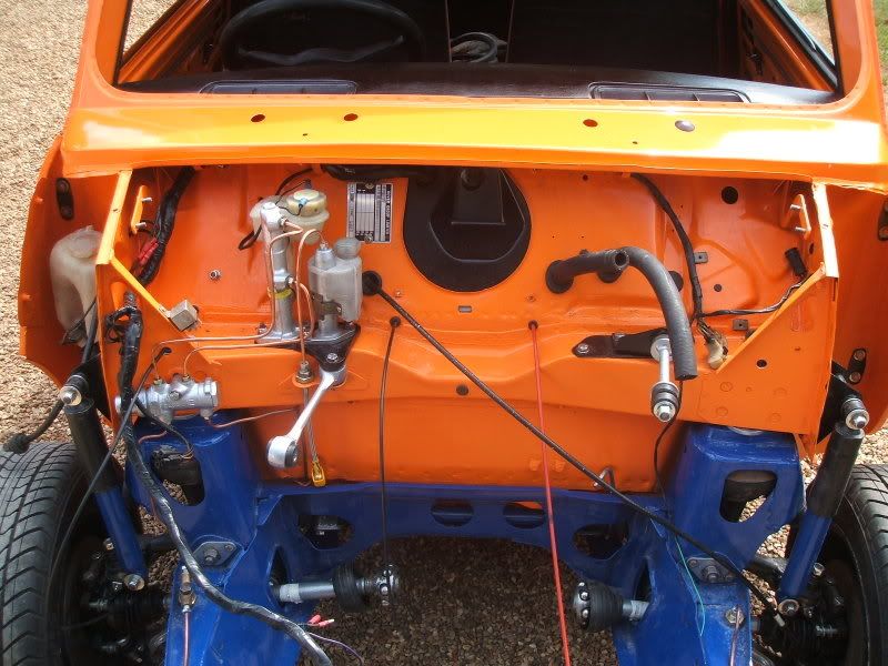

Let the assembly begin

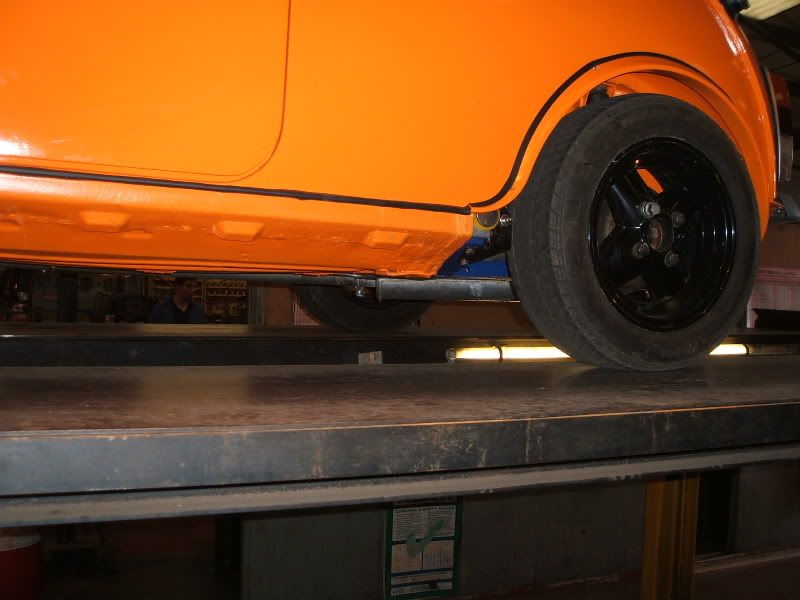

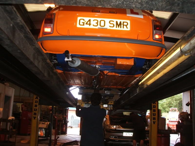

Posted 05 March 2007 - 10:49 AM

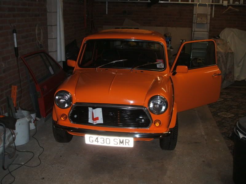

Engine going in
Mot day (passed with flying colours)

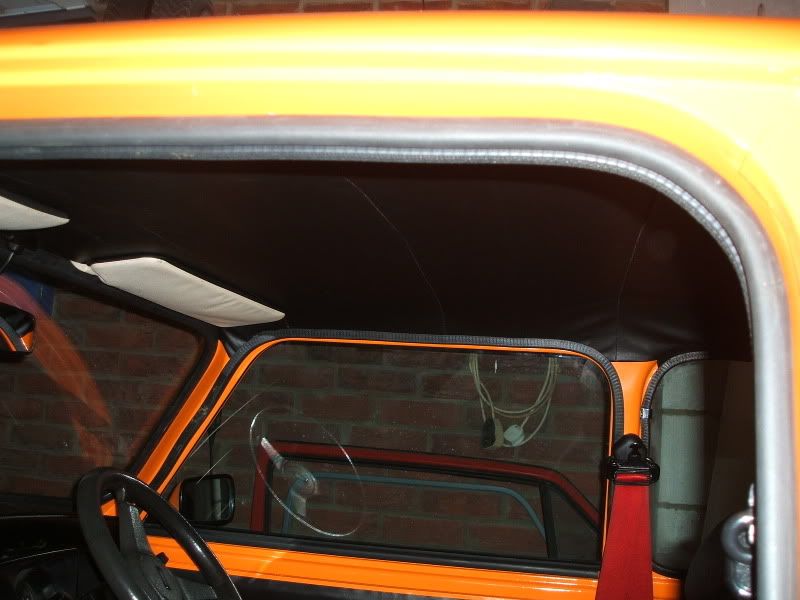

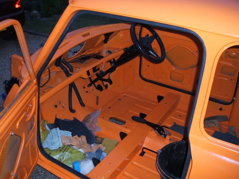

New black headlining

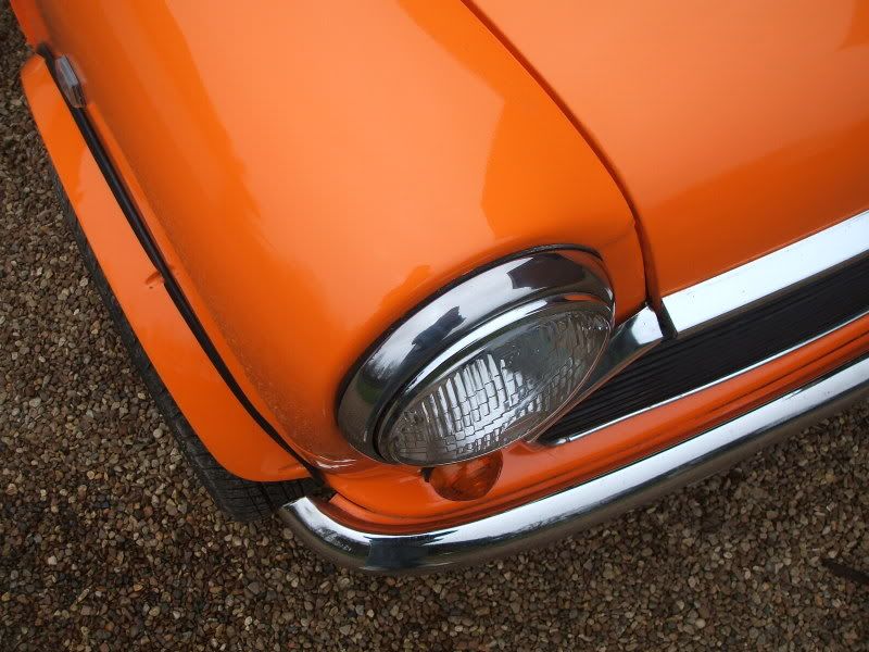

New genuine S/S bumpers

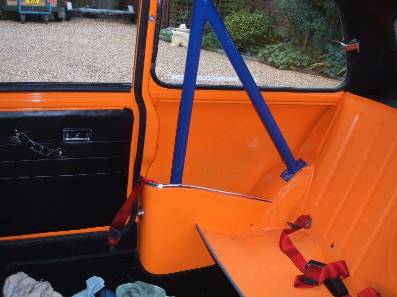

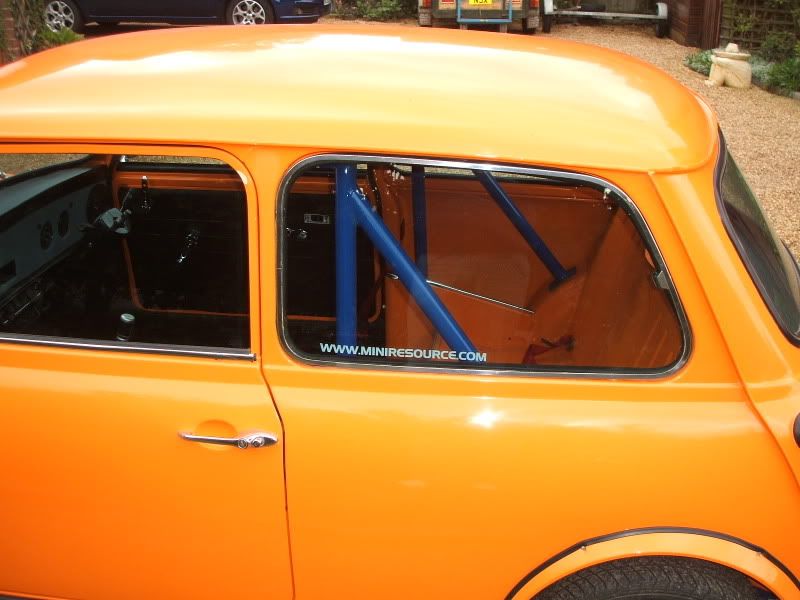

Decided to fit a safety devices rear cage

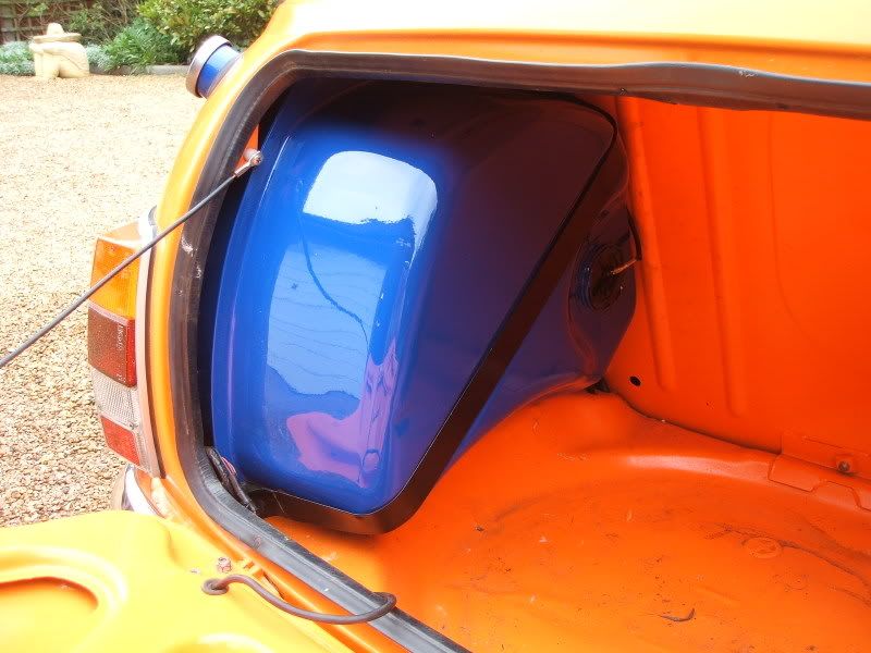

Tarted up rocker cover and fuel tank

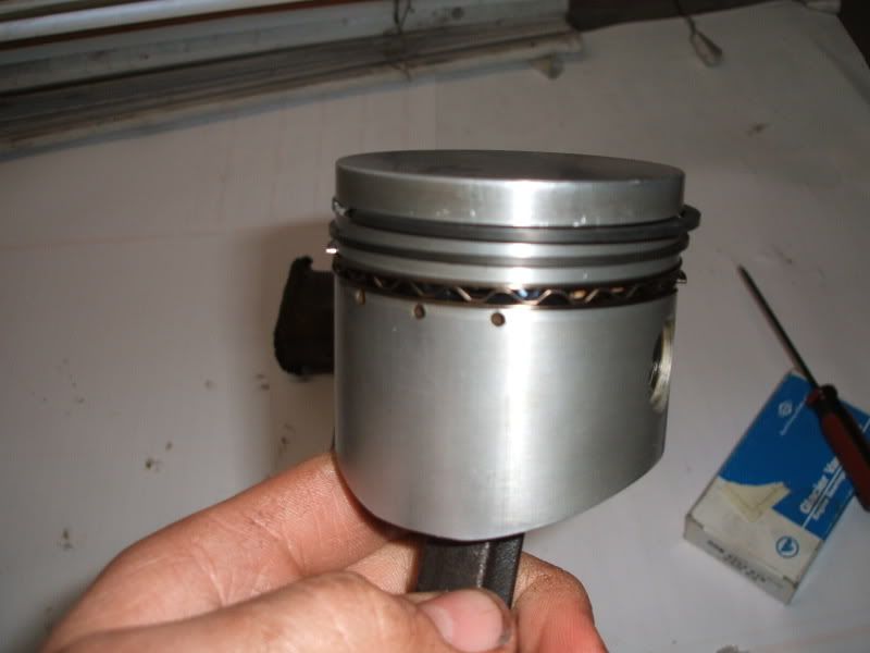

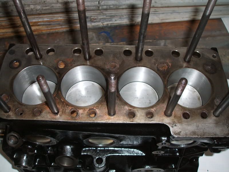

Posted 05 March 2007 - 10:58 AM

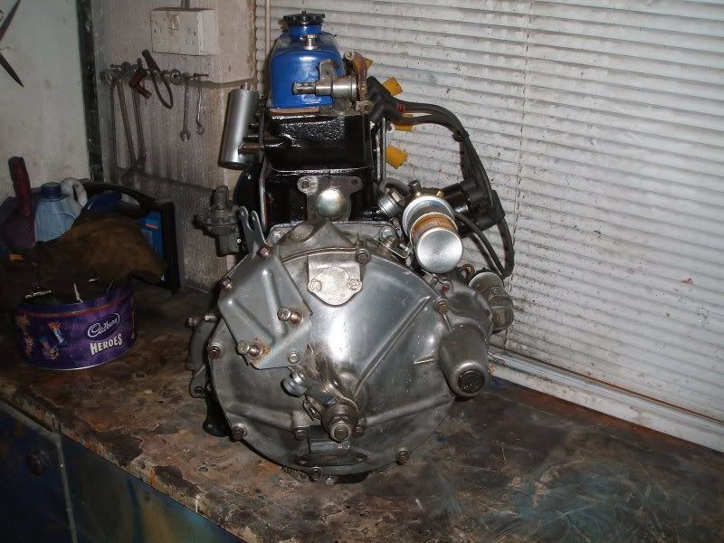

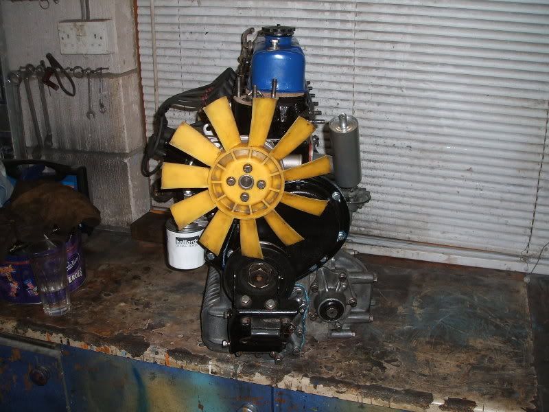

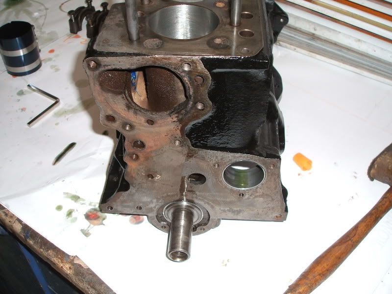

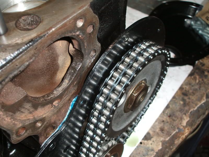

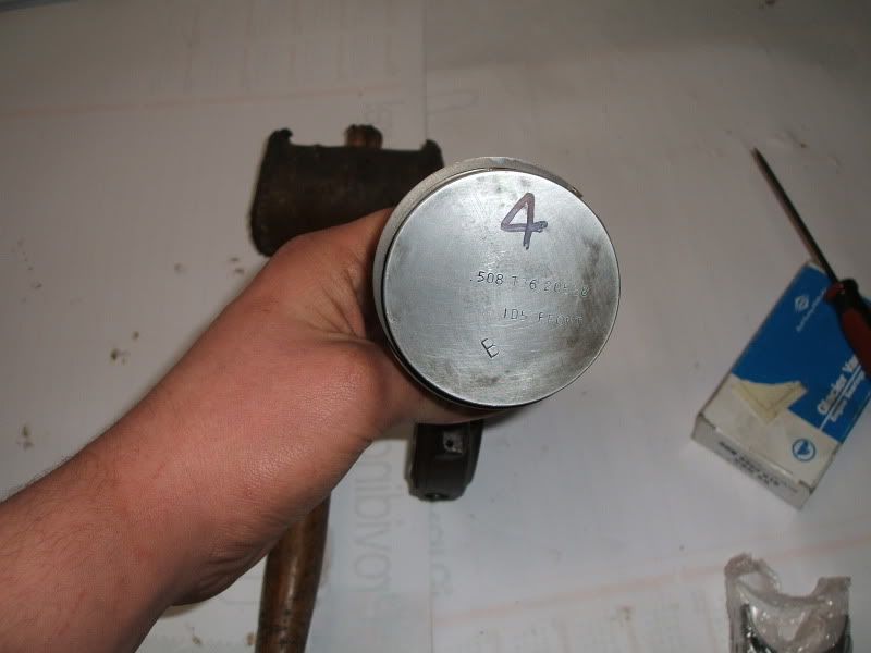

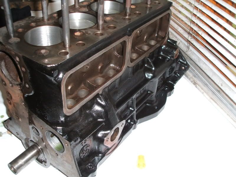

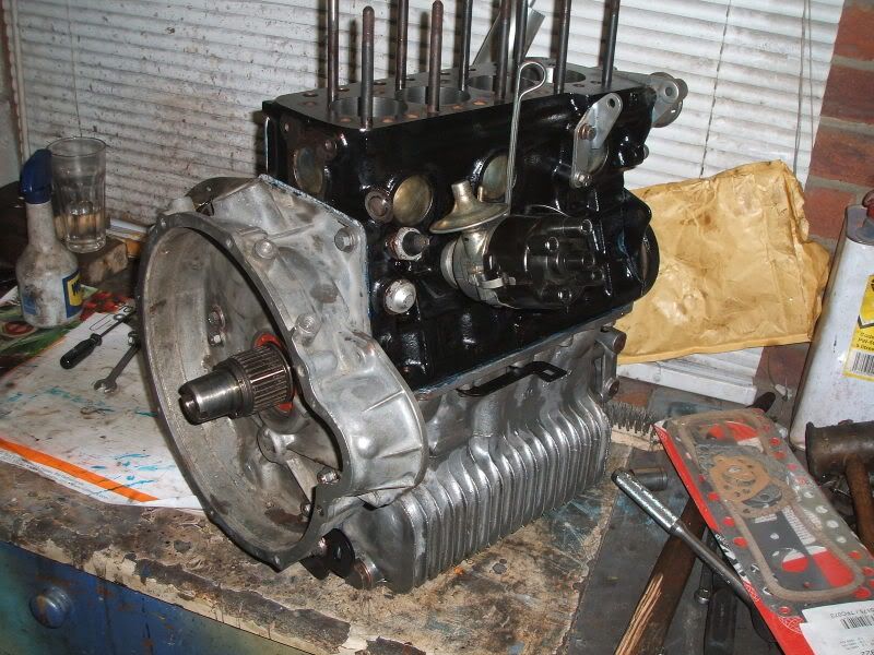

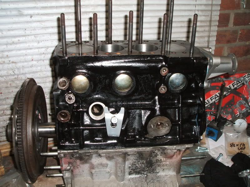

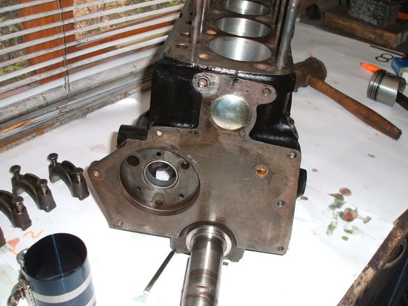

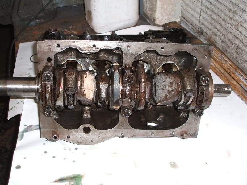

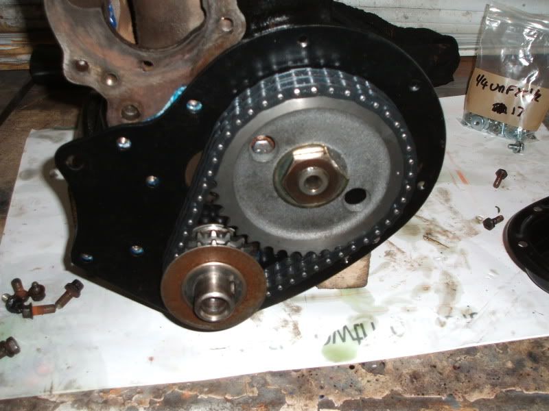

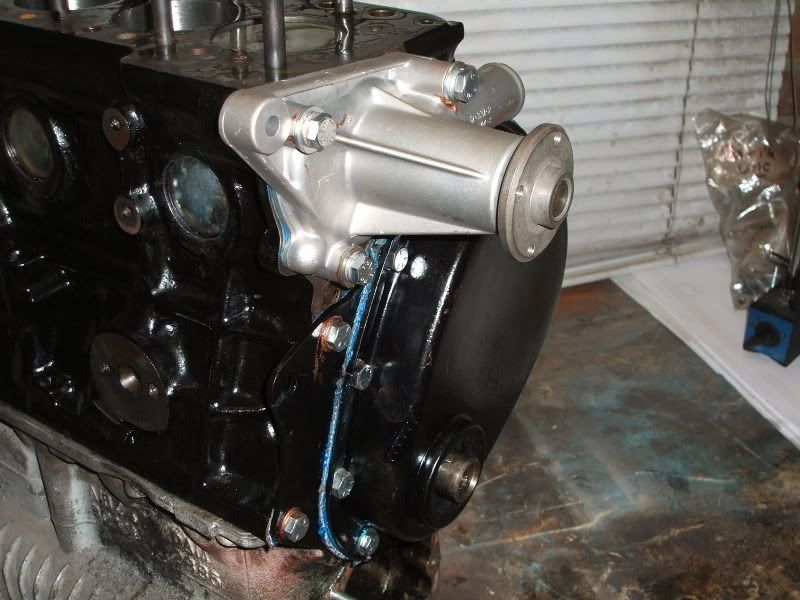

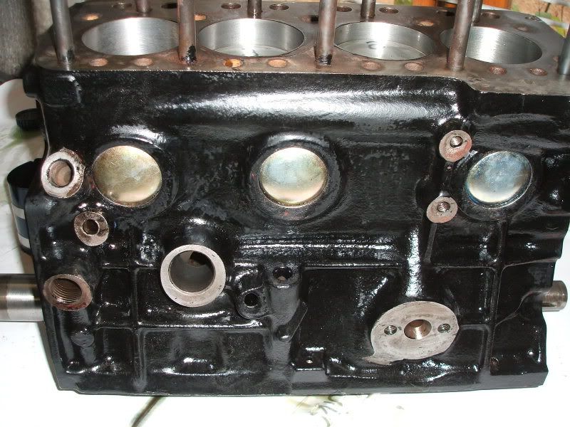

Engine rebuild (due to it playing my up with a dadgey second gear, and a worn out cam chain)

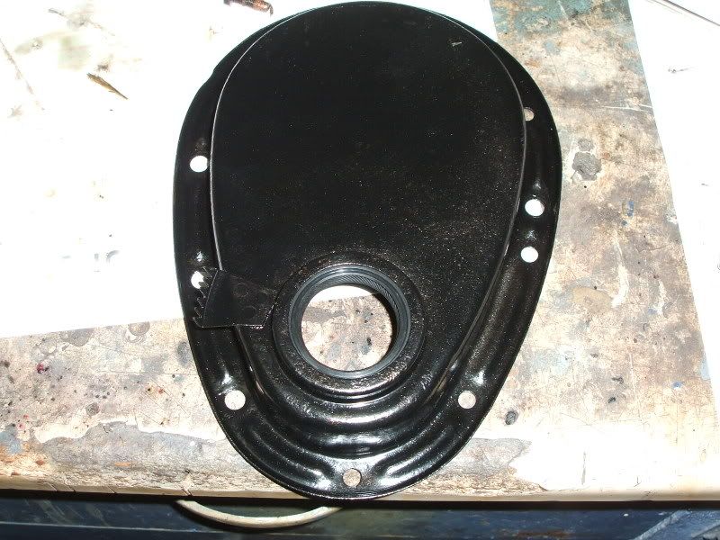

Went mad and powdercoated lots of bits off the engine

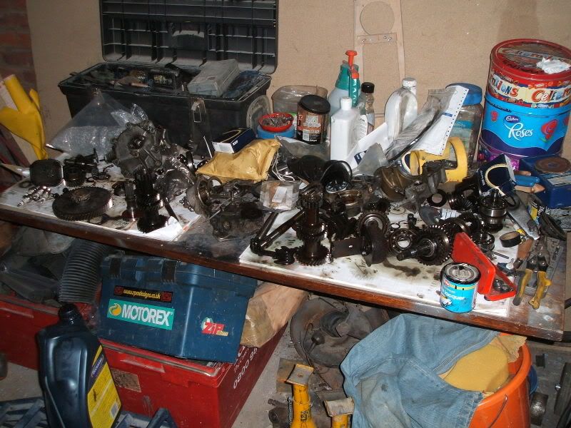

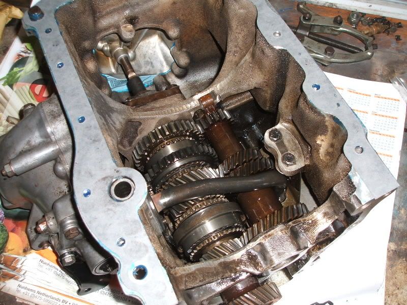

Lots of gearbox bits
The rebuilt box (new bearings, bualkrings, seals, rebuilt diff, minispares competition diff pin)
Edited by advantage998, 05 March 2007 - 11:03 AM.

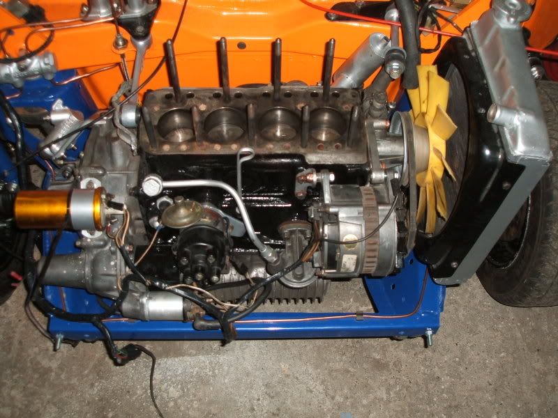

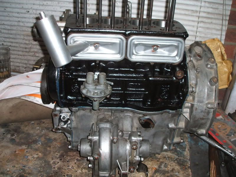

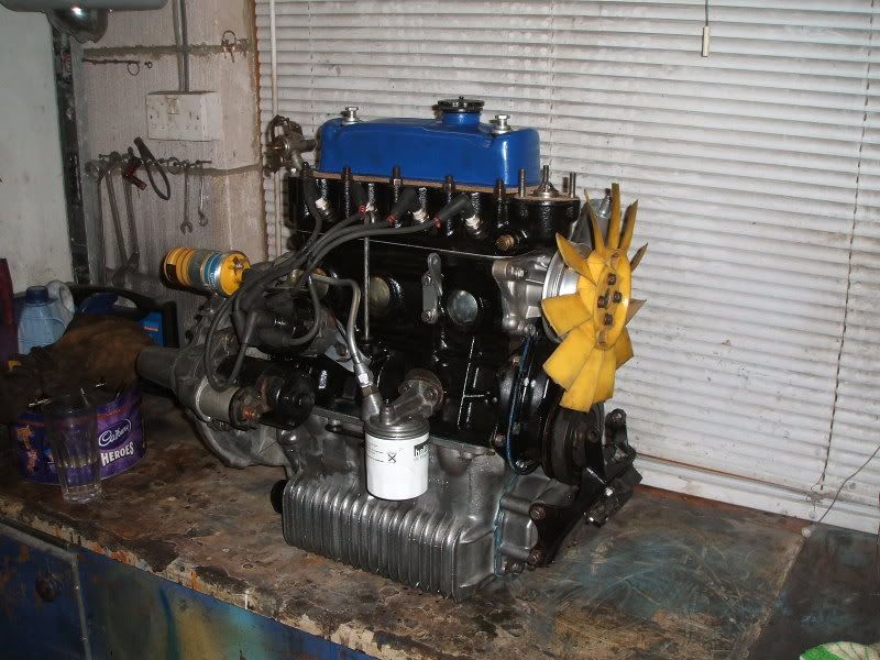

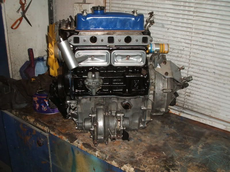

Engine on box

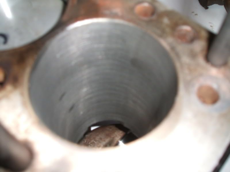

The head (ported 12g202, double valve springs)

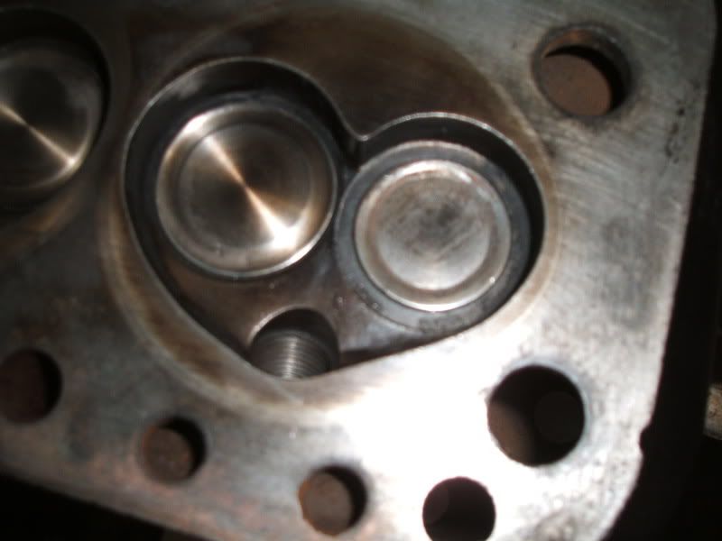

Ready to drop back in the car

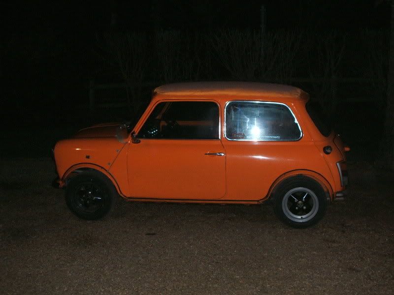

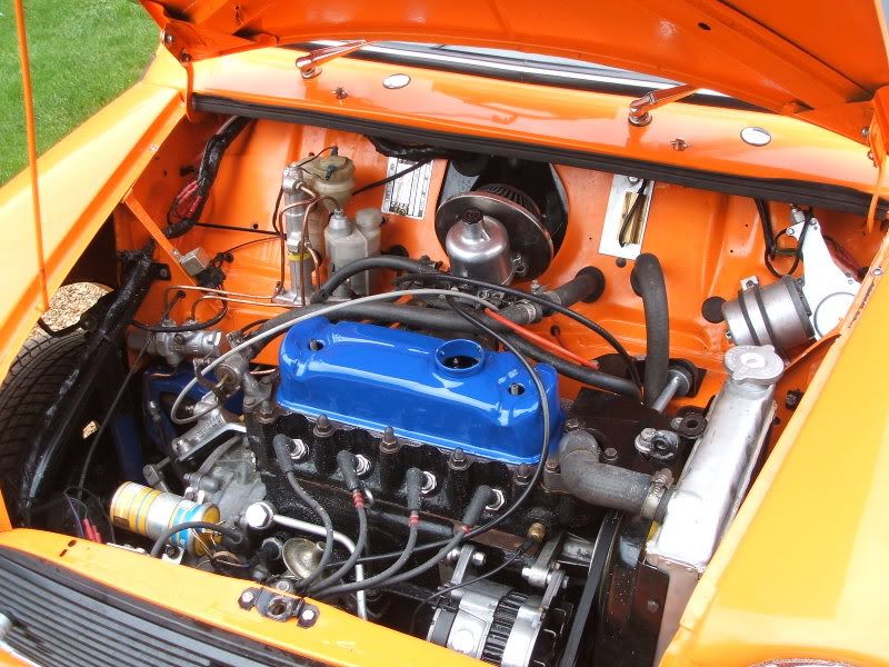

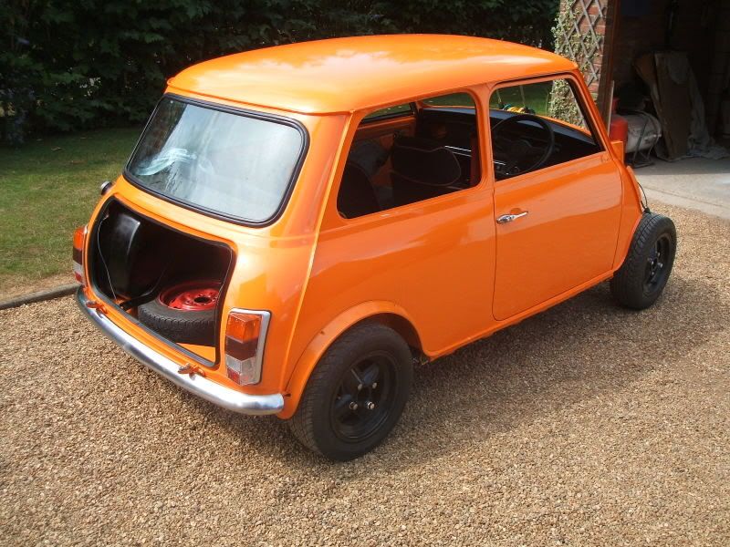

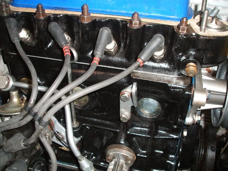

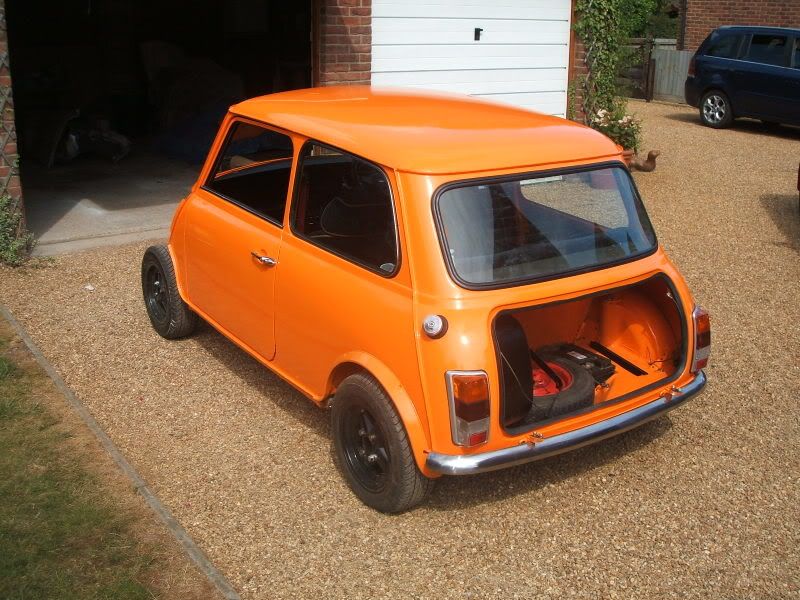

Engine is running well now done 1100 miles, really need to get it booked in to be tuned up.
The spec:
998cc
12g202 ported head
pressed steel rockers

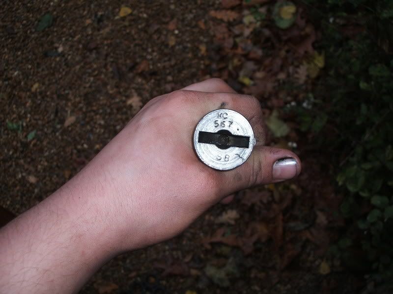

kent 567 cam
minisport inlet manifold
minispares coope freeflow exhaust with rc40 box
Fully rebuilt SU HS4 carb
K+N filter
Aldon 100AYP distributor with lumenition kit fitted (standard lucas coil)

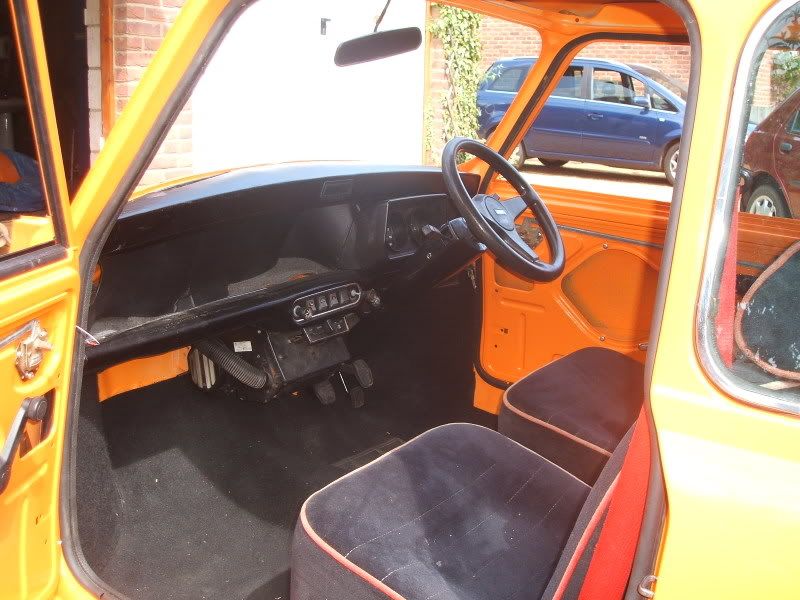

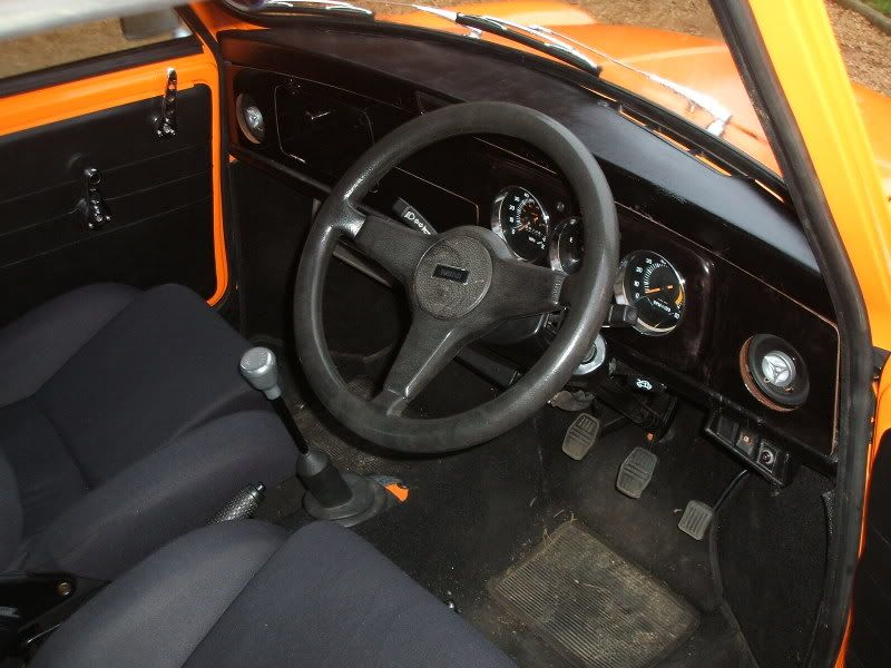

New seats
New charcoal dash

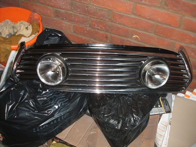

New grille and lamps
New head lamp surrounds

Posted 05 March 2007 - 11:10 AM

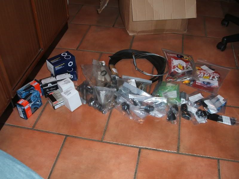

Had a few teething probmlems at first but these were soon rectifided with some more new shiny parts
Also had to fit a new alternator after it burnt out 3 coils

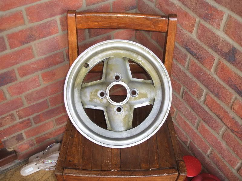

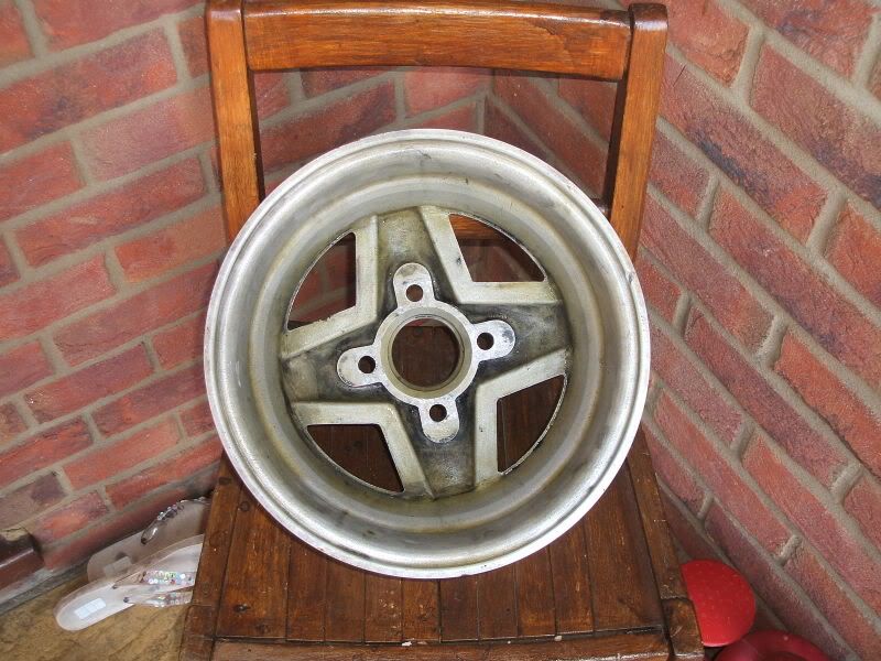

Decide to refurb the wheels
Thats two done, just need to polish the rims up. Also had some new a539s fitted whilst they were off the car
