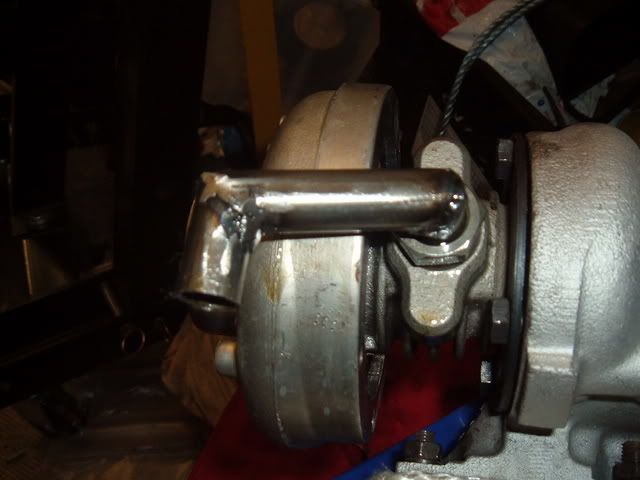

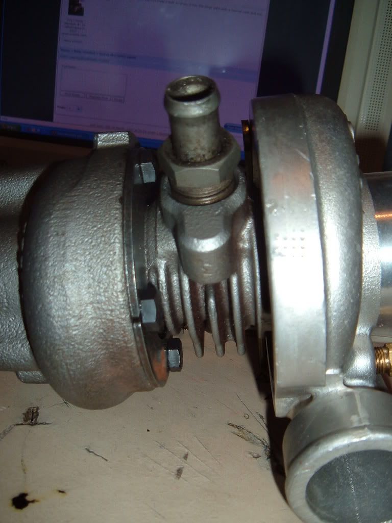

here's a pic of my oil return for you mike, its not the prettiest but it does the job. points it back into the oil drain hole on the back of the block.
Had a poo day today aswell, after getting the engine all back together and running fine. i went to get changed out of me oily's so i could go for a test drive, came back to the car with a big puddle of oil under it. not impressed.
turbo oil feed was leaking like a *Female doggy*, turns out the banjo bolt is threaded. So now i'm running the car n/a with an old lcb on it, its :( slow and loud and i hate it, lol. gotta wait untill i can get hold of a 7/16" x 24 tpi banjo bolt for the T2 oil feed, gotta love garret for using a common thread size (not!)

i tried a plumbers fitting for size for the oil drain on the T2 and the closest i found was 3/4" tapered BSP but that still didnt feel right. i tell u this is the hardest part of my project so far lol. im sure there is a special fitting for it but finding it seems to be so hard. i have also tried mirage but to no avail. Richard did say he is trying to find something they can produce/supply. hopefully that will be sooner rather than later. would u be able to knock me a bracket up at a price bud? by the way thanks for the pics!

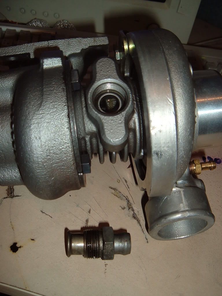

i know it doesn't help but here's a pic of the std fitting i got with the the turbo. i'm pretty sure its not a tapered thread though.
as for making a bracket i dont think it would be possible really as you need to make it up on the car as you go along. thats the trouble with turbo conversions, no 2 are the same unfortunately.

it got slightly modified dude, cut the end off and welded bits of pipe to it to create my oil return, lol.

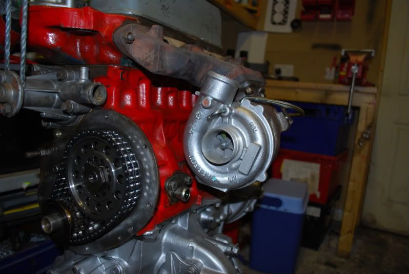

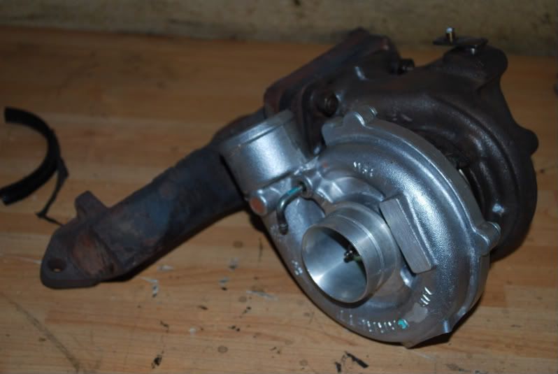

Picked up an ebay bargain the other week, brand new GT series turbo that wil_h recommended me to go for ages ago (cheers for for the advice mate) which will be mounted on my metro manifold. Laser cutting company round the corner from work are also making me a turbine flange and a couple of steel gaskets so i can set about making a new elbow. Was going to go for 2.5" piping but seeing as i still have the gear linkage under the car i'll have to stick with 2" for now.
My engine had been sat in the corner of the garage since 07 so me and kean dragged it onto the bench in the week to pop the bearing caps off and have a look at the shells and they all look perfect which was a nice surprise. Also means i didn't have to remove the crank so haven't had to re-do the cam timing or remove the head (no worries about it possibly being one the current dodgy gaskets thankfully!).

the new Turbo, should be good for over 20psi and be more efficient than my old one.
Getting it mounted on the manifold to start making the oil drain
sits pretty similar to the old T2 just with a different turbine flange so have got to make up another downpipe when my bits from the laser cutter arrive.

Got a bit done so far this weekend, oil drain is made, oil feed pipe is sorted courtesy of Listers Motorsport in West Brom and a bargain at £20.

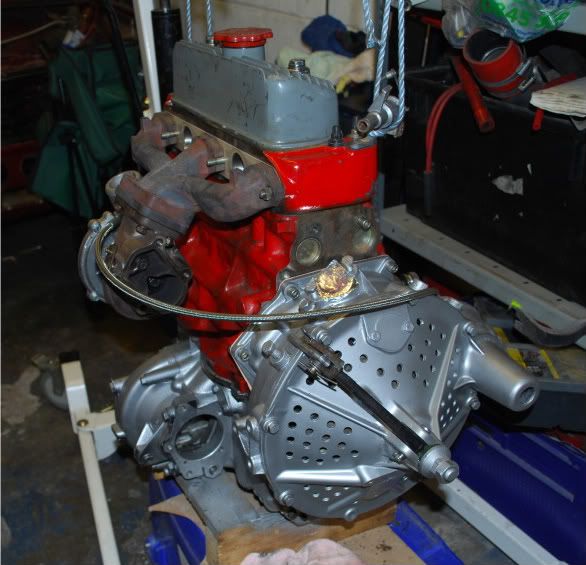

been having another tinker in the garage today and had a helpful visit from Pauly.

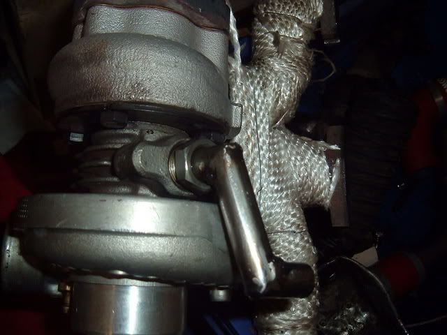

Got the wastegate tag cut and rewelded on the turbo so it points the right way. Took the grinder to my manifold and adapter plate to give me some clearance round the compressor outlet pipe so i can get a silicone hose on there. got the LSD shimmed up and fitted into the case. fitted a new timing chain and got the timing cover etc back on. Plugged up my speedo drive hole as it doesn't get used. Engine bay and subframe have been degreased, might paint the engine bay if i can find an old tin of red on the garage shelf tomorrow.
Not in a rush to drop the engine in yet so will do it one of the nights in the week more than likely.
