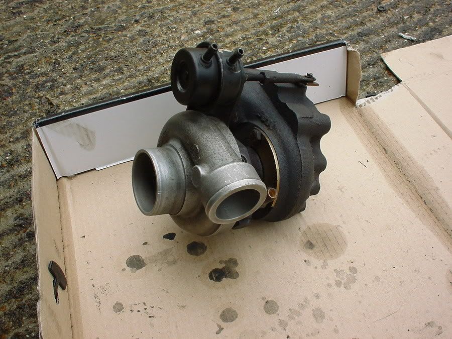

t2 turbo are fitted to renault 5's, people tend to use them on the a-series because they take less force to drive them, this in turn will lead to less turbo lag and a more effecient output.
#21 hammoj28
hammoj28
  • 226 posts
  • Local Club: Scottish Minis
Posted 01 November 2004 - 10:52 AM
Cool, sounds like the one to get.
#22 hammoj28
hammoj28
  • 226 posts
Posted 01 November 2004 - 10:56 AM
Is this the kind of thing??
http://cgi.ebay.co.u...ssPageName=WDVW
#23 clubman_dan
clubman_dan
  • 246 posts
  • Location: Hampshire
Posted 01 November 2004 - 04:27 PM
thats the one mate,
here's a pic of mine.
DAN :lol:
