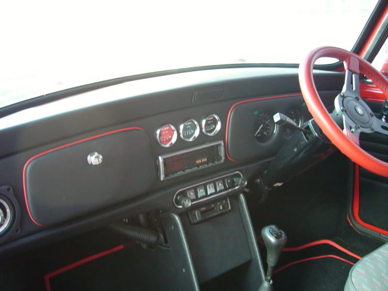

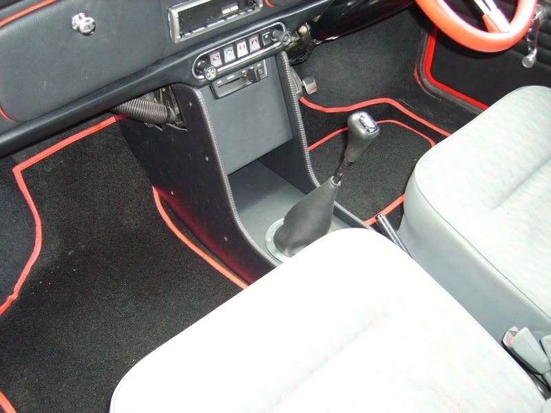

Now first of all it was the interior that was sorted as it was, well, C**p. so everything that was grey was changed to black, minus the headliner because i don't want to fart about with that.

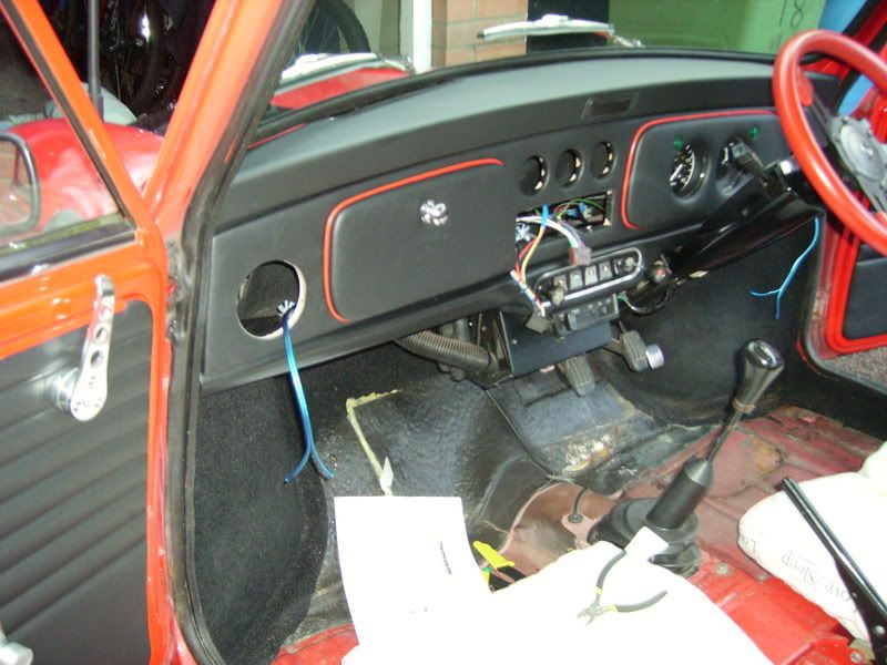

New dashboard was ordered and fitted along with new top and bottom dash rails.
Also new doorcards and handle set
A new center console and floor mats were bought, and the carpet was taken out and put in properly
So thats most of the interior sorted minus front seats and harnesses.

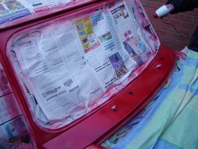

So onto the outside, first of all because my mini is pink, when it should be red!!! we decided to have a quick go at painting the scuttle as it had a wacking great hole in and needed repairing, so would be painted anyway. This was our test panel to get the idea of what it would look like in the original red. So a couple spray cans were bought from halfords and off we went
Seeming as this came out ok, we thought we might as well do the whole car, but not with spray cans, so we ordered some paint, thinners and all the other bits and pieces to go with it and were ready to go, when we decided the engine looked a bit tired and dirty, and it would be a shame to spoil a nice new paint job with a manky old engine under the bonnet.

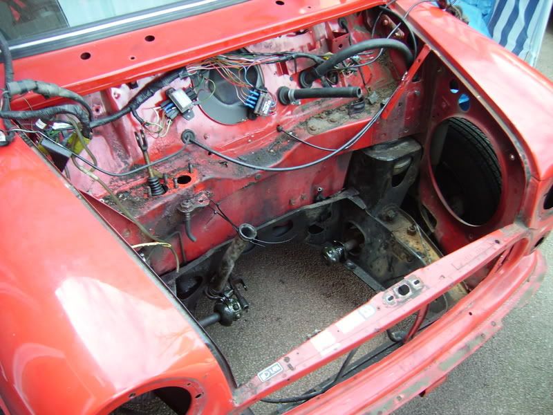

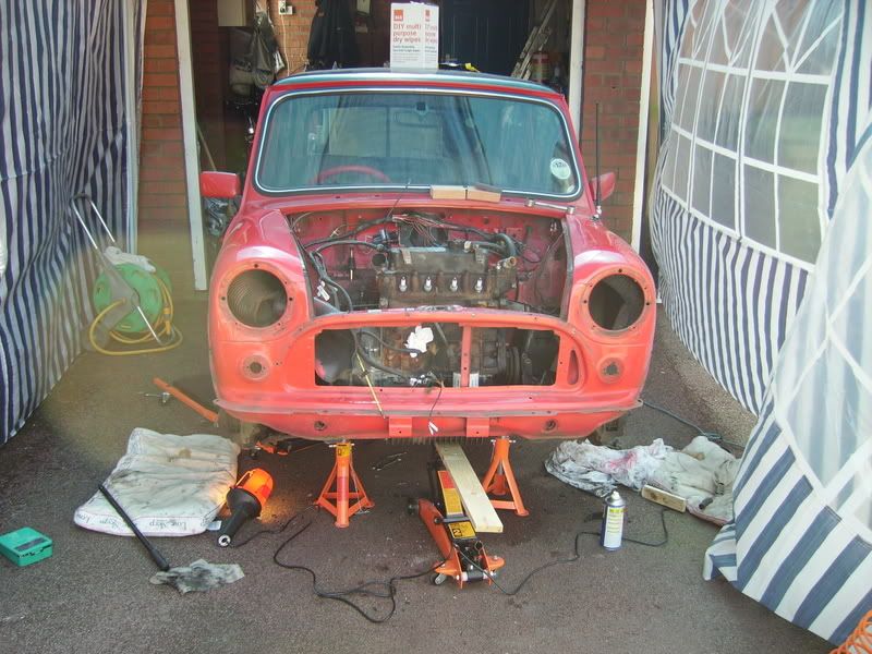

Sooooo.... as easter holidays began we started a new task, remove the engine! The engine was coming out so that;
1. it could be cleaned, painted and fixed
2. we could clean up the engine bay and paint it easier.
at this point in time, the engine has been completely disconnected from the car and is just resting on it's mounts on the subframe waiting for the engine hoist to arrive so we can lift it out.

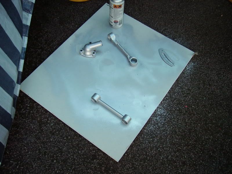

I also got a few engine bits painted up

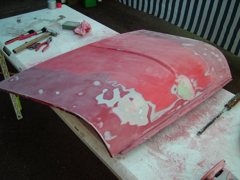

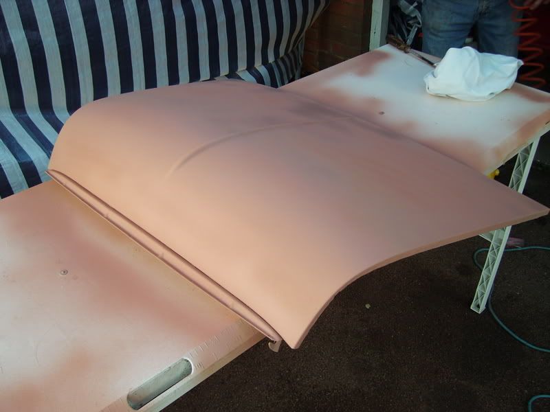

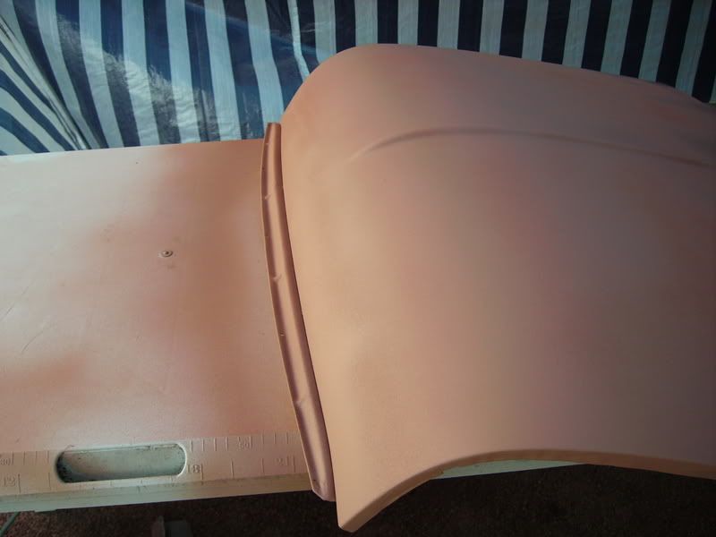

Seeming as there is nothing left to do on the engine until the hoist comes, i thought i'd get on with preparing the bonnet for spraying as this was going to be the first bit we spray as it's off the car and is a fairly simple bit.
When we sanded down the original paint it was clear to see someone before and tried to have a go at painting over the original paint as under the vinyl stripes was a completely different red, and they obviously masked up the stipes and painted around them, also they had made a bodge job of the filler at the front so that was sorted too. Also while we were at it, we filled the holes for the badge and smoothed it over.
It was then primered with 4 coats just to even out the colour difference, and on monday it will be knocked down with 800 wet.

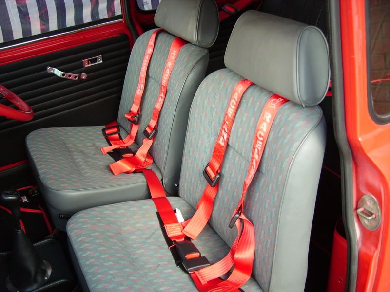

After a trip to stoneleigh, and it happening to be my birthday some more parts rolled in today

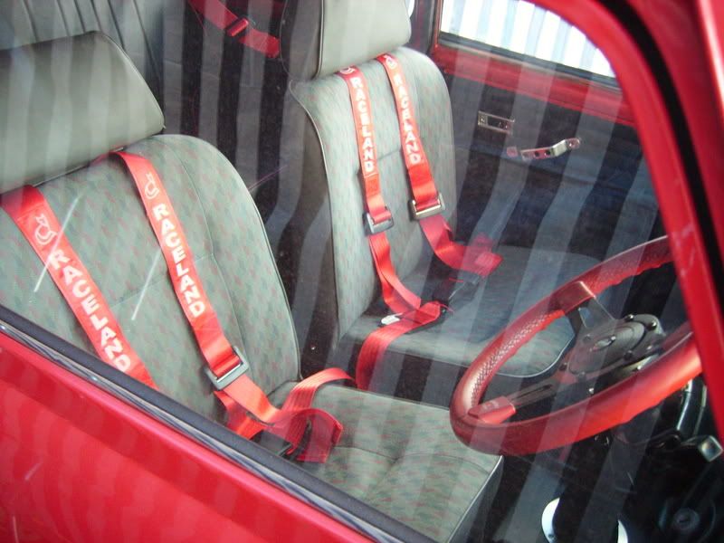

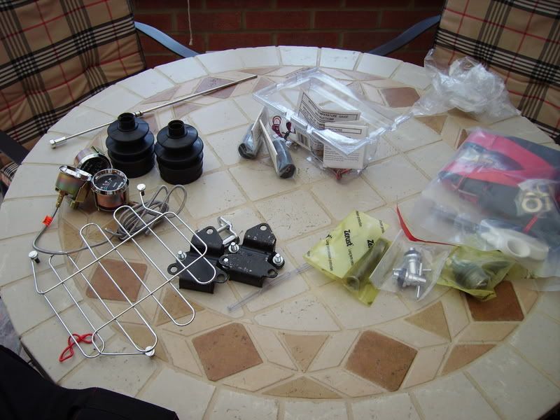

New harnesses, got a bargain here as they were meant to be £50 each i think, but the woman gave me a pair for £50 as she was on the phone and wasn't concentrating, so got a bargain me thinks. Don't look right with standard seats, but i was excited so had to put them in before i got my new seats

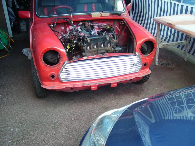

And the front grille was mocked up with the buttons

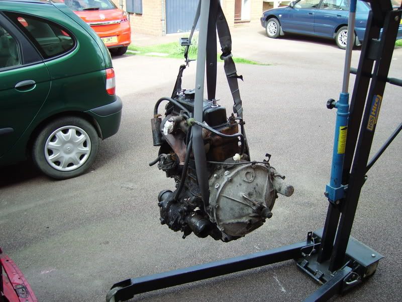

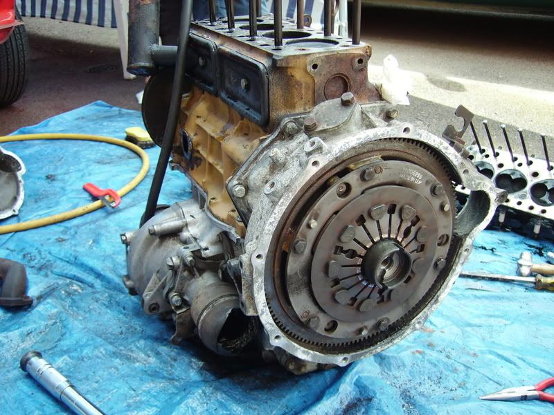

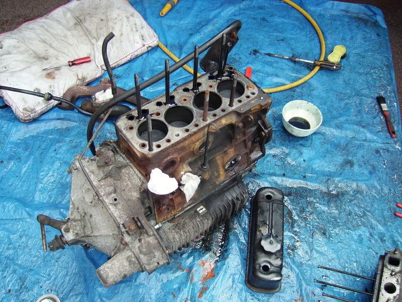

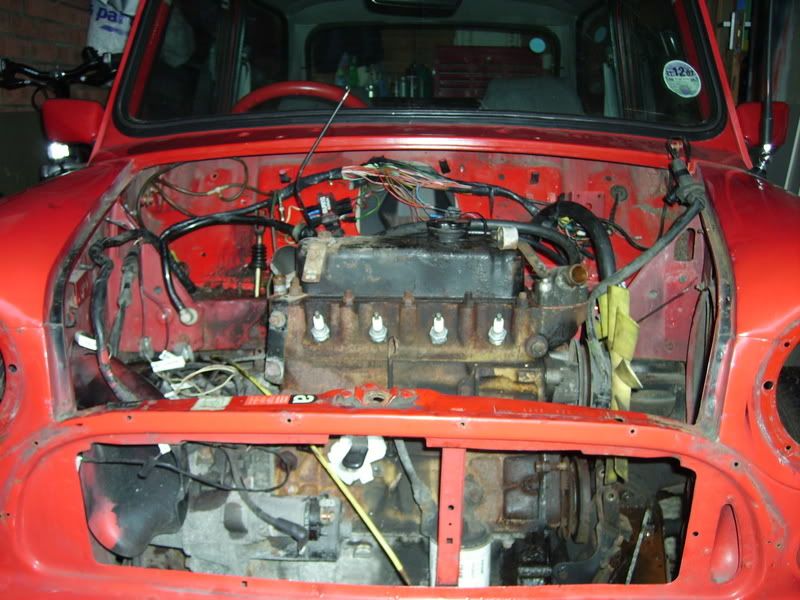

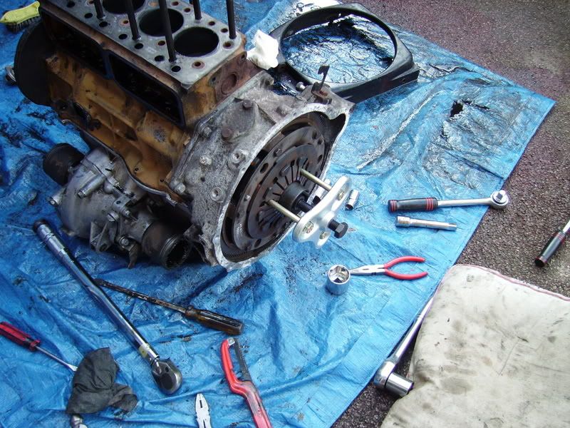

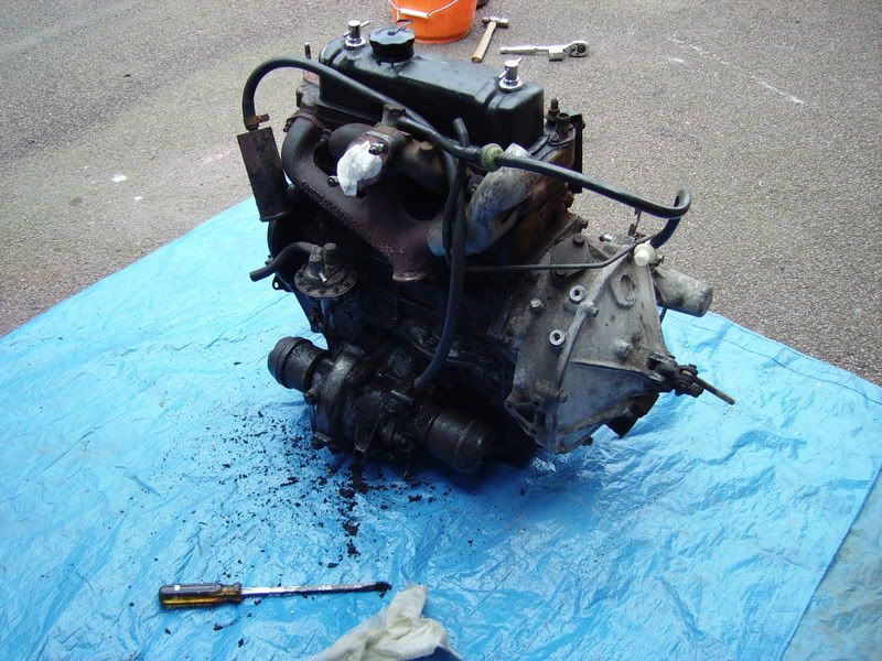

Got a fair bit done today, seeming as the engine hoist turned up.
First of all it was engine out (obviously). I don't think i'll be using those seatbelts again, apart from when the engine goes back in. :P

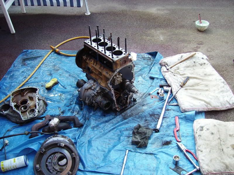

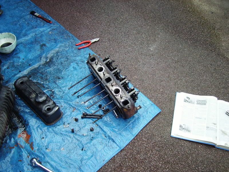

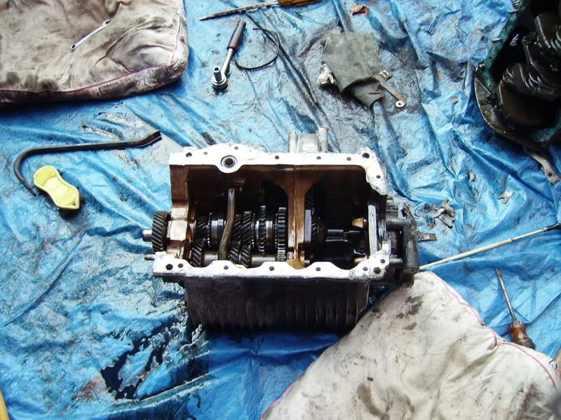

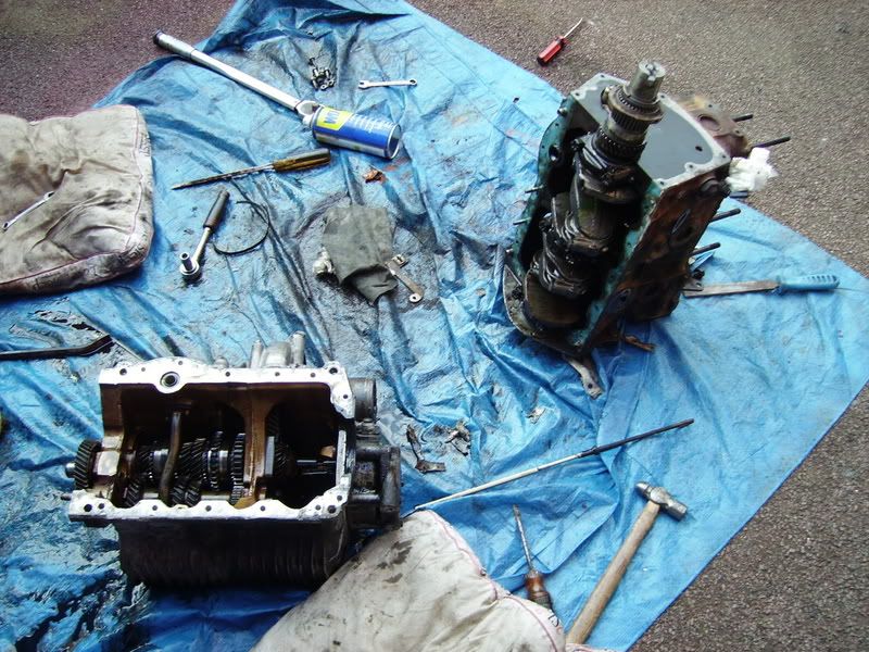

After that we split the head off to get a look at the bores, pistons and valves and everything is in really good condition.

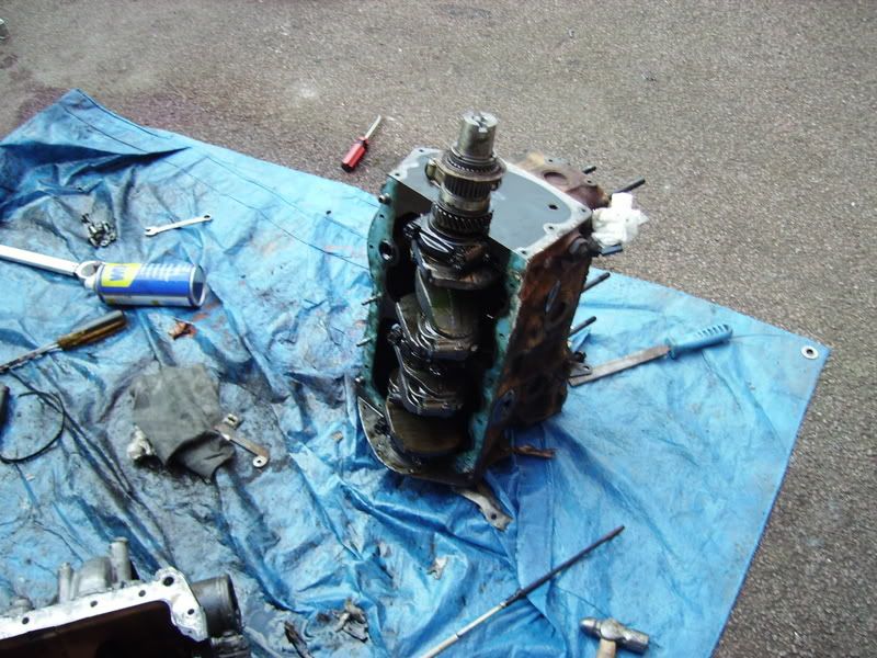

Next it was on to the clutch and flywheel. got the housing off and then had to go and buy a flywheel puller (£20!!) to get the flywheel off. We're going to replace the clutch while it's out as i think it's a bit knackered and it judders everynow and again. The flywheel came off pretty easily and then the back of the flywheel housing was removed.
After all that was off the bottom pulley was removed (a ******* of a job) and the timing chain was inspected, and it was in really good nick again, so that can stay in place so we don't have to mess with the timing. Then basically the gearbox and block were split to inspect main bearings and big end bearings. And also check any wear in the gearbox which there was none of.
Now i'm basically waiting for parts to arrive. Head gasket set should be here tomorrow and i need to order a block gasket set. Meanwhile i've started painting up some bits. I gave the head a coat of black earlier and have just done the timing cover. Tomorrow i'll re-coat the head and also paint the main block and other bits that need to be black. Then i need to get some silver paint for the gearbox, flywheel housing and other contrasting bits. Then the fun will begin joining it all back together and putting all the fun bits on.

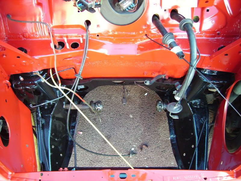

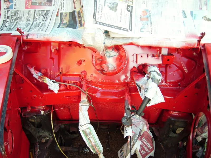

Got the first of the painting done today - the engine bay. Just did this with rattle cans as it would be too awkward to do with a spray gun. Also painted up the subframe.
I think you'll agree the difference from this...
...to this...
...was worth the effort as it will now frame the freshly painted engine.
M

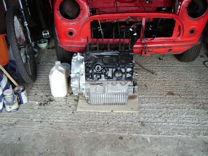

got the block and gearbox re-mated
looks a damn sight better than it did when it came out

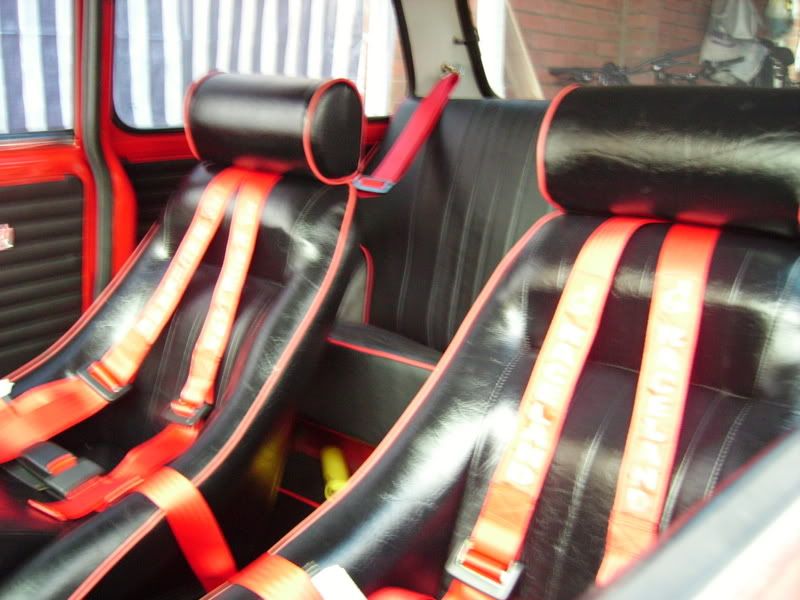

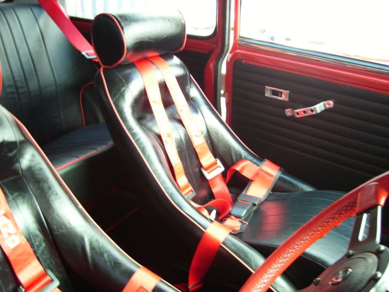

On the interior side we went down to Wilthsire today to pick up some seats.
£110 got me 2 corbeau classics with subframes + headrests in perfect nick, just cleaned em up with some leather/vinyl cleaner and they look as good as new. So really chuffed with them, and they're so comfy, could fall asleep in em.
sorry for dodgy pics but i was in a rush as it started raining hard and there is no bonnet on the car atm.
