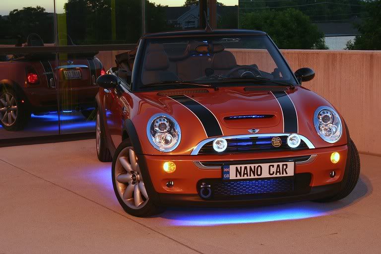

I even went a little nuts and wrapped the blue color to the outside! This is 100% invisible until I decide to switch it on. The exterior is blue LED strips (on the underbody and in the supercharger scoop) and silicone-sealed cathodes (in the front grille):
It's not for everyone, but I think it's fun at the occasional car show or MINI gathering... :P
