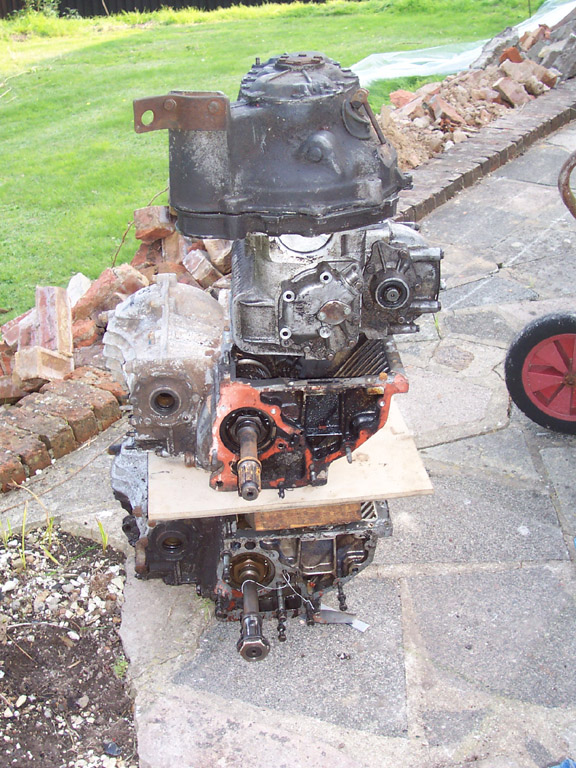

Attached File  20082007118.jpg   850.26K   400 downloadsModified the lower wishbones to create a better angle for the coilovers to sit, its not ideal but thers hardly any weight in the front so should be ok to mount them there. Put in some temperary coilovers just to get the front end up and rolling, had it rolling for the first time today, but was cut short when me engine fell oot!!!........Roll on the V8. Think ive sourced a Austin princess, gonna have a look next week, hopefully its gonna be just the ticket. Got to replace bodywork at the rear now, had to cut it away to for the mcfearson strut towers to sit, but ther gone now. Bracing up the whole rear end and fab up the rear trailing arms, coilovers in the back aswell now.....so glad ive made this choice, after extracting the V6, i cud see just how Heath it twas........luckily 4 years down the line i know a hell of alot more, may even look like a proper job this time!Attached File  20082007126.jpg   698.54K   312 downloads
