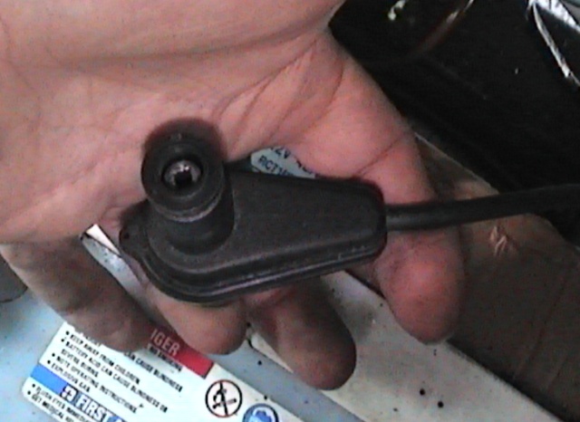

when i can get to it i will look for a part number, and get some pics. might not be until the weekend, but will try on evening this week
it fits on the speedo end of the cable, no thread, has the same type of socket as on original mini speedo.
it also had an extra part with it that i didn't use. this could have gone straight onto the gearbox, but i didnt want the sensor down near the drive shaft and dirt.
i got the gauges and sensor on Ebay, so have no other details on the sensor, just a label where wires go as you have mentioned.
out of all the ones on the site, mine it more like the 67HC

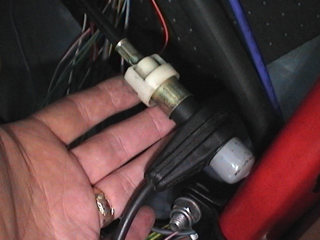

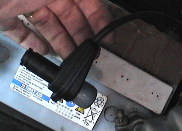

i've had a look at the transducer on my mini, no sign of a part number on it just the name Hunter.
here are a few pics, was in an arkward place, so these are the best i could get.
it did come with some kind of adaptor that i havent used, on the threaded end i've put a cover over, and the later type cable end just clips on like it does on the back of the origional speedo.
like i said earlier, out of all the ones on the site, mine looks more like the 67HC

Well there you go.
If you want to install this on the end of a speedo cable it sounds like you've identified one that's compatible for later Minis. Likewise, in a previous post I pointed out that Sailes had one with M12x1 threads that would go on the earlier speedo cables for center binnacle cars.
I still think doing it this way defeats one purpose of using a programmable electronic speedometer, namely getting rid of the problem prone cable. To each his own.
I have had a friend measure one of the late model, alloy, gearbox-end, speedo fittings. He confirmed that the threads on the gearbox are M19x1. Sailes doesn't have an off the shelf sender that will bolt to that but it sure sounds like they'd make one for you if you're interested.
