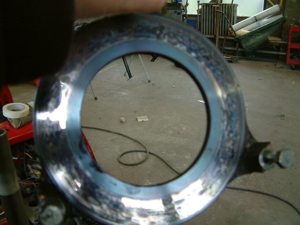

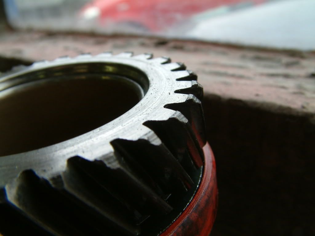

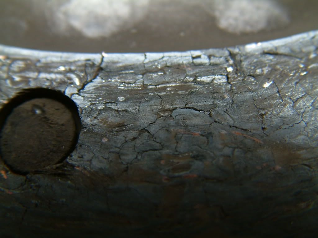

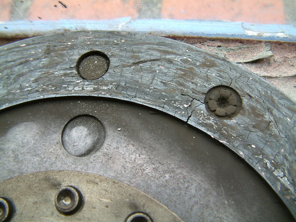

Not been a good day today,
Whilst in the body shop i asked the garage if they would look to find out what a squealing noise was when i pressed ed the clutch, so they did :shifty:
Clutch plate almost all worn off
Which had been making heat which then Got my nice billit steel flywheel and backplate hot and sent it blue
Which in turn caused wear on the bronze washer thing on the end of the transfer gear (which has worn away) causing a lip to be cut into the gear
So thats another load of ££££ needed and possably a re-build :P
Not a happy bunny
