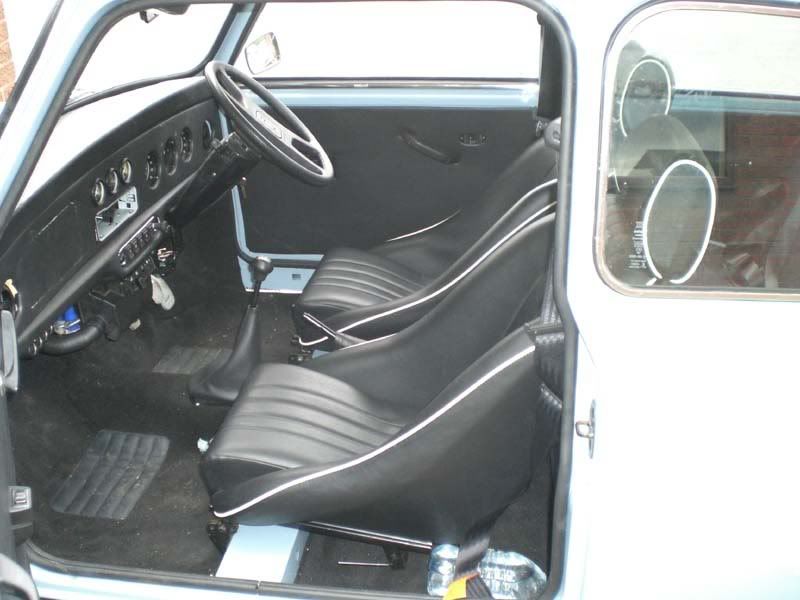

Waddya think!? :xxx:
I managed to get the top dash rail out, this evening :angel: With the windscreen in place :xxx:
Aaaannd... I think the centre clocks will happen some time next week :!:
Pikey's gonna be a legend (again) and do it for me help me :xxx:
Got lots of bits to order tomorrow. Speedo cable, T-piece, pipe for the oil pressure gauge, etc. Mike's got the wiring pretty much sussed, with a lickle cheeky mod to the centre speedo, to make it more useful! :xxx:
AAAANNNDDD...
for the record I'd just like to say that Mike offered to do it, I didn't give him grief!! :genius:
And I know he won't post here, so he can't say any different :angel:
Nuuuuurrrrrrrrrrr :xxx:

Oh I like the beige interior!!
#413 Bean
Bean
  • 8,054 posts
  • Name: Jean
  • Location: Malvern
Posted 07 February 2008 - 11:13 PM
sorry saad, i much prefer this :P

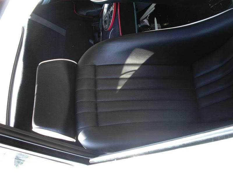

I like the black with cream piping.
But have you thought about Monaco seats? They would be damn smart in the Regmeister too! :shy:
What are Monaco seats like ? :D
Cobra Monaco
or
Cobra Monaco Sport

They're.... interestingly... covered on the base O_O
Sowwi Juju - me no likey :D Not for Reggie, anyway :shy:
#418 *DJH*
*DJH*
  • 4,972 posts
  • Location: East Anglia
Posted 08 February 2008 - 10:25 PM
that's the big copper staples that hold the vynil in place to the frame.
