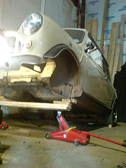

In the meantime...
Pics :P
Oh. and can't remember if I posted this one or not, lol... but just saw it in my photobucket and thought it was quite amusing! :)
:P
