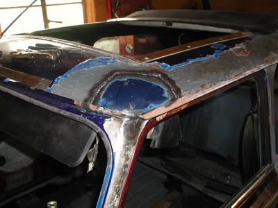

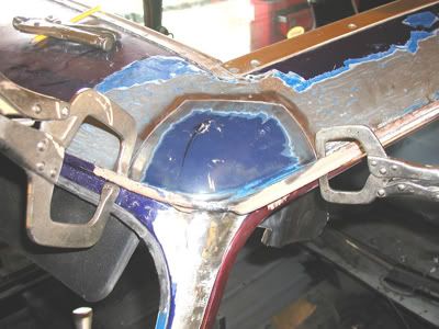

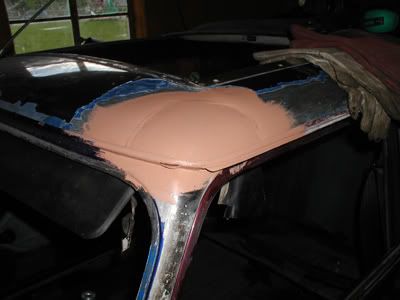

I've had to repair the front corner which had rusted away just like yours.
I got myself a corner section cut from a donor shell, I then separated the panels by using a spot weld drill so that I had a corner piece of roof skin. I cut out the rusted section from the car and then cut the "repair" panel to suit (size for size with the hole in the roof), welded it in place and then put a small skim of filler over the weld bead.
Panelled up:
Welded in:
Primed:
Yours looks pretty bad though! If the gutters dont look too bad I'd really be tempted to drill out the spot welds for the entire roof and buy a whole new panel. Would save loads of grief with patches/filler and would generally be a neater job.
