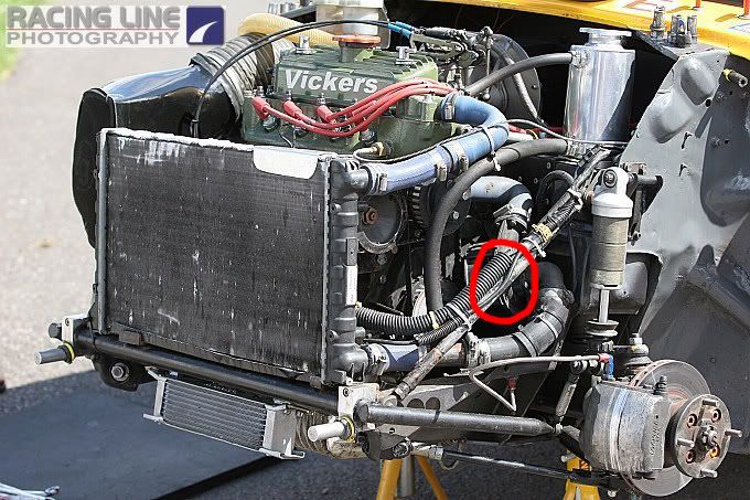

here's a photo from thruxton, and you can see the mecahnical pump is there underneath the pulley.

#23 The Matt
The Matt
  • 17,232 posts
  • Name: Matt
Posted 24 January 2008 - 08:40 PM
I'm sure there's an EWP in there somewhere!
Isn't there? That don't look normal anyway, does it? :unsure:
Take impellor off pump, use it as an idler pulley, fit EWP, carry on racing! ;D

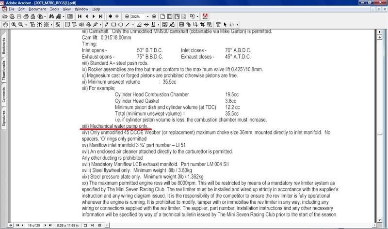

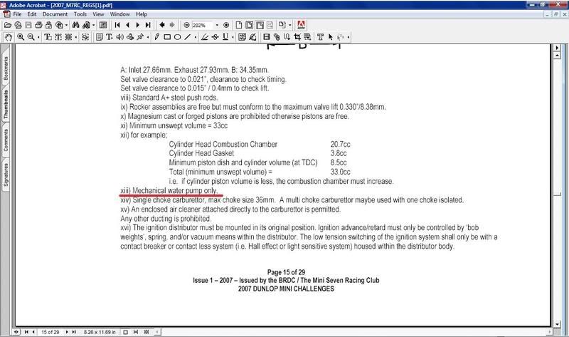

a screen shot from my mini7 technical racing document ;D
That doesn't mean it still has an impeller in it, a lot of people use the original water pump housing as a water inlet. I can't think why you'd still need to run pulleys on it if the pump guts is missing though unless it's something unique to the toothed belt system. I'd still be amazed if the mechanical pump impeller could cope properly with water being pushed past it at high speed because as I said above the pump is capable of overwhelming itself when the small pulley is used.

i know what the differences are Matt. here is another section ;D
