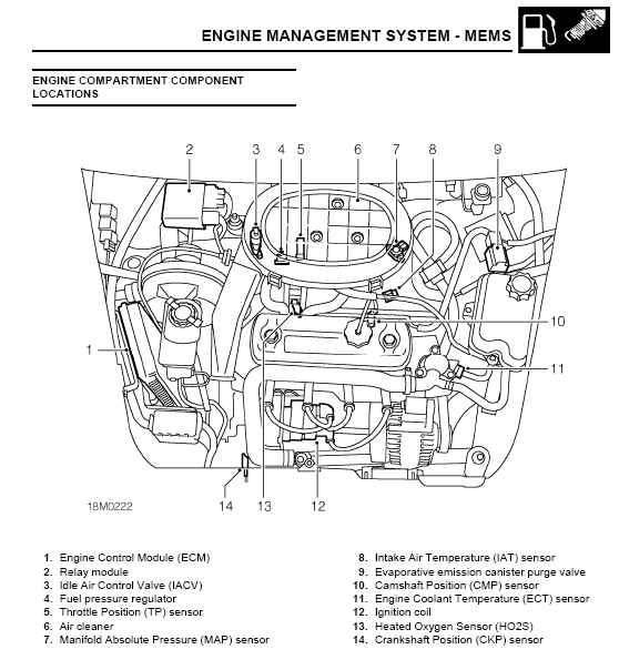

I'd check with Sprocket or some other injection guru, doesn't the injection filter casing include an injection system sensor?
Hmmm. Looks like it does? Is the MAP sensor actually in the casing? >_<
#12 Juju
Juju
  • 3,620 posts
Posted 30 January 2008 - 01:34 PM
Ackchewlee, reading further, the MAP sensor is mounted directly on the inlet manifold & the intake air temp sensor is on the side of he manifold. >_<

Posted 30 January 2008 - 01:35 PM
there shouldnt be a sensor in the casing, its just a casing after all
I had the air temp sensor in mind, the Manifold pressure sensor would be in the manifold surely? - could just be a bit of a misnoma. The idle air control valve could also be an issue, but looking at the piccy I can't really see where it draws fresh air from.
Should be obvious enough when you take the casing off.

Posted 30 January 2008 - 01:42 PM
The air intake hose is under the RH front wing. That's aboot all I can tell you! >_<
