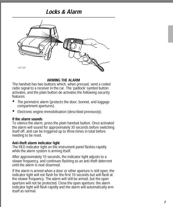

Assuming its the original Rover alarm and not been fiddled with, there should be two buttons on the key fob.
The one with a padlock symbol 'arms' the system. When you press this, the indicators should flash three times and the LED on the dash will flash quickly for about 10 secs whilst its arms itself and will then settle down to a more steady flicker.
To switch the alarm off, you need to press the 'plain' button on the fob, the indicators will flash once and the LED should go off.
The alarm works off simple door/boot/bonnet pin switches and has a built in immobiliser.
If one of the pin switches is open (door not shut properly) when you try and arm it, the LED won't flash so quickly when you arm it to show that something is not closed, but it will arm everything else. If you close the open door, the LED will flash quickly and then arm itself again.
The system is passively operated, so if you take the keys out the ignition and shut all the doors, etc. it will arm itself after about 30 seconds. Just need to press the plain button to disarm. This can be a bit annoying if you're in and out doing any maintenance or cleaning - best to leave the keys in the ignition (as long as no-one can drive off with it whilst your topping up the oil !!), but useful if you forget to arm it......
That's how my MPI alarm works works and it's all original.....!!! (I think my old SPi alarm was different) Hope this helps........

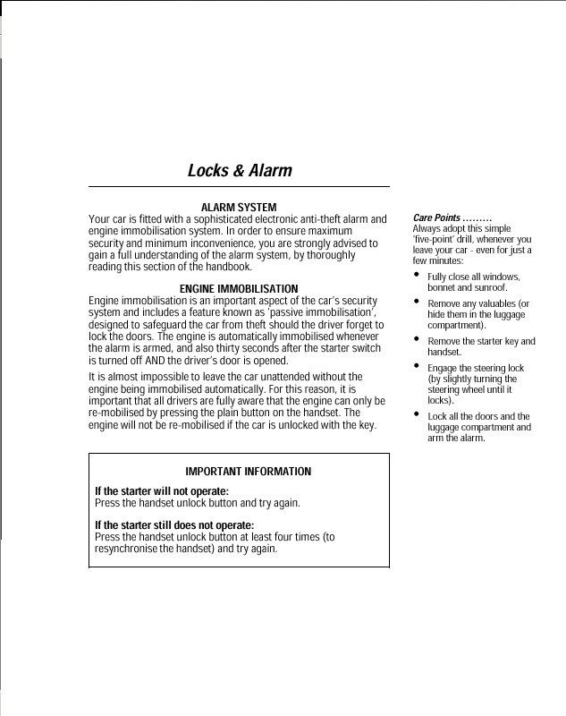

Posted 07 February 2008 - 07:39 AM
the indicators dont flash with the system, the rover ecu is cappable of doing it but for minis it was not programmed to do so.
Mine do! :) Three flashes for immobilised & alarmed, one flash for deactivated. I thought that was standard on the Mpi, but not on the Spi?
Confoosed.
Anyway, Tomsbluemini, I think the computer needs to be fiddled with, or you could try resetting your fob as it says in the manual? >_<

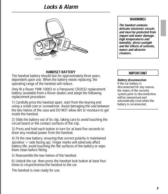

I don't know if resetting the fob would do it, but there's no harm trying....
With the fob pointing towards the car (key end in your hand), press the left button at least four times.
This should resynchronise the system. If that doesn't work then you may have to find someone who can talk to ECUs.... :)

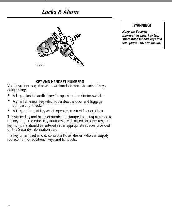

Extracts from the MPi owners manual....think its different to the old SPi system....!!
