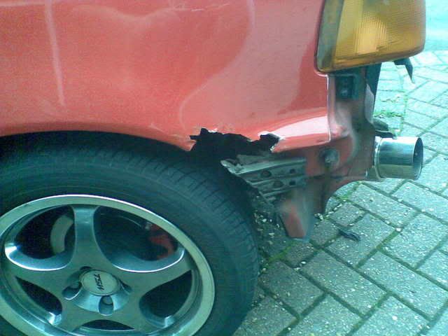

Went and ordered the repair panels last week from the local motor factors which came in the next day so this weekend i've started to sort out the rusty back arches. Main issue was that you can't get pattern rear arches for a crx just a full rear 1/4 from honda which is mega £££'s. I've got hold of a pair of arch repairs for a 3 door civic of the same age because they're a very similar fit, just a different curve where they meet the bumper and need an extra step in them by the sill, but they only cost £20 a side...

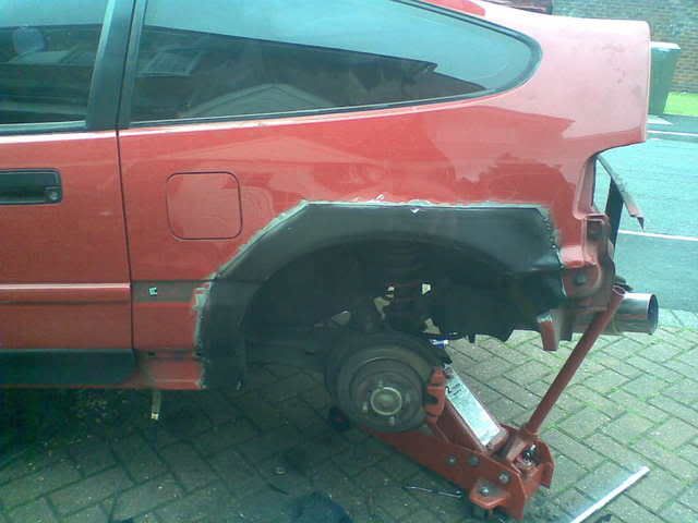

O/S wasn't too bad, even after jabbing with a screwy so i've only used a small section of the panel.

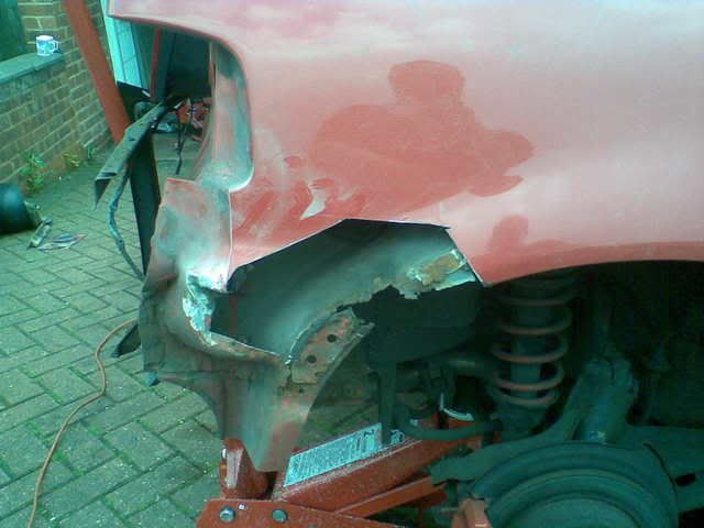

N/S was gone in a few places all the way round so i've chopped the lot out and used the whole panel, had to make up the inner arch aswell because that had gone when i poked at it.
Tacked in place ready to weld up fully
Just in the middle of giving both sides a skim of filler to get them nice and smooth, then its onto paint and hoping i can get a decent match and finish. If not i'll matt black the whole thing i think.
