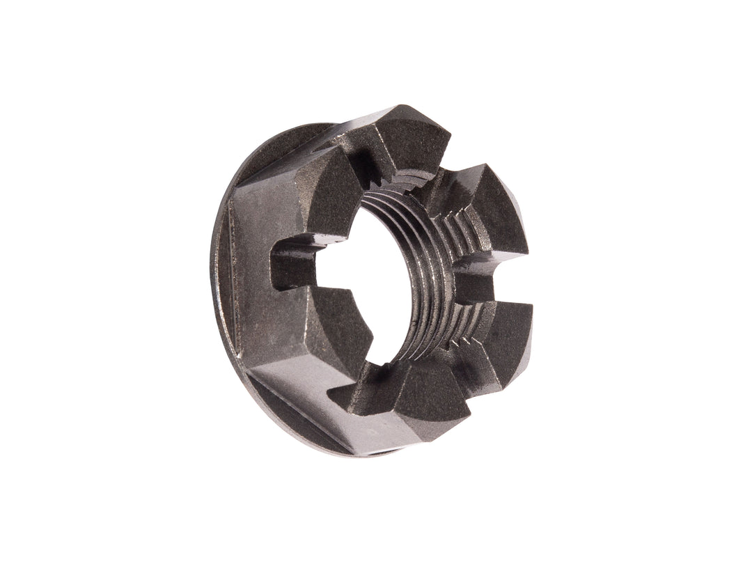

Minispares sell them now BTA249EVO
Shooter
They don't look very substantial.
I tried some MED ones but the quality control was poor, they'd used a blunt cutter to machine the slots so the threads had burrs on them. I ended up sending them back along with some frankly unusable Transtec CV joints. Their attitude was also rubbish.img_5699_1080x1080.jpg?v=1676572873
