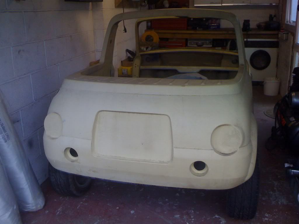

Hi all, just thought some of you might find this interesting. This project started back in January with the purchase of a domino premier plus shell.Attached File  DSC01306.JPG   2.55MB   58 downloads

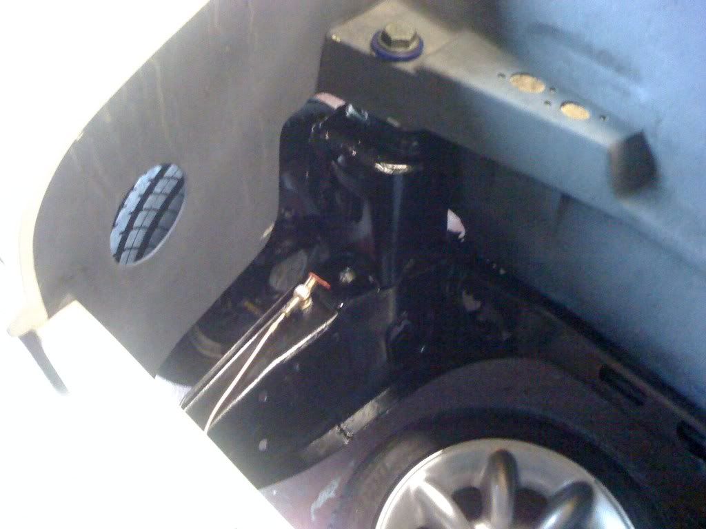

I've not done anything to the shell but i've been busy with all parts for the subframes, all parts have been blasted and i've had the subframes galvanisedAttached File  DSC01609.JPG   2.61MB   64 downloads
All parts have painted.
Attached File  DSC01651.JPG   2.69MB   31 downloads
And this is how far i've got with the help of my mate Si
Attached File  DSC01925.JPG   2.16MB   91 downloads

I am building a 1972 Mini but will be using a Heritage Shell which is due for delivery in October. Meanwhile we are building subframes for both of them. Things have been going nicely recently until this weekend when we started building the first front subframe (Andy's) using all the new bits that we have bought from Mini Spares and Moss. It quickly became apparent that the paint had not "stuck" very well to the galvanise and therefore starting coming off very easily. Further investigation this week found that no matter how well prepared the galvanise surface is, paint will not stick.
So I decided to take a trip around the Inter-Web, searching for topics on painting galvanise. The only results that came back all talked about Powder Coating. It seems that mild steel will last in excess of 50 years if it is galvanised and then powder coated. 50 YEARS!! So the next thing was to find someone who would be able to take on such a challenge, as it is not as simple as just powder coating normal mild steel. HAG Powder Coating in Bristol have stepped up to the challenge and have accepted the job. So they're off to them next week!

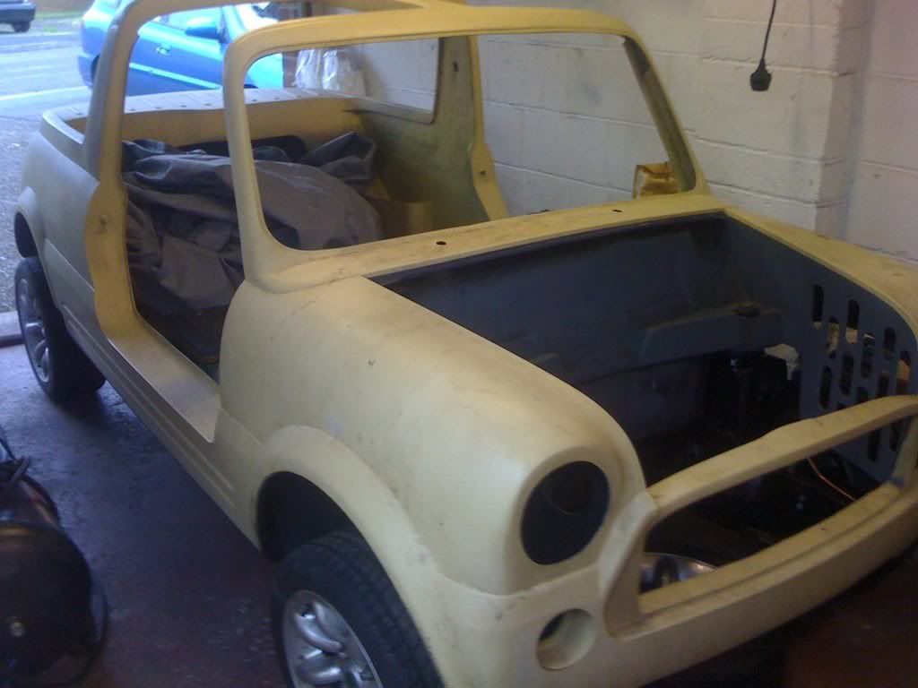

6 months = one rolling Domino.........
oh yes, it's been six months since my mate bazzer and i started the challenging task of rebuilding two Mini's; which hasnt been without it's highs and lows - the swearing, the scuffed knuckles and the damaged ego. we had started with great plans, including fully detailed build plans but as per anything Mini-related nothing worked out to plan.
needless to say, after six months we have two galvanised, powder-coated subframes, completely built up with all the suspension and brake components and fitted into the Domino shell. my mate has taken some pictures to share with all you folks, so here goes......
let us know what you think!!
